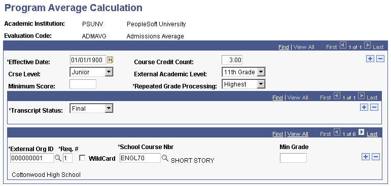

Suppose that one of the criteria with which you evaluate applicants is a grade point average of a select number of classes. You calculate the average and use the average calculation functionality to evaluate applicants and update the application status.
For example, suppose that you evaluate applicants on the grade point average of the following courses:
  1. ENGL70
  2. MATH104
  3. One of the following: ENGL100, ENGL92, or SCNC25
Therefore, use an average based on the grades of only three courses in our Evaluation Calculation process. To calculate the average, enter the first course in the Program Average Calculation page just as in the previous page shot. Then, insert a row in the bottom portion of the page and do as follows:

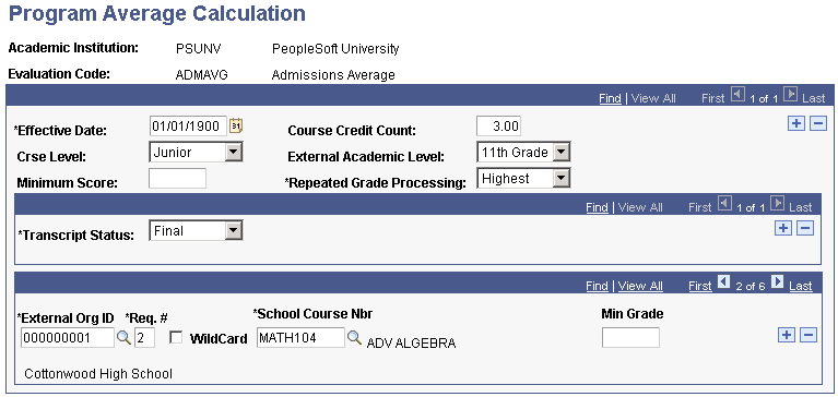

Select your second prerequisite in the School Course Nbr field and change the Req# value to 2. This tells the system to treat this course as a separate course, and to use the grades that the applicant earned in both of these courses in the calculation. Then insert a row as follows:

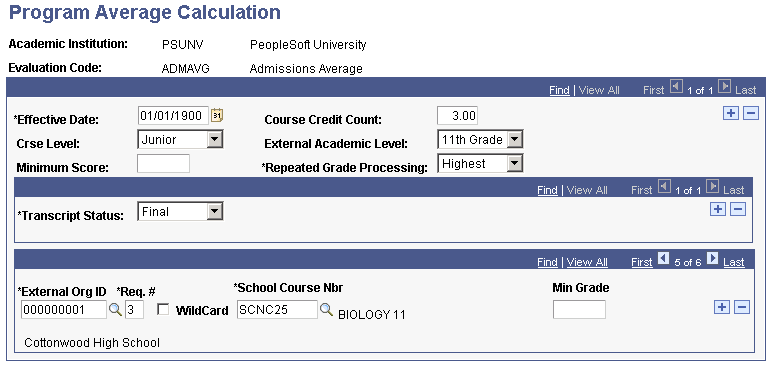

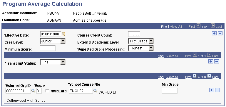

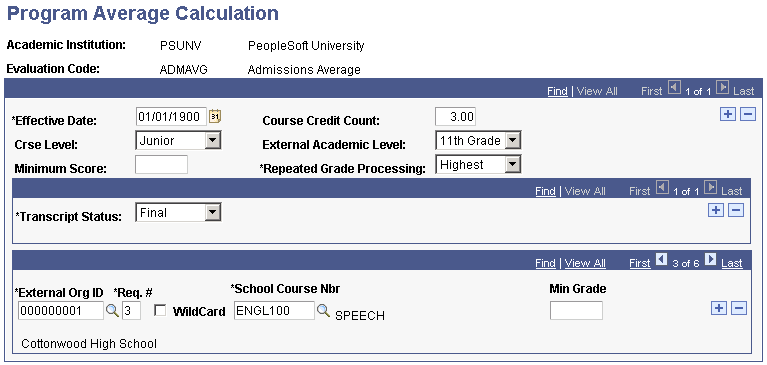

Enter a third course in the School Course Nbr field and change the Req# to 3. Then, insert two more rows and select the remaining two courses, but keep the Req# value the same.

Note in page shot 3 of 4 that Req# is still 3, but you selected a second course.
Image: Example of Program Average Calculation page (4 of 4)
This is an example of Program Average Calculation page (4 of 4).
Note in page shot 4 of 4 that Req# is still 3, but you selected a third course. Because there are three courses with the Req# of 3, the process only uses one of the courses in the calculation. If the applicant took only one of the courses, the system would use that course. If the applicant took more than one of these courses, the system treats the courses as repeated and selects a class to use in the calculation process based on the option selected in the Repeated Grade Processing field.
The system averages the scores of ENGL70 and MATH104, and the Highest of ENGL100, ENGL92, and SCNC25. From here, go to the Evaluation Calculation page to run the process and then to the Overall Rating page to view the result in the Rating Value field.

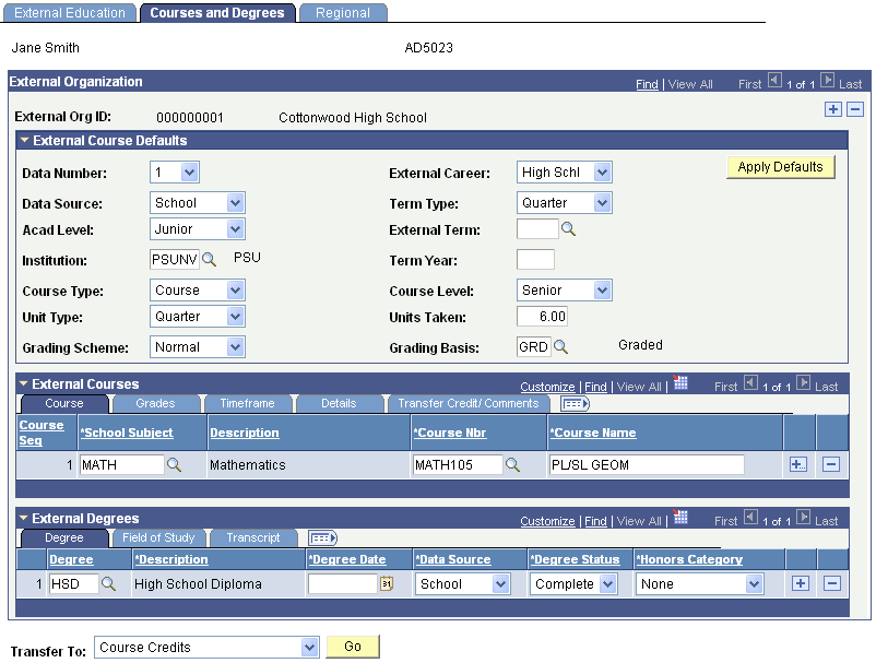

The courses that you select on the Program Average Calculation page are assigned to the student on the Courses and Degrees page. The calculation process looks at the Courses and Degrees page for each student to determine which courses to use in the calculation.
The following example represents an external course for an applicant.
select Student Recruiting, then select Maintain Prospects, then select Academic Information, then select Education, then select Courses and Degrees orselect Student Admissions, then select Application Entry, then select Academic Information, then select Education, then select Courses and Degrees
Image: Example of Courses and Degrees page
This image illustrates an example of Courses and Degrees page.
For this course to be included in the average calculation, the Course Nbr (course number) field on the Courses and Degrees page: Course tab must correspond with the School Course Nbr (school course number) field on the Program Average Calculation page. If you choose a course level and external academic level on the Program Average Calculation page, the process compares that to the Course Level field and Acad Level (academic level) field on Courses and Degrees page: Details tab. If there is a match, then this course is included in the average calculation. The SQL goes down each course on the applicant's record to look for a match based on the criteria that you set up.
The system uses the translated value in the field to the right of the Grd In/Official (grade in/official) field for the average calculation. The average calculation only runs for numeric grades. The average calculation converts non-numeric grades into numeric grades to be used in the average.
