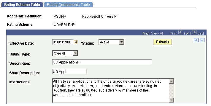

Rating Scheme Table
RATING_SCHEM_TABLE
select Set Up SACR, then select Product Related, then select Recruiting and Admissions, then select Application Evaluation, then select Rating Tables, then select Rating Scheme Table
Define rating schemes. The admissions evaluation process uses rating schemes to evaluate applicants. For example, you could have one rating scheme for undergraduate applicants and another for undergraduate engineering applicants. Rating schemes can be defined for manual and automatic evaluations.

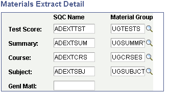

Materials Extract Detail
RATING_SCHEME_SP
Click the Extracts button on the Rating Scheme Table page.
Enter the SQCs for your material extracts.

Access the Rating Scheme Table page (select Set Up SACR, then select Product Related, then select Recruiting and Admissions, then select Application Evaluation, then select Rating Tables, then select Rating Scheme Table).
Image: Rating Scheme Table page
This example illustrates the fields and controls on the Rating Scheme Table page. You can find definitions for the fields and controls later on this page.
Field or Control
Definition
Rating Type
Select a rating type for this scheme. Values for this field are delivered with your system as translate values. You can modify these translate values. Values are Application, Audition, Committee, Interview, Overall,and Portfolio.
Note: If you plan to evaluate applicants using automated processes, you must define a rating scheme with an Overall rating type.

Access the Materials Extract Detail page (Click the Extracts button on the Rating Scheme Table page).
Image: Material Extract Detail page
This example illustrates the fields and controls on the Material Extract Detail page. You can find definitions for the fields and controls later on this page.
Test scores, academic summaries, course/subject information, and general materials are linked to a person. When you evaluate applicants, you might want to consider only certain materials for a particular evaluation, rather than considering all materials for the person. Within Recruiting and Admissions you can manually associate the appropriate application materials to an application (on the Application Materials page), or you can associate application materials to applications using the Application Materials Extract process. To associate materials to an application using the application materials extract process, you use SQCs to define which information to extract and use in your evaluation process. Use the Materials Extract Detail page to enter the name of the SQCs that extract appropriate material information (at the person level) for evaluating applicants.
Enter the SQCs that you want to be executed by the SQR that your institution has defined to retrieve test scores, summaries, courses, subjects and general materials. PeopleSoft delivers the example SQCs shown on the previous page shot but you will need to create your own SQCs to meet your specific business process needs.
For each SQC, except general materials, select the appropriate material group from which you will extract data. Material groups are made up of material types. The information you extract can later be viewed on the Application Materials Summary pages.
See Pages Used to View Summary Application Materials Information.
Note: You can use the application materials extract process to associate transcript information to an application. To associate transcript information to an application, use the Materials Extract Detail page to enter the SQC name for summary information, which contains the transcript information. Alternatively, you can manually associate transcript information to an application on the Application Materials page.

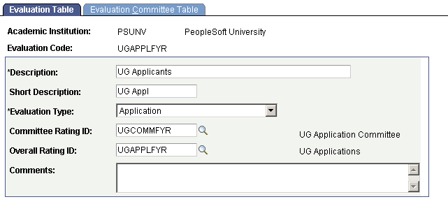

Access the Evaluation Table page (select Set Up SACR, then select Product Related, then select Recruiting and Admissions, then select Application Evaluation, then select Evaluation Tables, then select Evaluation Table).
Image: Evaluation Table page
This example illustrates the fields and controls on the Evaluation Table page. You can find definitions for the fields and controls later on this page.
Field or Control
Definition
Evaluation Type
Select an evaluation type for this evaluation code. You can define evaluation codes that can be used for evaluating applicants (Application), or you can define evaluation codes that can be used for evaluating individuals (General). In the latter case, the evaluation code will be assigned to a person, rather than an application. Values for this field are delivered with your system as translate values. You can modify these translate values. Values are Application and General.
Committee Rating ID
If committees perform this evaluation, enter the rating scheme that the committee will use with this evaluation code. You assign actual committees to this evaluation code on the next page in this component. Define rating schemes on the Rating Scheme Table page.
Overall Rating ID
Assign an overall rating scheme if you use this rating code for overall evaluations.

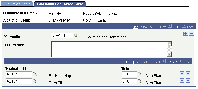

Access the Evaluation Committee Table page (select Set Up SACR, then select Product Related, then select Recruiting and Admissions, then select Application Evaluation, then select Evaluation Tables, then select Evaluation Committee Table).
Image: Evaluation Committee Table page
This example illustrates the fields and controls on the Evaluation Committee Table page. You can find definitions for the fields and controls later on this page.
Field or Control
Definition
Committee
Enter a committee to be assigned to this evaluation code. You can add more than one committee for an evaluation code. Define committees and committee members on the Committee page in PeopleSoft Campus Community.
Evaluator ID
Enter the evaluators who sit on this committee. All members of this committee automatically appear as evaluators, along with their role on the committee. You can add evaluators who are not already assigned to this committee.
Role
Enter evaluator roles for the evaluators that you add. Roles for committee members appear from the Committee Members page.
