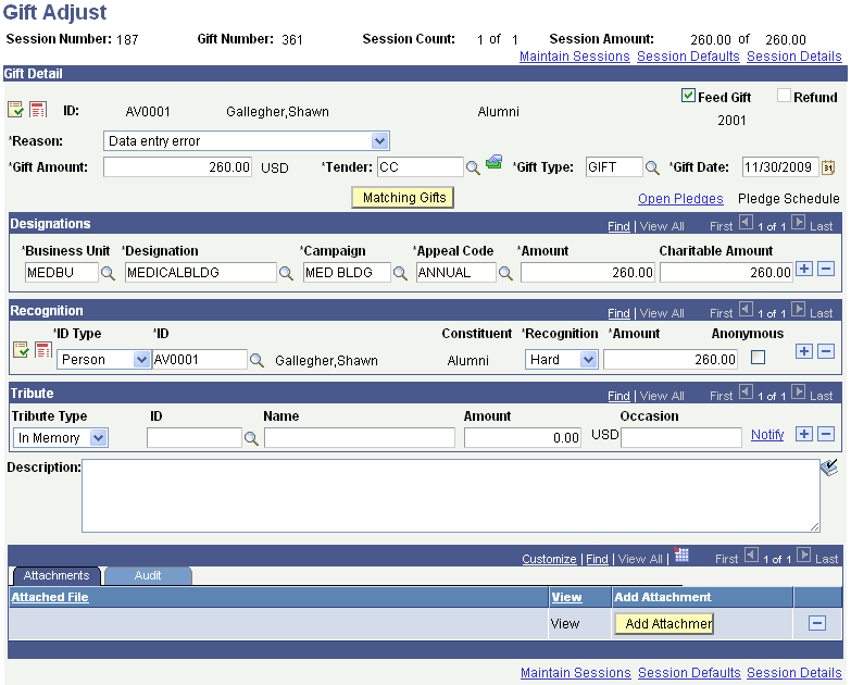

Image: Gift Adjust page
This example illustrates the fields and controls on the Gift Adjust page. You can find definitions for the fields and controls later on this page.
Gift Adjust page
Important! Adjusted transactions negate the original transaction and create a new transaction record, so enter adjustment amounts just as you would if entering the original transaction.

  1. Select a Reason for the adjustment.
  2. Make other adjustments to the page as necessary.
  3. Click the Matching Gifts button.
    The Matching Gifts page appears.
