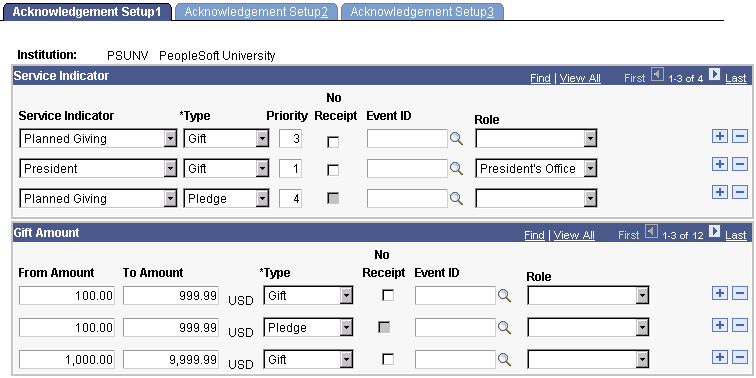

Access the Acknowledgement Setup1 page (select Set Up SACR, then select Product Related, then select Contributor Relations, then select Session Management, then select Acknowledgement Setup, then select Acknowledgement Setup1).
Image: Acknowledgement Setup1 page
This example illustrates the fields and controls on the Acknowledgement Setup1 page. You can find definitions for the fields and controls later on this page.
The system looks at service indicators set on this page for both people and organizations when generating acknowledgements.
Service Indicator
Field or Control
Definition
Service Indicator and Type
Select a service indicator and an acknowledgement type. For example, you can select Major Donor and Gift from the fields to set up rules for acknowledging major donors' gifts.
Priority
Enter a service indicator priority. The value you enter determines the priority used to select which acknowledgement a donor receives. For example, say you indicate President as priority 1 and Planned Giving as priority 2. If a donor is both in the president's club and a planned giving donor and these service indicators are attached to the donor's record, the letter defined for President is the one the donor receives.
Gift Amount
Field or Control
Definition
From Amount, To Amount, and Type
Enter an amount range and a commitment type. The amounts you enter define the monetary range for which to set up acknowledgement rules, and the commitment type indicates whether the rules apply to gifts or pledges.

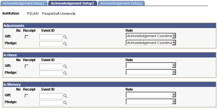

Access the Acknowledgement Setup2 page (select Set Up SACR, then select Product Related, then select Contributor Relations, then select Session Management, then select Acknowledgement Setup, then select Acknowledgement Setup2).
Image: Acknowledgement Setup2 page
This example illustrates the fields and controls on the Acknowledgement Setup2 page. You can find definitions for the fields and controls later on this page.
If you select the Adjusted Pledge or Adjusted Gift check box on the Institution Installation 2 page and you do not specify any values in the Adjustments group box, then the system displays an error message when you attempt to save the page. If you receive this error, you must enter an event ID or role in the Adjustments group box to save successfully.
