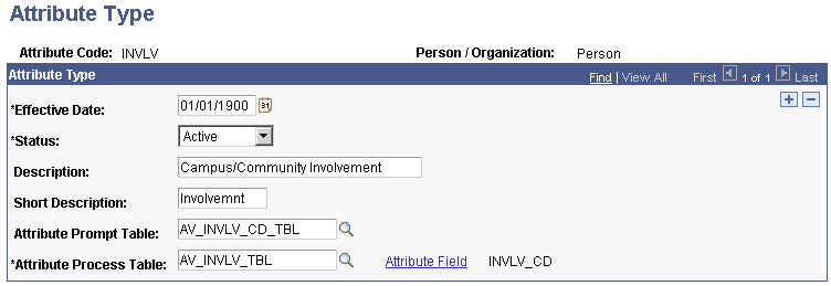

Access the Attribute Type page (select Set Up SACR, then select Product Related, then select Contributor Relations, then select Initiatives, then select Attribute Type).
Image: Attribute Type page
This example illustrates the fields and controls on the Attribute Type page. You can find definitions for the fields and controls later on this page.
Attribute Type page
An attribute type is a characteristic that you can use to identify someone to communicate with in the system for an initiative or member organization.

Attribute Prompt Table
Enter a table or view name, which the system uses to populate the options in the Valid Value field on the Audience Criteria page. If you leave this field blank, the Valid Value field becomes a free-form field, and you can enter any value. However, you won't know if the value that you enter is valid until you run the process.
You might not want to use a prompt table that does not have a setup page associated with it, such as POSTAL_CODE or CLASS_YEAR. System performance improves if you add the free-form value rather than prompting against a large table.
Attribute Process Table
Enter a table name. This table contains the attribute that appears on the constituent's record.
Warning! If you are defining an attribute for a person, the EMPLID field must exist in the Attribute Process table. If you are defining an attribute for an organization, the EXT_ORG_ID field must exist in the Attribute Process table.
Field or Control
Definition
Attribute Field
Click this link to select the actual field in the process table where the attribute resides on a constituent's record.
The system supports these types and lengths of fields for attribute types:
Type
Maximum Field Length
Character
15
Number
10
Signed Number (decimal fields)
12.2
Date
10
The system searches for the attribute that you selected in the locations that you entered in the previous fields. The system generates an actual audience through the Initiative Audience Build COBOL process (AVPINT), which retrieves the attributes that you select. You can access the Initiative Audience Build page to run this process.

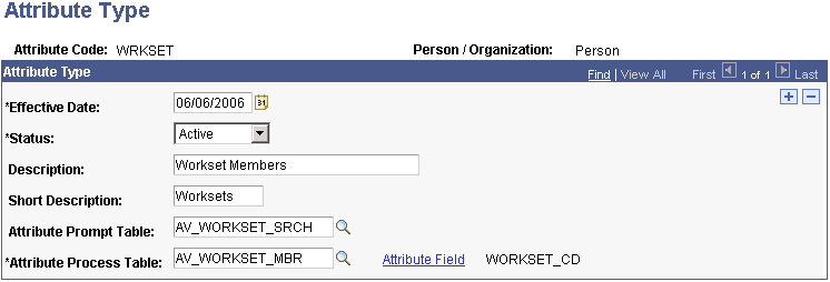

Another way to maximize audience attributes is to create worksets and use the AV_WORKSET_MBR record as the process table to select members into an audience.
Image: Selecting workset members into an audience
This example illustrates the fields and controls on the Selecting workset members into an audience. You can find definitions for the fields and controls later on this page.

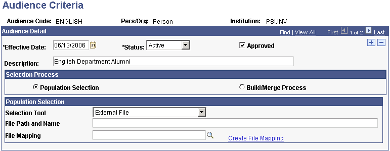

Access the Audience Criteria page (select Set Up SACR, then select Product Related, then select Contributor Relations, then select Initiatives, then select Audience Criteria). The appearance of this page changes, depending on the audience Selection Process you use.
Image: Audience Criteria page using the Build/Merge process
This example illustrates the fields and controls on the Audience Criteria page using the Build/Merge process. You can find definitions for the fields and controls later on this page.
Image: Audience Criteria page using the Population Selection process
This example illustrates the fields and controls on the Audience Criteria page using the Population Selection process. You can find definitions for the fields and controls later on this page.
Audience Detail Common Fields
Field or Control
Definition
Approved
Select to indicate that the audience criteria is approved for use. Select only if you have completed the test search (by clicking the Test Search button) and are sure that you entered the selection criteria correctly.
Important! The audience that you define appears as an Audience option when assigning an audience to an initiative or member organization, if you selected the Approved check box.
Description
Enter a descriptive name for the audience. You can enter up to 60 characters in this field. This is a required field.
Selection Process
When you add a new audience criteria using the Audience Criteria search page, your selection process options here depend on the value you enter in the Person/Organization field. If you select Person or Organization in that field, you can select either the Build/Merge Process or Population Selection on this page. If you select Both, you must use the Population Selection process.
Select this option to use flexible methods to load audience data into the system. This group box appears when the Population Selection process is selected.
Population selection is a method for selecting the IDs to process for a specific transaction. The Population Selection group box is a standard group box that appears on run control pages when the Population Selection process is available or required for the transaction. Selection tools are available based on the selection tools that your institution selected in the setup of the Population Selection process for the application process and on your user security. Fields in the group box appear based on the selection tool that you select. The fields behave the same way from within the group box on all run control pages and application processes.
If your institution uses a specific delivered selection tool (PS Query, Equation Engine equation, or external file) to identify IDs for a specific transaction, you must use it.
Warning! Any query you select for audience criteria cannot contain prompts.
See Using the Population Selection Process
