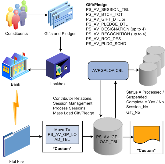

The Mass Load Gift/Pledge COBOL process (AVPGPLOA) takes all the information placed in the AV_GP_LOAD_TBL and moves it into the appropriate tables in the system. Gifts or pledges to be loaded can contain up to four designation records and four recognition records. You can also load credit card gifts through the mass load process.
Because of the many variances between financial institutions and their databases, Campus Solutions does not deliver an API to populate the AV_GP_LOAD_TBL. The following diagram shows how the program might be incorporated into a lockbox process and which parts of that process are created and customized by your institution:
Image: How GP Load might fit into a lockbox process at your institution
This graphic illustrates an example of how GP Load might fit into a lockbox process at your institution:
How GP Load (gift/pledge) might fit into a lockbox process at your institution
