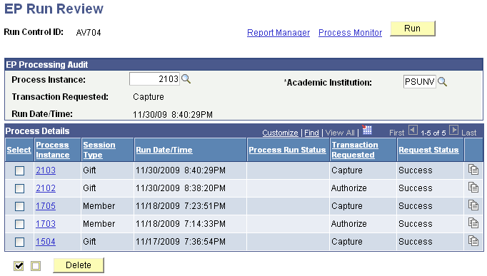

Access the EP Run Review page (select Contributor Relations, then select Session Management, then select Process Electronic Payments, then select EP Run Review).
Image: EP Run Review page
This example illustrates the fields and controls on the EP Run Review page. You can find definitions for the fields and controls later on this page.
EP (Electronic Payment) Run Review page
When you run the process, the system generates the AV704 report. Each electronic payment Transaction Requested status begins a new page, and the last page provides total transaction amounts.
EP Processing Audit
You can enter a Process Instance number to use for this report, or click the button at the end of a Process Instance row to copy that instance's information into the fields of the group box.

Process Instance
Click a numbered link to access the EP Run Review – Transaction List page, where you can review more details about the transactions processed in this instance.
Request Status
Values for this field are Success and Exception. An exception status means that at least one transaction in the instance did not return with the status you requested.
Delete
After selecting one or more process instances, click this button to remove them from the list of transactions used to generate the report.
Select icon and Deselect icon
Click the first button to select all process instances in the grid. Click the second button to clear checked instances.
