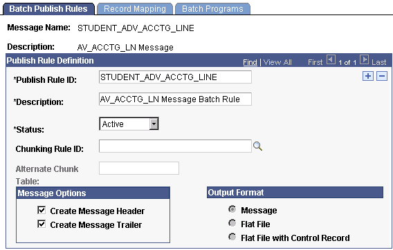

Access the Batch Publish Rules page (select Enterprise Components, then select Integration Definitions, then select Batch Publish Rules) and select the STUDENT_ADV_ACCTG_LINE message to enter the component. The Batch Publish Rules component (the Batch Publish Rules and Batch Programs pages) enables you to activate STUDENT_ADV_ACCTG_LINE messaging.
Image: Batch Publish Rules page
This example illustrates the fields and controls on the Batch Publish Rules page. You can find definitions for the fields and controls later on this page.
To define batch publish rules:
  1. Enter STUDENT_ADV_ACCTG_LINE in the Publish Rule ID field.
  2. Select Active in the Status field.
  3. For Financials 8.4 integration, select the Create Message Header and Create Message Trailer check boxes. For Financials 8.8 integration, clear these check boxes.

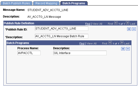

Access the Batch Programs page (select Enterprise Components, then select Integration Definitions, then select Batch Publish Rules, then select Batch Programs).
Image: Batch Programs page
This example illustrates the fields and controls on the Batch Programs page. You can find definitions for the fields and controls later on this page.
Batch Programs page
Enter the Process Name AVPACCTL, which EOP_PUBLISHA or EOP_PUBLISHM picks up when publishing accounting lines to the Financials system. If you do not select this process, the messages are not created when EOP_PUBLISHA or EOP_PUBLISHM runs.

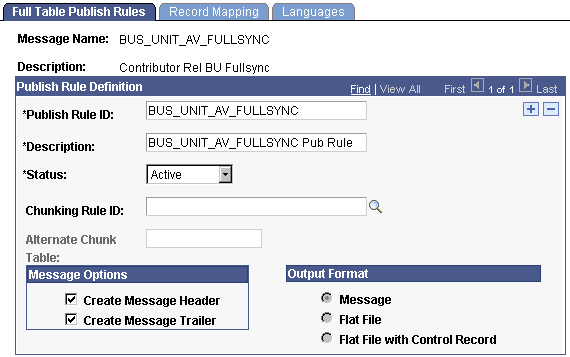

Access the Full Table Publish Rules page (select Enterprise Components, then select Integration Definitions, then select Full Data Publish Rules) and select the BUS_UNIT_AV_FULLSYNC message to enter the component. The Full Table Publish Rules Component (the Full Table Publish Rules and Full Table Publish pages) enables you to synchronize or "seed" Contributor Relations business unit information between Contributor Relations and Financials.
Note: You must synchronize all Contributor Relations business units before you run any GL processes, by running BUS_UNIT_AV_FULLSYNC full table publish once. Thereafter, the system manages additions or changes through messaging in the Business Unit CR component.
Image: Full Table Publish Rules page
This example illustrates the fields and controls on the Full Table Publish Rules page. You can find definitions for the fields and controls later on this page.
Field or Control
Definition
Publish Rule ID
Enter BUS_UNIT_AV_FULLSYNC. This rule publishes three fields (Business Unit, Description, Short Description) for all rows on the table to Financials.
Status
You must set this to Active.
Message Options
You must select the check boxes next to Create Message Header and Create Message Trailer.
