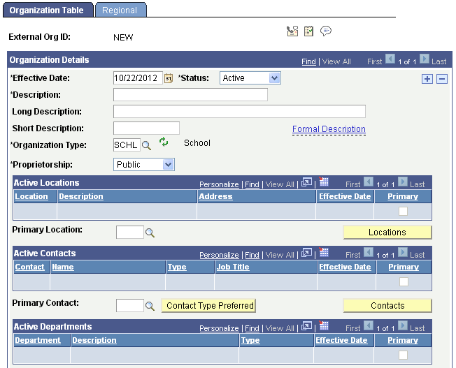

This example shows the Organization Table page when you are adding a new record for a school:
Image: Example of adding a new record on the Organization Table page (1 of 2)
This example illustrates the fields and controls on the Example of adding a new record on the Organization Table page (1 of 2). You can find definitions for the fields and controls later on this page.

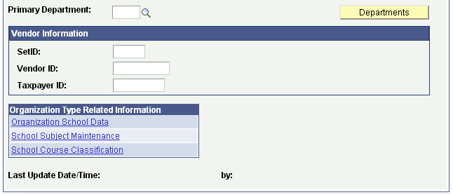

Image: Example of adding a new record on the Organization Table (2 of 2)
This example illustrates the fields and controls on the Example of adding a new record on the Organization Table (2 of 2). You can find definitions for the fields and controls later on this page.
Note: The links displayed in the Organization Type Related Information group box are determined by the Organization Type you enter. If links are not defined as part of the organization type setup, such as Student Financials, Third Party, or Other, the Organization Type Related group box will not appear on the Organization Table page.
  1. Enter at least the required data (Effective Date, Status, Description, Organization Type, and Proprietorship) in the Organization Details group box on the Organization Table page to add the new record.
    Warning! If you select Save before completing the required data, you must use the Correct History mode to continue entering or modifying the effective-dated data.
  2. Select Save.
    The system assigns the next available unique organization ID to the record and adds it to your database.
