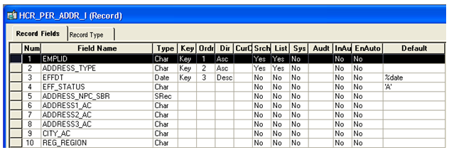

Below is an example of a delivered staging record with its matching production record that uses effective-dating:
Image: Production record definition that stores Addresses (HCR_PER_ADDR_I)
This example illustrates the fields and controls on the Production record definition that stores Addresses (HCR_PER_ADDR_I). You can find definitions for the fields and controls later on this page.

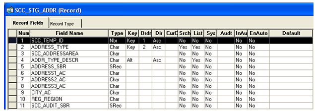

Its equivalent staging record definition is defined as follows:
Image: Matching Staging record definition that stores Addresses (SCC_STG_ADDR)
This example illustrates the fields and controls on the Matching Staging record definition that stores Addresses (SCC_STG_ADDR). You can find definitions for the fields and controls later on this page.

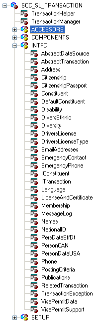

Below is an example of the SCC_SL_TRANSACTION:INTFC application package that comprises application classes used by Constituent Transaction Management:
Image: Example of application classes used by CTM
This example illustrates the fields and controls on the Example of application classes used by CTM. You can find definitions for the fields and controls later on this page.

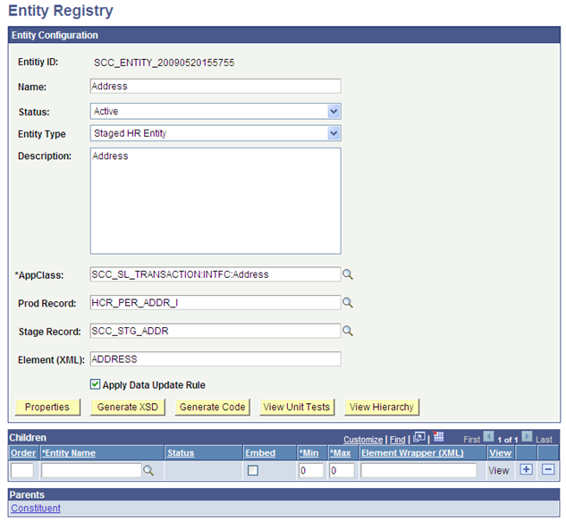

This section discusses how to create an entity for the application class you created in the previous section.
The new entity can be a parent entity or a child of an existing parent. For instance, delivered with your system, the Constituent and the Application entities are parent entities of many children.
Creation considerations:
Name the new entity in relation with the underlying record(s) (that is, the stage and/or the production records you are creating the entity for). For example, the entity name for the address underlying records is Address.
Select a delivered entity type that corresponds to the need of the transactions that use the entity. For example, if you create an entity for a transaction that requires temporarily staging the information to a stage record, make sure you select an entity type that use stage records. If the delivered entity types do not match your needs, create a new one.
Enter the application class name you created in the previous step. The application class you insert here extends the Base Application Class defined in the Entity Type selected. For example, if you create an entity using entity type Staged Entity, the application class you insert extends the base application class SCC_COMMON:ENTITY:StagedEntity. If you used entity type Basic Entity, the application class given inside the entity setup extends the base application class SCC_COMMON:ENTITY:BasicEntity.
Enter the other required information and save. After the first save, the Properties button is displayed. Use the Entity Properties page to add any extra needed properties. Save.
If the entity you created was to be a child of an existing entity (like Address is a child to Constituent entity), you can now access the parent entity and list the newly created entity in the Children grid of the Entity Registry page. If the entity you created was to be a parent, you can then attach children to it.
Warning! At this stage, if you added a child entity, the message schema does not reflect this new entity. However, if the entity is added to an incoming message and no schema validation is occurring, the incoming message containing this data is processed and this entity is handled. As an example, the Address entity is registered as a child entity to the Constituent entity.
Image: Example of the entity created for Address
This example illustrates the fields and controls on the Example of the entity created for Address. You can find definitions for the fields and controls later on this page.

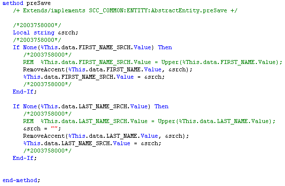

Any new class that you create may choose to override the preSave() method in order to default fields before the user saves the application.
Image: Examples of presave logic done inside the SCC_SL_TRANSACTION:INTFC.Names application class
This example illustrates the fields and controls on the Examples of presave logic done inside the SCC_SL_TRANSACTION:INTFC.Names application class. You can find definitions for the fields and controls later on this page.

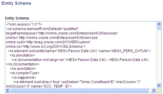

Access the top level entity name referred by the messages in the service operation and select the Generate XSD action (this may not necessarily be the parent entity name. It depends on what entities are referenced by the messages on the service operation).

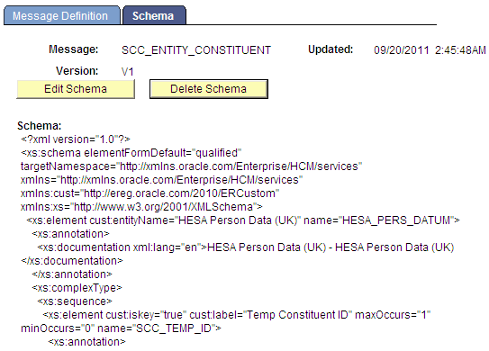

After selecting the Generate XSD action, the entity schema is displayed:
Image: Entity schema generated for the Constituent entity (parent entity)
This example illustrates the fields and controls on the Entity schema generated for the Constituent entity (parent entity). You can find definitions for the fields and controls later on this page.
Select the entire generated schema and paste it into the appropriate messages to modify the overall schema.
Navigate to Search for the relevant message. In the Schema tab, click the Edit Schema button and paste in the generated schema. Save the component.
For example, suppose you generated the schema for the Constituent entity. Navigate to the message Schema page. Search for the message called SCC_ENTITY_CONSTITUENT. Click the Edit Schema button and paste the generated schema as shown in screen shot below.
Image: Constituent message partial schema
This example illustrates the fields and controls on the Constituent message partial schema. You can find definitions for the fields and controls later on this page.

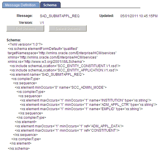

Note: The messages where you paste the schema are entity messages. These messages must be created with a message type of Part NonRowset based. This means they can be used by any Nonrowset based message. The web services created for your transaction can also refer to delivered entity messages. For example, a message with AAWS admission transaction, SAD_SUBMITAPPL_REQ message, calls both SCC_ENTITY_CONSTITUENT and SCC_ENTITY_APPLICANT message schema in its schema.
It is easy to maintain the entity messages as their schema can be generated from the Entity Registry page. Entity messages can be reused in any request or response message as per your requirement.
Image: Example of a web service message calling the schema of a ‘Part’ NonRowset message
This example illustrates the fields and controls on the Example of a web service message calling the schema of a ‘Part’ NonRowset message. You can find definitions for the fields and controls later on this page.
Once the schemas have been updated, the service WSDL needs to be republished in order to have all the new or updated entities recognized. In order to do that delete the existing WSDL under Select the appropriate service WSDL and press delete.

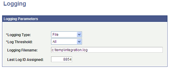

Access the Logging component to enable and configure the logging feature under .
Image: Example of how the Logging page can be set up
This example illustrates the fields and controls on the Example of how the Logging page can be set up. You can find definitions for the fields and controls later on this page.
Note: You should not enable logging in a production environment. SOA framework logging is only appropriate for a testing, demo or development environment or when performing critical troubleshooting activities.
