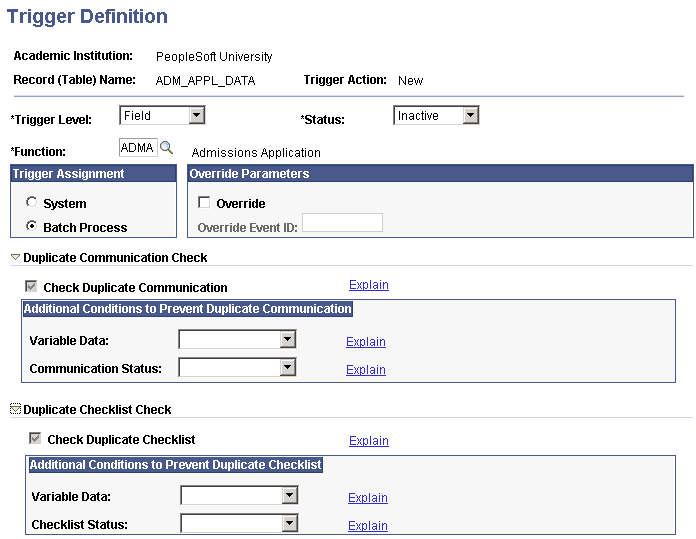

Access the Trigger Definition page (select Campus Community, then select 3C Engine, then select Set Up 3C Engine, then select Trigger Definition).
Image: Trigger Definition page (1 of 2)
This example illustrates the fields and controls on the Trigger Definition page (1 of 2). You can find definitions for the fields and controls later on this page.

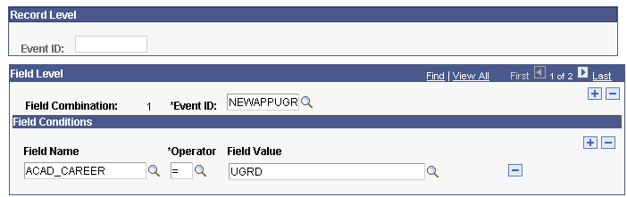

Image: Trigger Definition page (2 of 2)
This example illustrates the fields and controls on the Trigger Definition page (2 of 2). You can find definitions for the fields and controls later on this page.
Field or Control
Definition
Trigger Action
The system displays the action (New (add), Change, or Delete) that you selected. The action must occur as described on this page to invoke the 3C engine.
Note: The SavePostChange PeopleCode must use the same add, change, or delete action that you define here.
Trigger Level
Select the level at which this action must occur to invoke the 3C engine.
Record: The specified trigger action on the row invokes the 3C engine process, regardless of field. You must specify the 3C engine Event ID to process for a record level trigger.
Field: The specified trigger action on the field invokes the 3C engine process. You must specify the Event ID to process and the fields on which the specified action occurs, to invoke the 3C engine.
Function
Enter the functional area (administrative function) for this event trigger.
Trigger Assignment
Field or Control
Definition
System
Select this check box to insert or update in real time, the communications, comments, and checklists specified in the 3C engine event ID.
Batch Process
Select this check box to indicate that when the specified action occurs to the record or field, the system should insert a row on the Engine Trigger Results page for use by 3C engine background processing later.
Override Parameters
Field or Control
Definition
Override
Select this check box to prevent the 3C engine from using the field or record conditions identified on this page, and, instead, use the logic configured around the Function Trigger3CEngine PeopleCode on the record or component location.
If you select the Override option, you must specify the overriding 3C engine event ID to use.
Override Event ID
Enter the 3C engine event to process when the Override option is selected.
Duplication Communication Check
Field or Control
Definition
Check Duplicate Communication
Enter the 3C engine event to use to determine if a communication is a duplicate and to assign or prevent assignment according to the defined conditions.
See Managing Duplicate Communication Assignments.
Duplicate Checklist Check
Field or Control
Definition
Check Duplicate Checklist
The 3C engine event that determines if a checklist is a duplicate and assigns or prevents assignment according to defined conditions.
Record Level
Field or Control
Definition
Event ID
Enter the 3C engine event to process when the trigger level is Record.
Field Level
Field or Control
Definition
Field Combination
The system displays the next sequential field combination for each field level event ID that you add.
Event ID
Enter the 3C engine event to process when the trigger level is Field and the specified field conditions are met.
Field Conditions
You can define multiple field combination conditions. When the specified trigger action meets any of the conditions, the 3C engine processes the specified field level 3C engine event.
Field or Control
Definition
Field Name
Enter the name of the field on the specified record that, when this trigger action is performed, must meet the specified condition to invoke the 3C engine.
Operator
Enter the conditional operator for this field condition and the value that it modifies—for example, the admission term field (ADMIT_TERM) must be greater than or equal to 0390 (March 1990).
Values for this field are delivered with the system as translate values. You can modify these translate values:
< Less than.
<= Less than or equal to.
<> Not equal.
= Equal to.
> Greater than.
>= Greater than or equal to.
IN: In.
