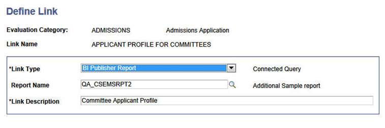

Image: Define Link page for BI Publisher Report
This example illustrates the fields and controls on the Define Link page (for link type of BI Publisher Report). You can find definitions for the fields and controls later on this page.
Define Links page for BI Publisher Report

Link setup is keyed by Evaluation Category
Field or Control
Definition
Link Type
Two link types are delivered: BI Publisher Report and URL. Behavior of the remaining fields on the page will change based upon the link type that you select.
Report Name
This field is available when you select BI Publisher Report as the link type. This field prompts against the BI Publisher Report Definition table (Reporting Tools, BI Publisher, Report Definition, Definition).

Link Description
The description defaults in from either the BI Publisher Report definition or the URL definition. You can change this default description.
