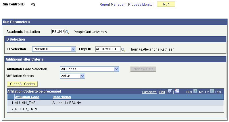

Access the Affiliation Select Delete Processing page (select Campus Community, then select Affiliations, then select Affiliations Select Delete).
Image: Affiliation Select Delete Processing page
This example illustrates the fields and controls on the Affiliation Select Delete Processing page. You can find definitions for the fields and controls later on this page.
ID Selection
Field or Control
Definition
ID Selection
Select either Person ID or Population Selection.
If you select Person ID, enter a single ID to list affiliation code(s) associated with this ID. If you select Population Selection, the Population Selection group box appears. Enter a Selection Tool (either External File or PS Query) and the corresponding values for the fields associated with that selection tool.
Empl ID
Enter the ID for the person for whom you want to delete affiliation code(s).
Additional Filter Criteria
Field or Control
Definition
Affiliation Code Selection
Select All Codes or One or More Codes.
If you select All Codes, the system evaluates all affiliation codes currently available within an institution for the person. Select One or More Codes to specify the exact affiliation code or codes to be evaluated for the person.
Affiliation Status
Select the status of the affiliation code you are considering deleting. System-defined affiliation status values are Active, Inactive, or Error.
Clear All Codes
Click this button to remove all affiliation codes listed to be processed as listed in the group box. You can use this button regardless of whether you are referring to a code for one person or you use Population Selection.
Preview Data
This button appears after you click the Run button to run the SCC_AFL_PRDL process that creates the people/affiliation code pairs that meet the criteria specified by the filter. This is the group that can be acted upon to delete affiliations. The Preview Data button is unavailable for selection until the process has been run.
Click the Run button after selecting IDs and applying the additional filter criteria for affiliation codes and affiliation status. When you click the Run button, the system creates the group of people and runs the SCC_AFL_PRDL Application Engine process. The process evaluates each affiliation code specified in the Affiliation Codes to be processed group box with the affiliation status for each ID from the person ID field or from the group of people created by the Population Selection process.
For each ID, the system evaluates whether the person has the affiliation code assigned with the affiliation status as indicated. If the person does not have the affiliation code assigned with the associated status, the process does not include this affiliation code for this person in the list and moves on to evaluate the next potential affiliation code for that person.
For groups created through the Population Selection process, the system evaluates each group member and determines if the ID has the affiliation code assigned with the associated status.
All IDs and affiliation codes that match the criteria appear on the Delete Affiliation page, where the actual ID/Affiliation code pair can be selected for deletion.
