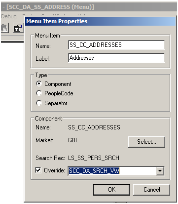

  4. Create a menu search record override.
    If you make a delivered Campus Solutions self-service component available for Delegated Access, the search record must be overridden. In fact, the component search record only returns the EMPLID for the person that is signed into your system (again, Campus Solutions self-service components display the information of the person that is logged in your system). When a proxy accesses one of these components, the search record should return the list of delegators that granted access to the component and for which the delegation status is Access Granted (not Revoked).
    Delivered with your system is a search record called SCC_DA_SRCH_VW. This search record should be added to the menus you created for the components that you want to delegate. This search record overrides the component search record.
    Image: Overriding Search Record for SCC_DA_SS_ADDRESS Menu
    This example illustrates using SCC_DA_SRCH_VW to override the search record for SCC_DA_SS_ADDRESS menu. You can find definitions for the fields and controls later on this page.
    When a proxy accesses one of the components that have been delegated, only the delegator names are returned. For example, Joe, Jane, and Jack are siblings attending the same school. Joe and Jane granted their mother Mary Smith access to their Emergency Contacts data. Jack granted his mother access to a different component. When the mother accepts the terms and conditions for each of her three kids, her user ID is tied to Joe, Jane and Jack’s EMPLIDs. When she navigates to the Emergency Contacts component (through the DA Menus), she sees a search record that returns only the names of her kids who granted her access to the component: Joe and Jane. Jack’s name is not listed because he did not grant his mother access to that component. Because we are using a DA Menu, if Mary was also a student at the institution, she wouldn’t see her own Emergency Contacts data from that navigation. To see her own data she must navigate to the regular Self Service, Campus Personal Information, Emergency Contacts component.
    Note: The search record SCC_DA_SRCH_VW returns only the delegator’s name. The system does not return the EMPLIDs to avoid giving unnecessary information to the proxy. If you created a proxy version of a student self-service component, the search record SCC_DA_SRCH_VW can be added directly to the component you created.

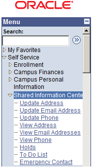

  5. Create a content reference to access the menu through the portal navigation.
    To create content references, go to select PeopleTools, then select Portal, then select Structure and Content.
    Each of the DA menu and component combinations that you created ust be added to its own content reference. For example, the SCC_DA_SS_ADDRESS menu (along with its three components) was added to the “Update Address”, “Update Email Address” and “Update Phone” content references. The following table represents the sample components delivered with your system and how they were added into a specific content reference.

    It is recommended that for each content reference you create for Delegated Access, you should add it to the Self Service, Shared Information Center portal folder. This becomes the navigation the proxy uses to see all of the components that were delegated. This also limits the number of places a proxy needs to navigate to access somebody else’s data.
    Image: Example of Content References in the Share Information Center Portal
    This illustrates an Example of Content References in the Share Information Center Portal.

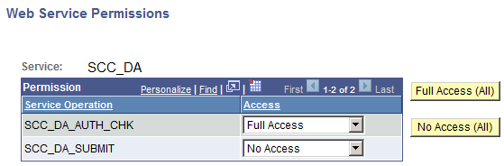

Granting access to the SCC_DA_AUTH_CHECK service operation
For each permission list that grants access to a DA menu, make sure it also grants access to the SCC_DA_AUTH_CHECK service operation. This web service is used by the Proxy Access Validation process when the proxy accesses a delegated component (PAV is triggered in realtime from the search record).
Note: If you do not grant access to the SCC_DA_AUTH_CHECK service operation, self-service users and administrators are not able to access the Share My Information component and Review Shared Information component, respectively.
Image: Setting Up SCC_DA_AUTH_CHK Service Operation in Permission Lists
This example illustrates how to Set Up SCC_DA_AUTH_CHK Service Operation in Permission Lists.
  1. Edit the permission list by going to select PeopleTools, then select Security, then select Permission Lists. For example: HCCPCSSA1141.
  2. Add the web service SCC_DA:
    1. Click Edit.
    2. For the SCC_DA_AUTH_CHK service operation, select Full Access.
  3. Make sure the required security for SCC_DA_AUTH_CHK is granted from the permission list you use to grant delegators access to the Share My Information component, and also from the permission list you use to grant administrators access to the Review Shared Information component. This is necessary because the PAV process is also triggered in real-time when users access these components.

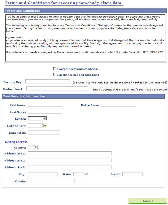

Review the Proxy Terms and Conditions self-service page and consider modifying the fields in the ‘Your Personal Information’ page (SCC_DA_PERINFO_SBP). This page is delivered as a sample. Include the desired constituent fields that you need to capture personal information about the proxy. If your delegation transactions are set to create an EMPLID for the proxies, make sure you gather enough information so Search/Match can use them as search data to identify or create an EMPLID.
The constituent fields that you can include in this page must be part of the Constituent entity or part of any of its children entities (for example, Names, Email Address, Citizenship, and so on). But you need to extend the SCC_DA:UTILS:DAUtils App Class methods to capture the data from new fields on this page.
It is recommended that you do not modify the delivered SCC_DA_PERINFO_SBP page. Instead clone it, then rename it.
Image: Proxy Terms and Conditions Page
This example illustrates the fields and controls on the Proxy Terms and Conditions Page.

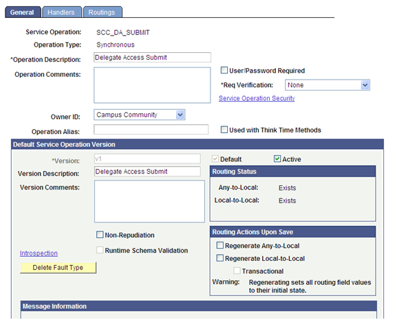

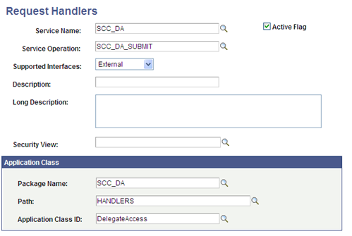

To activate the web service:
  1. Go to select PeopleTools, then select Integration Broker, then select Integration Setup, then select Service Operations. The Service Operations - Search page appears.
  2. Search for SCC_DA service, then select the SCC_DA_SUBMIT service operation.
  3. On the General page ensure that the SCC_DA_SUBMIT service operation is active and regenerate both ‘Any-to-Local’ and ‘Local-to-Local’ routing definitions.
    Image: Service Operations General Page for SCC_DA
    This example illustrates the fields and controls on the Service Operations General Page for SCC_DA.

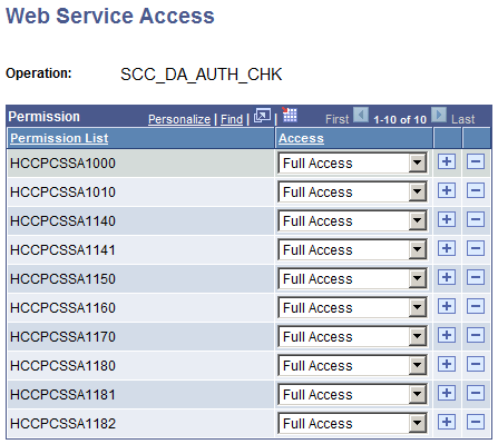

  4. To access the Web Service Access page, click Service Operation Security.
  5. On the Web Service Access page, make sure you select a permission list for which all users have access. This permission list must be included in a role that is granted to all your users. The proxy can have a newly created user ID or use an existing user ID, but make sure the proxy has access to a role that contains the permission list.
    Note: When you set up New User Registration, you are required to create a user ID called SCC_SS_TEMPLATE. This user ID is cloned when a new User ID is created. The user ID template needs to have access to the basic security role called Standard Non-Page Permissions. This role contains the HCSPSERVICE permission list. Proxies who create a new user ID automatically have access to the SCC_DA_SUBMIT web service operation.
  6. Perform steps 1–5 for the SCC_DA_AUTH_CHK service operation. In step 4, make sure all the permission lists that grant access to a delegated transaction are listed. For example, with the delivered sample delegated transactions, the following permission lists were created and should to be listed in the Service Operation Security:
    Image: Web Service Access Permission List Example
    This shows the Web Service Access Permission List Example.

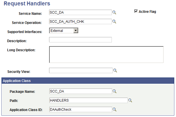

To verify that the request handler exists:
  1. Go to select Set Up SACR, then select System Administration, then select Integrations, then select Request Handlers.
  2. Search for the SCC_DA service name, then verify that the handler exists for both SCC_DA_SUBMIT and SCC_DA_AUTH_CHK service operations:
    Image: Request Handler Page for SCC_DA_SUBMIT
    This example illustrates the Request Handler Page for SCC_DA_SUBMIT.
    Image: Request Handler Page for SCC_DA_AUTH_CHK
    This example illustrates the Request Handler Page for SCC_DA_AUTH_CHK.
