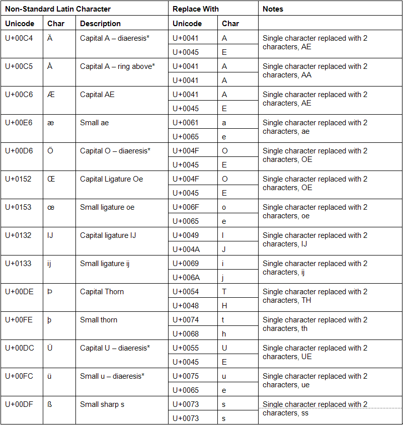

In some cases, a single non-standard character must be replaced with two characters and, in certain circumstances, this may cause the overall length of the name field to exceed the maximum 30 characters allowed in the alerts record. For each of the converted names fields, if the value exceeds the maximum characters allowed, then the value is truncated to 30 characters before being stored. An error for the alert is also logged.

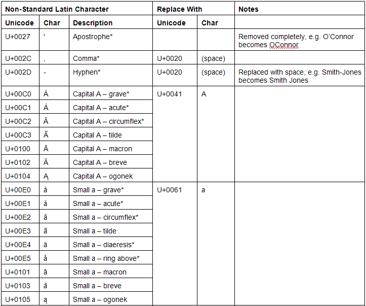

Image: Character Conversion for Punctuation Marks; Capital and Small A
This table illustrates the Character Conversion for Punctuation Marks; Capital and Small A.

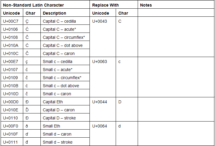

Image: Character Conversion for C and D
This illustrates the Character Conversion for C and D.

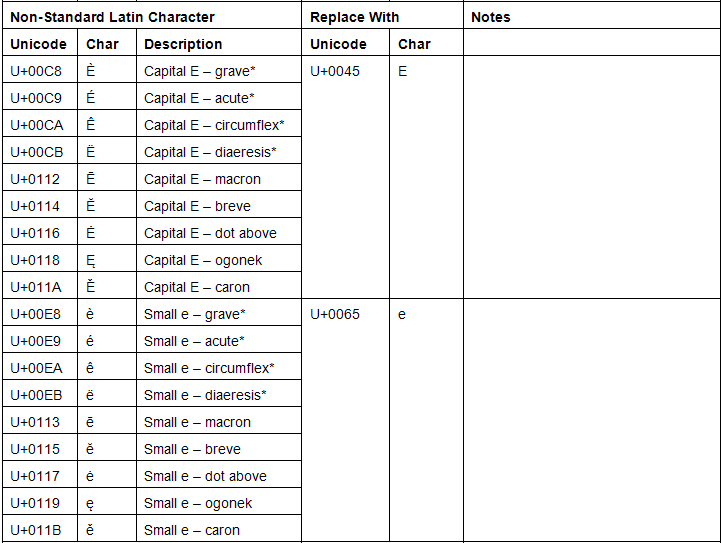

Image: Character Conversion for Capital and Small E
This illustrates the Character Conversion for Capital and Small E.

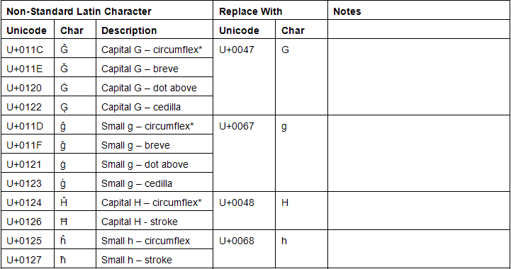

Image: Character Conversion for Capital and Small G; Capital and Small H
This illustrates the Character Conversion for Capital and Small G; Capital and Small H.

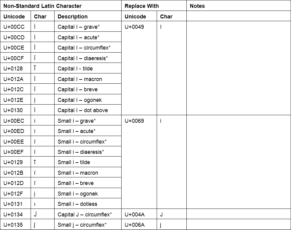

Image: Character Conversion for Capital and Small I; Capital and Small J
This illustrates the Character Conversion for Capital and Small I; Capital and Small J.

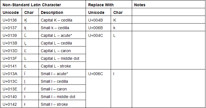

Image: Character Conversion for Capital and Small K; Capital and Small L
This illustrates the Character Conversion for Capital and Small K; Capital and Small L.

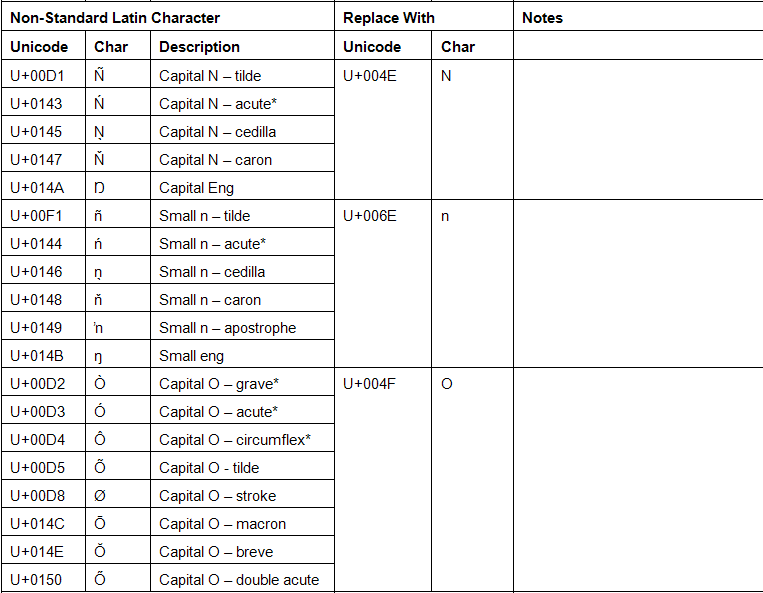

Image: Character Conversion for Capital and Small N; Capital O
This illustrates the Character Conversion for Capital and Small N; Capital O.

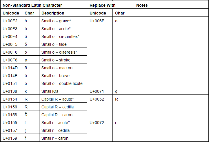

Image: Character Conversion for Small O; Small Q; Capital and Small R
This illustrates the Character Conversion for Small O; Small Q; Capital and Small R.

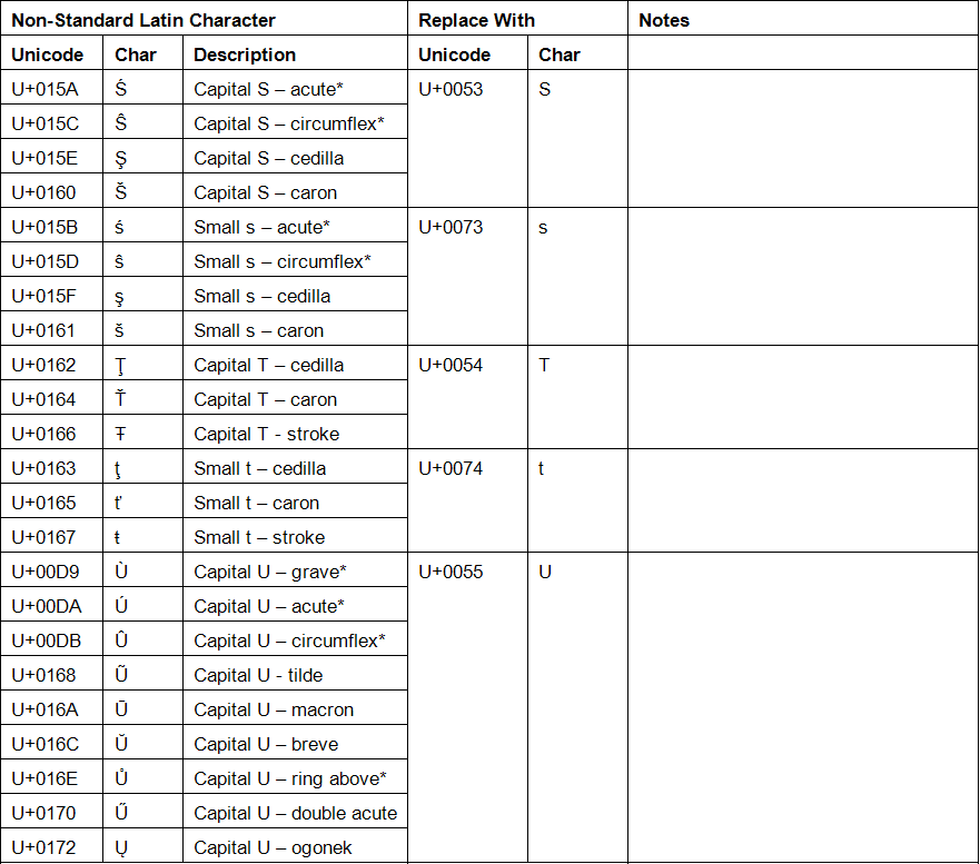

Image: Character Conversion for Capital and Small S; Capital and Small T; Capital U
This illustrates the Character Conversion for Capital and Small S; Capital and Small T; Capital U.

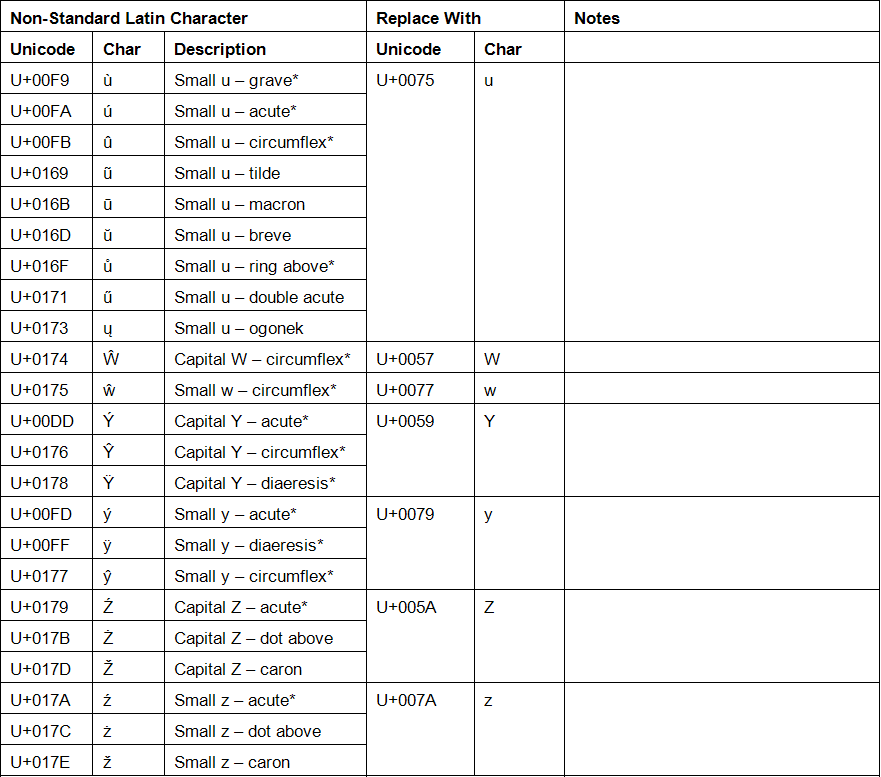

Image: Character Conversion for Small U; Capital and Small W; Capital and Small Y; Capital and Small Z
This illustrates the Character Conversion for Small U; Capital and Small W; Capital and Small Y; Capital and Small Z.
