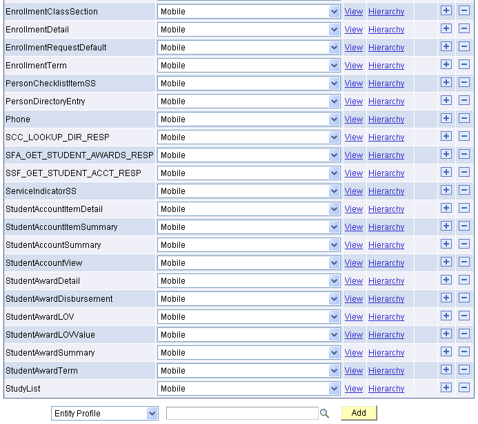

Image: Entity Profile page (2 of 2)
This example illustrates the fields and controls on the Entity Profile page (2 of 2). You can find definitions for the fields and controls later on this page.

Entity Name
Select the name of the entity to be associated with this profile, from the list of entities defined in the registry.
Entity View
Select the entity view to be used for this entity in the context of this profile.
View
Click this link to see details of access based on the entity view.
Hierarchy
Click this link to see the complete hierarchy, starting from the specified entity, based on the current profile.
At the end of the page, if you select Entity Profile, this allows the addition of all entities from another profile. Because this is a one time copy it can be done as often as you want.
If you select Entity Tree, you can add entities based on a parent entity being specified, tracing down the entire tree and adding data. This is a one time add, so it does not do maintenance.
