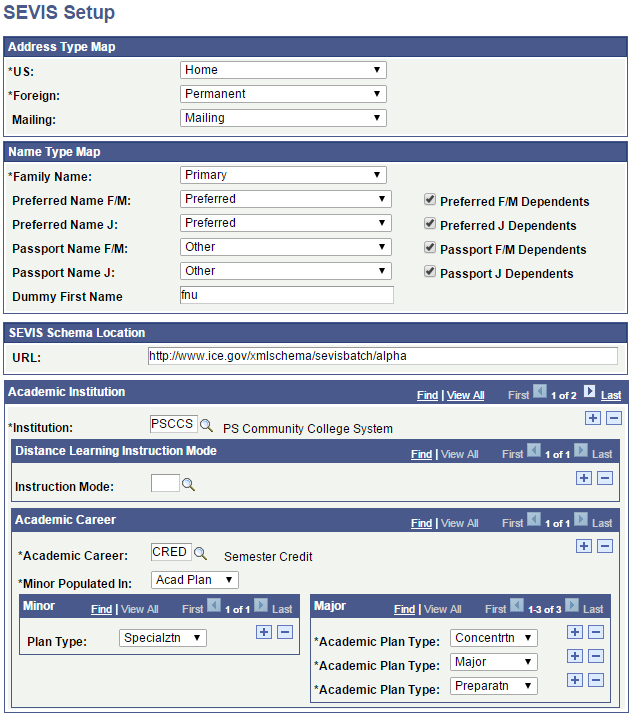

Access the SEVIS Setup page (select (Set Up SACR, then select Product Related, then select Campus Community, then select SEVIS, then select Common Definitions, then select SEVIS Setup).
Image: SEVIS Setup page
This example illustrates the fields and controls on the SEVIS Setup page. You can find definitions for the fields and controls later on this page.
SEVIS (Student and Exchange Visitor Information System) Setup page
Warning! You must define all careers used in SEVIS on the SEVIS Setup page and map at least one major academic plan type for each career. If you do not do this, you cannot view the primary and secondary majors on the I-20 form for F and M visas or the subject field codes on the DS-2019 J visas form, and the alerts process extracts a blank value.
Address Type Map
Field or Control
Definition
US
Select the address type in the United States to report to SEVIS.
Foreign
(F and M visas only) Select the address type in the student's country of citizenship to report to SEVIS.
Mailing
Optional. Select the address type that is reported as the mailing address for exchange visitors (J).
Name Type Map
Field or Control
Definition
Family Name
Select the name type to report to SEVIS. This name appears on the I-20 or DS-2019 form.
Preferred Name F/M
Optional. The value you set determines which name populates Preferred Name for F/M in alerts and SEVIS Master.
If your institution decides not to report to SEVIS, you may choose not to populate this field. The value will be auto-populated at SEVIS.
Preferred F/M Dependents
Select whether or not to report values for dependents.
By default, this check box is deselected, and is enabled only when a name type is defined for Preferred Name F/M.
Preferred Name J
Optional. The value you set determines which name populates Preferred Name for J in alerts and SEVIS Master.
Preferred J Dependents
By default, this check box is deselected, and is enabled only when a name type is defined for Preferred Name J.
Passport Name F/M
Optional. The value you set determines which name populates Passport Name for F/M in alerts and SEVIS Master.
Passport F/M Dependents
By default, this check box is deselected, and is enabled only when a name type is defined for Passport Name F/M.
Passport Name J
Optional. The value you set determines which name populates Passport Name for J in alerts and SEVIS Master.
Passport J Dependents
By default, this check box is deselected, and is enabled only when a name type is defined for Passport Name J.
Dummy First Name
Optional. The value you set in this field is used as a substitute value in the First Name field for students with a single name.
Only a single value is provided so your institution must make sure it consistently uses the same dummy value for all SEVIS students with a single name. As per SEVIS name standards, you should use the single name to populate the Last Name field.
SEVIS Schema Location
Field or Control
Definition
URL
Enter the URL to send the data to, based on the SEVIS schema that you use (production, beta test, or alpha test). Do not put a backslash at the end of the file path.
The Export SEVIS Events - F/M process and the Export SEVIS Events - J process inserts this location in the xml file that it produces. If you do not enter the schema location, the process will produce the xml file without the schema location and the file will be rejected by SEVIS.
The locations for each SEVIS environment are:
Warning! These values may change according to updates in the API. You may need to modify them accordingly.
Production – http://www.ice.gov/xmlschema/sevisbatch
Beta Test – http://www.ice.gov/xmlschema/sevisbatch/beta
Alpha Test – http://www.ice.gov/xmlschema/sevisbatch/alpha
Academic Institution
Field or Control
Definition
Institution
Select the institution for which you are setting up SEVIS information.
Distance Learning Mode of Instruction
Field or Control
Definition
Instruction Mode
Select the mode by which Distance Learning courses are presented, for example Television, Correspondence, World Wide Web, and so on.
Only one distance learning class can be used toward full time. The Auth Drop Below FC logic uses the Instruction Mode to find the distance learning class with the greatest number of units and uses it in calculating full time.
Academic Career
Field or Control
Definition
Academic Career
Select the academic career used at your institution.
Minor Populated In
For F/M visa processing only. Does not apply to J visas.
Select either Acad Plan or Sub Plan.
Minor
For F/M visa processing only. Does not apply to J visas. The field and available choices in the Minor group box change according to your selection in the Minor Populated In field.
Field or Control
Definition
Plan Type
If you enter Acad Plan in the Minor Populated In field, the Plan Type field appears, and academic plans are available for selection.
You must enter the type of academic plan. Select from:
Concentrntn (concentration)
Honors
Major
Minor
Prepratn (preparation)
ROTC (Reserve Officer Training Corps)
Specialztn (specialization)
The SEVIS Alerts – F/M process uses this value to determine which academic plan to extract as a minor.
Sub-Plan Type
If you enter Sub Plan in the Minor Populated In field, the Sub-Plan Type field appears and subplans are available for selection.
You must enter the type of subplan. Values are:
Conc (concentration)
Emphasis
Minor
Option
Spec(specialization)
Track
The SEVIS Alerts - F/M process uses this value to determine which subplan to extract as a minor.
Major (for F and M visas, and for J visas)
Field or Control
Definition
Academic Plan Type
For each academic career, select the academic plan type for the SEVIS Alerts process and the visa form logic to use.
Select from Concentrntn (concentration), Honors, Major, Minor, Prepratn (preparation), ROTC (Reserve Officer Training Corps), and Specialztn (specialization).
For F/M visas, the SEVIS Alerts – F/M process uses this logic to determine the primary and secondary majors to enter on the I-20 form.
For J visas, the SEVIS Alerts – J process uses this logic to determine the subject field code to enter for the student category exchange visitors on the DS-2019 form.

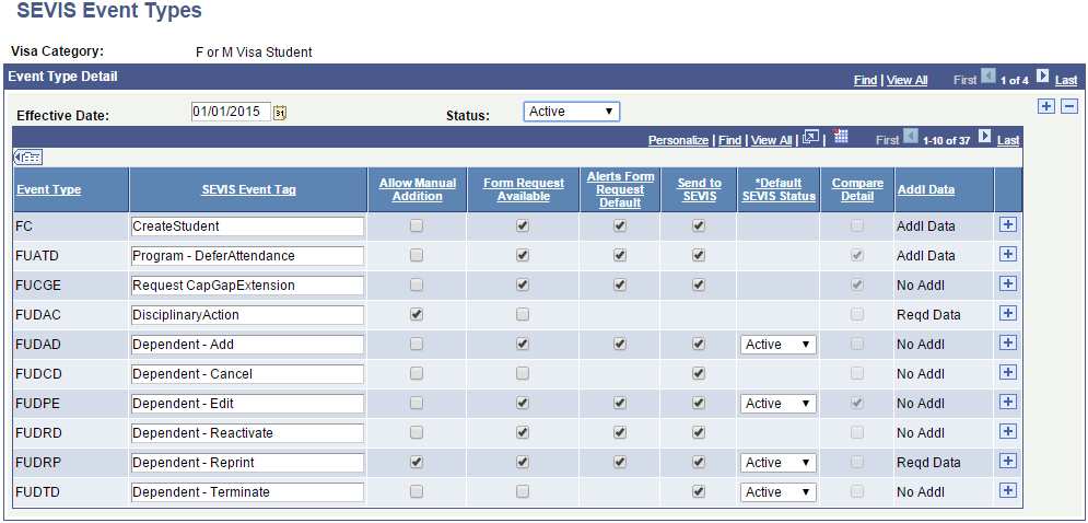

Access the SEVIS Event Types page (select Set Up SACR, then select Product Related, then select Campus Community, then select SEVIS, then select Common Definitions, then select SEVIS Event Types).
Image: SEVIS Event Types page
This example illustrates the fields and controls on the SEVIS Event Types page. You can find definitions for the fields and controls later on this page.
SEVIS (Student and Exchange Visitor Information System) Event Types page
Note: The DHS defines the SEVIS events in Application Program Interface Document (API).
Field or Control
Definition
Event Type
Displays the PeopleSoft event type codes for the visa category entered (either F/M visas or J visas). The SEVIS Alerts process and pages use these codes.
Warning! Do not change or delete event types. Doing so affects the alerts processing.
SEVIS Event Tag
Enter the DHS description of the event.
You can modify event tags.
Allow Manual Addition
Select to enable manual addition of this event type on the SEVIS Alerts Header page.
DSOs can make manual additions on the Alerts Header page to submit certain data to SEVIS for when student updates are not detected as data changes in the PeopleSoft Campus Solutions system.
The delivered F/M visa event types that allow manual addition are:
Dependent – Reprint
AuthDropBelowFC – Add
AuthDropBelowFC – Cancel
AuthDropBelowFC – Edit
Status – Complete
Reprint
Disciplinary Action
Status – Terminate
ROs can make manual additions on the Alerts Header page to submit certain data to SEVIS for when exchange visitor updates are not detected as data changes in the PeopleSoft Campus Solutions system.
The delivered J visa event types that allow manual addition are:
Dependent – Reprint
Reprint
Status – Invalid
Status – NoShow
Status – End
Status – Correct Infraction
Status – Terminate
Status – Validate
Note: Status – End events are no longer included in the 6.23 batch schema. It is recommended that you do not select the Allow Manual Addition check box.
Form Request Available
Do not modify this.
This check box is pre-selected or not based on the information in the Application Program Interface (API) document.
When this check box is selected, it indicates that a new PDF form file (I-20 for F/M visas or DS-2019 for J visas) can be requested for this event. Also, the New Form check box becomes available on the Alerts Header page.
Alerts Form Request Default
Select to automatically select the New Form check box on the SEVIS Alerts Header page when this event type is detected.
You can modify it based on your institution's preferences.
Send to SEVIS
Select to automatically set the Send To field on the Alerts Header page to SEVIS when this event type is detected.
The Send to SEVIS check box is available when additional data is not required for the event type. (See the Addl Data column description for a list of event types and their additional data status.)
Note: Following the 6.23 batch release, it is recommended to deselect the Send to SEVIS check box for FUEOD OPT Employment – Add events. These events are currently not supported.
Default SEVIS Status
Applies to F/M visas only. Does not apply to J visas.
This field appears only for events that can be triggered for a SEVIS status of Active or Initial.
Select the status to use as the default when sending an update event if an Education Level – Change event has been previously sent to SEVIS.
SEVIS uses this value to determine which record to update when an Education Level – Change event creates a second record with a SEVIS status of Initial.
You can override the default status value on the Select Alerts to Report – F/M component.
Compare Detail
When selected, causes a detail subpage to be available from the Select Alerts to Report component showing the changed data that caused the event to trigger.
This value is preset in the system based on events where data differences can trigger the event.
Addl Data additional data)
Displays the value based on the event type.
No Addl = Additional data is neither required nor permitted.
Reqd Data = Additional data is required and must be entered on the Addl Data page of the Select Alerts to Report component to send the event to SEVIS.
The F/M event types for which additional data is required are:
Disciplinary Action
Status - Terminate
AuthDropBelowFC - Add
AuthDropBelowFC - Edit
Dependent - Reprint
Reprint
Program - Extension
The J event types for which additional data is required are:
Dependent - Add
Dependent - Reprint
Program - Shorten
Program - EditSubject
Reprint
Status - Invalid
Status - Terminate
Status - Correct Infraction
Status - End
Addl Data = Additional data optional on the Addl Data page of the Select Alerts to Report component.
The F/M event types for which additional data is optional are:
Program - Edit
Program - Cancel Extension
Education Level - Change
Education Level - Cancel
Personal Info
Status - Complete
Program - Shorten
Program - Defer Attendance
Registration
Status - Cancel
The J event types for which additional data is optional are:
Biographical
Program - Amend
Program - Extension
Dependent - Edit
Site of Activity - Edit
