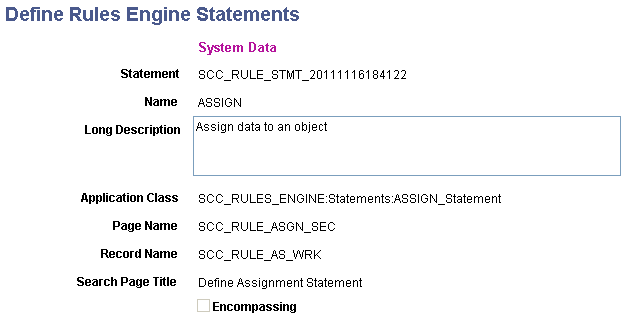

Define Rules Engine Statements
SCC_RULE_STMT_TBL
select Set up SACR, then select System Administration, then select Rules Engine, then select Setup, then select Define Statements
Define Statements to use in Rule evaluations and calculations.

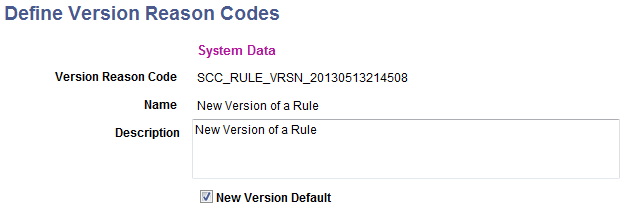

Define Version Reason Codes
SCC_RULE_VRSN_TBL
select Set up SACR, then select System Administration, then select Rules Engine, then select Setup, then select Define Version Reason Codes
Define Rules Version Reason Codes to use when creating new versions of existing Rules.

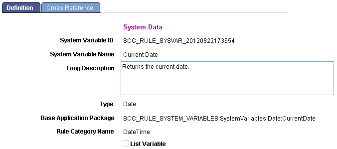

Define System Variables
SCC_RULE_SYSVAR
select Set up SACR, then select System Administration, then select Rules Engine, then select Setup, then select Define System Variables, then select Definition
Define System Variables to use when creating Rules.

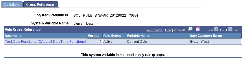

System Variables Cross Reference
SCC_RULE_SYSV_XREF
select Set up SACR, then select System Administration, then select Rules Engine, then select Setup, then select Define System Variables, then select Cross Reference
Displays Rules and Rule Groups associated with the System Variable.

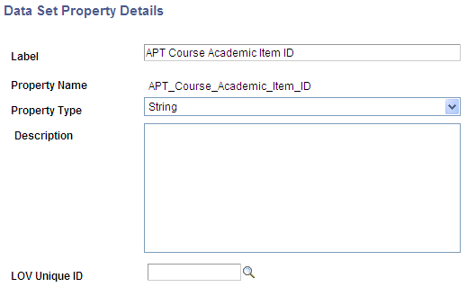

Data Set Property Details
SCC_EDS_PROP_DTLS
Click the Details link on the Define Data Sets page.
Define Data Set property details.

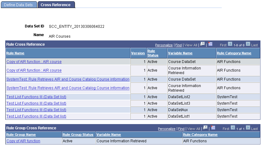

Data Set Cross Reference
SCC_RULE_EDS_XREF
select Set up SACR, then select System Administration, then select Rules Engine, then select Setup, then select Define Data Sets, then select Cross Reference
Displays Rule and Rule Groups associated with the Data Set.

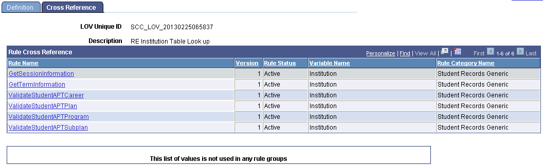

List of Values Cross Reference
SCC_RULE_LOV_XREF
select Set up SACR, then select System Administration, then select Rules Engine, then select Setup, then select Define List of Values, then select Cross Reference
Displays Rule and Rule Groups associated with the List of Values.

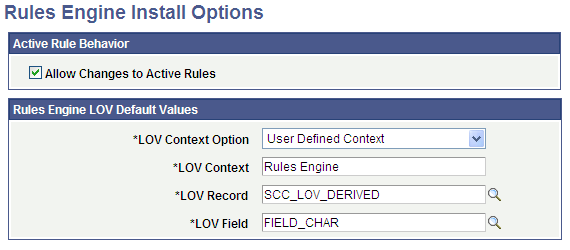

Access the Rules Engine Install Options page (select Set up SACR, then select System Administration, then select Rules Engine, then select Setup, then select Install Options, then select Rules Engine Install Options).
Image: Rules Engine Install Options page
This example illustrates the fields and controls on the Rules Engine Install Options page. You can find definitions for the fields and controls later on this page.
Field or Control
Definition
Allow Changes to Active Rules
Select this check box to allow changes to active Rules or Functions. You can use this flag to override the feature that makes Rules features inaccessible when Rules or Functions are active. This option can be useful in non-production environments in cases where it should be possible to change active Rules.
The check box is not selected by default.
When Allow Changes to Active Rules is not selected only the following can be changed or accessed by the user when accessing the Rules Engine Manager Component:
  • Rule Long Description (change)
  • View of Variables (access)
  • View of Evaluations and Calculation Details. (access)
When Allow Changes to Active Rules is not selected, the following Action Drop down options are not available:
  • Create new Version of Rule
  • Delete Rule
  • Inactivate Rule
  • Remove Rule Group from Rule
  • Delete Rule Group
  • Inactivate Rule Group
When Allow Changes to Active Rules is not selected, Rule Groups that are selected to be Available In Dynamic Rules cannot be altered.
Rules Engine LOV Default Values
Rules Engine List of Values (LOV) allows you to define Rules Engine prompting for variables created and used in the Rules Engine Manager. The system-delivered default values of the fields in this group box control LOV functionality in the Rules Engine Manager.
Warning! Do not change the values delivered with the system.

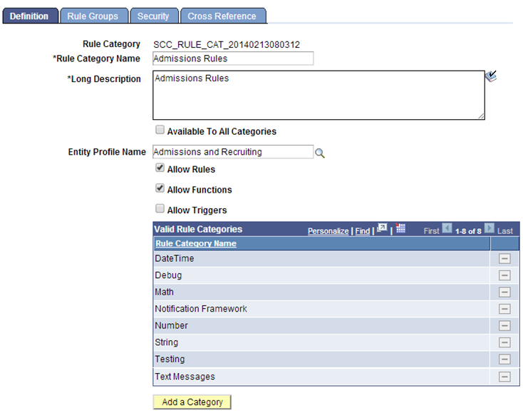

Access the Rule Category Definition page (select Set up SACR, then select System Administration, then select Rules Engine, then select Setup, then select Define Categories, then select Definition).
Image: Rule Category Definition page
This example illustrates the fields and controls on the Rule Category Definition page. You can find definitions for the fields and controls later on this page.
Using this category as an example, you cannot create Functions or Rules in category Math, but you can create Functions and Rules in category AIR Functions and CALL Functions in category Math.
Field or Control
Definition
Rule Category
Displays a unique ID generated by the system. When adding a new Rule Category, the default value is NOID. After saving the Rule Category, a unique ID is generated by the system and assigned to the Rule Category. The ID is created by combining prefix “SCC_RULE_CAT_” with the system date and time stamp in format YYYYMMDDHHMMSS.
Rule Category Name
Enter a Rule Category Name. The Rule Category Name is used when searching for a Rule Category and for display.
Long Description
Enter descriptive text explaining the function of the Rule Category.
Available to All Categories
Select this check box to make this Category automatically available as a valid Category in other Categories. Categories that are defined as “Available to all Categories” cannot have any Valid Categories of its own. When this check box is deselected, the Category is no longer available in other Categories.
Note: Security settings on the Rule Category affect all Rules, Functions and Triggers which have been called from or created in this Category.
In the example below the Category Math has been made available to Category “Admissions Rules” as a Valid Rule Category. Every Function and Rule Created in Category Math can now be called from a Function or Rule created in Category “Admissions Rules”.
Note: Deselecting “Available to All Categories” on category Math would remove the Category from Admissions Rules and invalidate the security on the Call statement of rules which have already been created. Although this would not break compiled Rules it would cause problems when users want to change those rules.
Entity Profile Name
Enter the Entity Profile Name that you want to associate to this Rule Category. Rules, Functions and Triggers can be built using the Base Entities which have been setup in this Entity Profile. If the Entity Profiles uses Views, access to certain properties within an Entity may have been restricted.
Allow Rules
Select this check box to allow the creation of Rules with this Rule Category.
Allow Functions
Select this check box to allow the creation of Functions with this Rule Category.
Allow Triggers
Select this check box to allow the creation of Triggers with this Rule Category.
Valid Rule Categories
Select Rule Categories available to this Rule Category. The Rules, Functions, and Triggers of the selected categories can be called by Rules created in the main Category.
Note: This is not an inheritance model. Adding a valid Rule Category here gives you access to the Rules, Functions, and Triggers native to that Rule Category but not to Rules, Functions, and Triggers of any Rule Categories associated with the selected Rule Category.

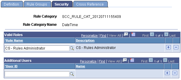

Access the Rule Category Security page (select Set up SACR, then select System Administration, then select Rules Engine, then select Setup, then select Define Categories, then select Security).
Image: Rule Category Security page
This example illustrates the fields and controls on the Rule Category Security page. You can find definitions for the fields and controls later on this page.
Field or Control
Definition
Valid Roles
Enter Valid Roles for which the Rules Category definition is valid. These are Roles that are set up using the standard PeopleTools Security function.
Additional Users
Enter additional users for which the Category Definition is valid. The registration of Additional Users is supplemental to the Valid Roles.

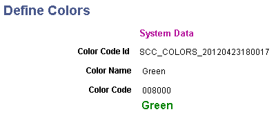

Access the Define Colors page (select Set up SACR, then select System Administration, then select Rules Engine, then select Setup, then select Define Colors).
Image: Define Colors page
This example illustrates the fields and controls on the Define Colors page. You can find definitions for the fields and controls later on this page.
Define Colors page
Although Oracle recommends using the pre-delivered color range, you can add new colors to the system for the Rules Engine Manager user interface elements. New colors can be added simply by adding a new entry, specifying a Color Name and a Color Code which conforms to the HTML color code standard.
Field or Control
Definition
Color Code ID
Displays a unique ID generated by the system. When adding a new value the default value is NOID. The unique ID is generated when the Color Code is saved. The Color Code ID is created by combining prefix SCC_COLORS_ with the system date and time stamp in format YYYYMMDDHHMMSS.
Color Name
Enter the name of the color; for example, Sky Blue.
Color Code
Enter an HTML standard color code. New color codes can be defined using HTML standards.
  • HTML color codes format – Each HTML code contains the symbol "#" and 6 letters or numbers. These numbers are in hexadecimal numeral system; for example, "FF" in hexadecimal represents number 255 in decimal.
  • Meaning of the HTML color codes format – After the “#” symbol, the first two positions in HTML color code represent the intensity of red color. “00” is the least, and “FF” is the most intense. The third and fourth positions represent the intensity of green color, and the fifth and sixth positions represent the intensity of blue color. By varying the intensity of red, green and blue, you can create a large number of colors.

This example illustrates the fields and controls on the Define Rules Engine Text Colors page. You can find definitions for the fields and controls later on this page.
Use this page to assign colors to Rules Engine Manager elements. The following elements can be color coded:
  • Entity String
  • Hard Coded Text
  • Property
  • Rule Name
  • Statement
  • Text
  • Variable
  • Call Argument
  • Call Return

Access the Define Rules Engine Statements (select Set up SACR, then select System Administration, then select Rules Engine, then select Setup, then select Define Statements).
Image: Define Rules Engine Statements page
This example illustrates the fields and controls on the Define Rules Engine Statements page. You can find definitions for the fields and controls later on this page.
Field or Control
Definition
Statement
Displays a unique system-generated Rules Engine Statement identifier. When adding a new value the default value is NOID. The unique ID is generated when the Rules Engine Statement is saved. The Rules Engine Statement ID is created by combining prefix SCC_RULE_STMT_ with the system date and time stamp in format YYYYMMDDHHMMSS.
Name
Enter a Statement Name. The Statement Name is used when searching for a Statement and for display.
Long Description
Enter descriptive text explaining the function of the Statement.
Application Class
Enter the Application Class for this Rules Engine Statement. Logic for system–delivered Statement functionality uses the SCC_RULES_ENGINE:Statements Application Class.
Warning! To ensure that delivered functionality works as intended, do not change delivered Application Classes.
Page Name
Enter the Page Name for this Rules Engine Statement. Each Statement references a secondary page specifically created for this Statement. The secondary page is used to display Statement functionality to the end user. The Statement secondary pages are pre–delivered and are designed to render Statement logic in a specific way.
Warning! To ensure that delivered functionality works as intended, do not change the Page Name for the Statement.
Record Name
Enter the Record Name for this Rules Engine Statement. Each Statement has a unique work record reference. The associated work record is used to technically facilitate the information shown on the secondary pages. The Statement work records are pre–delivered and have been designed to render Statement logic in a specific way.
Warning! To ensure that delivered functionality works as intended, do not change the Record Name for the Statement.
Search Page Title
Enter the Page Title for the Rules Engine Statement. The Page Title is displayed at the top of the Statement grid once the Statement has been selected for use in the Rule.
Encompassing
Select to indicate whether the Statement created is an encompassing statement. An Encompassing Statement is one which can enclose one or more other Statements in the Rule. The following delivered statements are encompassing:
  • IF (ELSE)
  • For-each
  • Create-Entity

New versions of Rules can be created for each Rule, Trigger or Function. Rule Versions are managed on the Rules Engine Manager Rule Version Page. New versions of Rules can be created for reasons like needing to incorporate new Rule logic or correcting Rule mistakes. To facilitate Rule maintenance, use Rule Version reason codes to indicate why a new version was created. Define Rule Version Codes on the Rules Version Reason Code setup page.
Note: For Version Reason Codes delivered with the system, only the Description can be modified.
Note: The system-delivered Version Reason Code of New Version of the rule is used automatically whenever a new version of a rule is created. This Version Reason Code is delivered with the Initial Version Default check box selected. If the Initial Version Default check box is not selected, the Version Reason Code of New Version of the rule can be selected to be both the Initial Version Reason Code as well as the New Version Reason Code.
Access the Define Version Reason Codes page (select Set up SACR, then select System Administration, then select Rules Engine, then select Setup, then select Define Version Reason Codes).
Image: Define Version Reason Codes page
This example illustrates the fields and controls on the Define Version Reason Codes page. You can find definitions for the fields and controls later on this page.
Field or Control
Definition
Version Reason Code
Displays a unique ID generated by the system. When adding a new value the default value is NOID. The unique ID is generated when Version Reason Code is saved. The ID is created by combining prefix SCC_RULE_VRSN_ with the system date and time stamp in format YYYYMMDDHHMMSS.
Name
Enter a Version Reason Name. The Version Reason Name is used when searching for a Version Reason and for display.
Description
Enter descriptive text explaining the function of the Version Reason Code..
Select this check box to use this Version Reason code automatically when the rule is created. Comments can be added to the Version Reason code before the Version page is saved. The system-delivered Version Reason Code Initial Version of the Rule is delivered with this check box selected.
New Version Default
Select this check box to use this Version Reason Code automatically whenever a new version of a rule is created. The system-delivered Version Reason Code New Version of the rule is delivered with this check box selected.
If the Initial Version Default check box for the system-delivered Version Reason Code Initial Version of the Rule is not selected and the system-delivered Version Reason Code New Version of the rule is selected, the New Version Default reason is used for both.

Defining Rules Engine System Variables
A System Variable is predefined in the system typically by a developer or programmer. Once created, the System Variable can be used in Rules built by functional experts. System Variables can be created to provide re-usable defaults for commonly used values such as system date, Operator ID, etc.
Note: Rules Engine System Variables delivered with the system cannot be modified.
Access the Define System Variables page (select Set up SACR, then select System Administration, then select Rules Engine, then select Setup, then select Define System Variables, then select Definition).
Image: Define System Variables page
This example illustrates the fields and controls on the Define System Variables page. You can find definitions for the fields and controls later on this page.
Field or Control
Definition
System Variable ID
Displays a unique ID generated by the system. When adding a new value the default value is NOID. The unique ID is generated when the system variable is saved. The Statement ID is created by combining prefix SCC_RULE_SYSVAR_ with the system date and time stamp in format YYYYMMDDHHMMSS.
System Variable Name
Enter a System Variable Name. The System Variable Name is used when searching for a System Variable and for display.
Long Description
Enter descriptive text explaining the function of the System Variable.
Type
Select the Type of Variable. Values are:
  • Date
  • DatetTime
  • Text
  • Time
  • Number
  • True/False (This Variable Type accommodates Boolean values.)
Base Application Package
Enter the Base Application Package for this System Variable. The Base Application Package contains the logic that returns the System Variable. System Variables can only be assigned using application package PeopleCode. Delivered system variables have been created in the reserved application package: SCC_RULE_SYSTEM_VARIABLES:SystemVariables.
Note: Oracle expects to make new system variables available as needed.
Rule Category Name
Enter the Rule Category Name for this System Variable. This restricts direct access to specific System Variables.
List Variable
Select this check box if the System Variable needs to accommodate the return of multiple values.
For a complete listing of System Variables delivered with the system for use in Rules and Functions by an Expert user, see Library of System-Delivered Rules Engine Objects
Access the Define System Variables Cross Reference page (select Set up SACR, then select System Administration, then select Rules Engine, then select Setup, then select Define System Variables, then select Cross Reference ).
Image: Define System Variables Cross Reference page
This example illustrates the fields and controls on the Define System Variables Cross Reference page. You can find definitions for the fields and controls later on this page.
This page shows Rules and Rule Groups associated with this System Variable.
Field or Control
Definition
Rule Name and Rule Group Name
Displays to authorized users a link for any of these Rules Engine objects which use this System Variable. If a user is not authorized, the link is disabled.
Click a link to transfer out of the component and to the referenced object.
Warning! Make sure you have saved any data that you need to before confirming you want to transfer to the referenced object in a new component.
If no objects use the System Variable, a notification is shown in place of the object details. for example, “This System Variable is not used by any Rule Groups”.
Version
Displays the Rule Version Number.
Rule Status and Rule Group Status
Displays the status of the Rule Group or Rule Name (In Progress, Active, In-active).
Variable Name
Displays the name of the Variable associated with the System Variable.
Rule Category Name
Displays the Rule Category Name in which the Rule or Rule Group has been created.

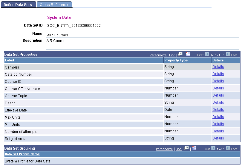

Access the Define Data Sets page (select Set up SACR, then select System Administration, then select Rules Engine, then select Setup, then select Define Data Sets).
Image: Define Data Sets page
This example illustrates the fields and controls on the Define Data Sets page. You can find definitions for the fields and controls later on this page.
Field or Control
Definition
Data Set ID
Displays a unique ID generated by the system. When adding a new value the default value is NOID. The unique ID is generated when the Data Set is saved. The Statement ID is created by combining prefix SCC_ENTITY_ with the system date and time stamp in format YYYYMMDDHHMMSS.
Name
Enter a Data Set Name. The Data Set Name is used when searching for a Data Set and for display.
Actions
  • Clone Data Set – Select this option to copy from an existing Data Set. A prompt is presented from which a Data Set can be selected.
  • Copy Properties from – Select this option to copy from an Entity. A prompt is presented from which an Entity can be selected. A Data Set Property is created for each Property which exists on the selected Entity.
Description
Enter descriptive text explaining the function of the Data Set..
Label
Enter a Label for each of your Data Set properties. This Label is used in the Rules Engine Manager to display the Data Set Property.

Access the Data Sets Details page (click the Details link on the Define Data Sets page).
Image: Data Set Property Details page
This example illustrates the fields and controls on the Data Set Property Details page. You can find definitions for the fields and controls later on this page.
The Data Set Property details page allows you to add a long Description for a Property and List of Values (LOV) which can be used to enforce Prompt Edits.
For more information, see Defining Lists of Values for Rules Engine Variables.

Access the Define Data Sets Cross Reference page (select Set up SACR, then select System Administration, then select Rules Engine, then select Setup, then select Define Data Sets, then select Cross Reference).
Image: Define Data Sets Cross Reference page
This example illustrates the fields and controls on the Define Data Sets Cross Reference page. You can find definitions for the fields and controls later on this page.
Field or Control
Definition
Displays to authorized users a link for either of these Rules Engine objects which use this Data Set. If a user is not authorized, the link is disabled.
If no objects use the Data Set, a notification is shown in place of the object details. for example, “This Data Set is not used by any Rule Groups”.
Version
Variable Name
Rule Category Name
This section discusses defining lists of values for use with Rules Engine Variables. There are cross references to information about adding lists of values to Entity Properties and Data Set Properties.
Understanding Lists of Values for Rules Engine Variables
List of Values (LOV) functionality allows you to add the functionality of prompting with edits against a defined List of Values where there were no edits defined before. In Rules Engine Manager, a LOV can be added to properties or variables of the following Types:
  • Rules Engine Variable
  • Entity Property
  • Data Set Property
For example, take a Variable created in Rules Engine named “Institution” . When defined as a Variable of type String and referenced in a Rules Engine Rule, any String value can be added to the Variable and no editing is enforced. However, you may want to enforce that users can only add values to this Variable that are valid according to the Institution Table defined in the system (Set up SACR, Foundation Tables, Academic Structure, Institution Table). In order to enforce that edit, you can define a LOV on the Institution Table. Once defined, the LOV can be tied to any Rules Engine Variable, Entity Property, or DataSet Property which has the same Type (for example, String) as the defined LOV.
LOV Prompts may already exist on an Entity Registry Property. The Entity Registry automatically adds a LOV prompt to a property for which the underlying record field contains a Prompt Table. Adding an LOV to a property which already has an automatic prompt table defined overwrites that functionality.
For the Lists of Values are delivered with the system for the Rules Engine, see Library of System-Delivered Rules Engine Objects.
Note: Lists of Values delivered with the system cannot be modified, but the Test button can be used to test return of valid LOV values.
To understand more about how to add an LOV to an Entity Property, see Setting Up Entity Registry, “Setting Up Entity Property Details.”
To understand more about how to add an LOV to a Data Set Property, see Defining Rules Engine Data Sets.
To understand more about how LOV functionality can be used throughout the system, see Setting Up List of Values.

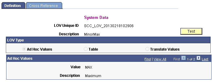

Access the Define List Of Values page (select Set up SACR, then select System Administration, then select Rules Engine, then select Setup, then select Define List of Values).
Image: Define List of Values – Ad Hoc Values page
This example illustrates the fields and controls on the Define List of Values – Ad Hoc Values page. You can find definitions for the fields and controls later on this page.
Select LOV Type Ad Hoc Values if you want to prompt on a user-defined Value or List of Values that is not related to a translate table or an existing prompt table.

LOV Type – Ad Hoc Values selected
Create an LOV of Ad Hoc Values if you want to prompt on a user-defined value or List of Values that is not related to a translate table or an existing prompt table.
LOV Unique ID – Copy Ad Hoc Values From grid
Select an LOV to copy by using the Search icon to find an existing LOV Unique ID. Then add custom values in the Ad Hoc Values grid.
Value – Copy Ad Hoc Values grid
Enter an Ad Hoc Value from which you would like to copy existing Ad Hoc values.
Description – Copy Ad Hoc Values grid
Enter a Description for the Ad Hoc Value.
Test

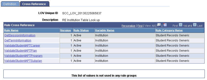

Click the Test button to display a preview of the values that will be returned by the LOV when it is deployed as a prompt edit.

Defining Lists of Values – Translate Values
Access the Define List Of Values page (select Set up SACR, then select System Administration, then select Rules Engine, then select Setup, then select Define List of Values and select the Translate Values radio button.
Create an LOV of type Translate Values if you want to prompt on an existing Campus Solutions Translate Value.
Image: Define List of Values – Translate Values
This example illustrates the fields and controls on the Define List of Values – Translate Values. You can find definitions for the fields and controls later on this page.
Select an LOV Type of Translate Values if you want to prompt on an existing Campus Solutions Translate Values.
Field or Control
Definition
LOV Unique ID
Displays a unique ID generated by the system. When adding a new value the default value is NOID. The unique ID is generated when the LOV is saved. The unique ID is created by combining prefix SCC_LOV_ with the system date and time stamp in format YYYYMMDDHHMMSS.
Description
Enter a LOV Description. The LOV Description is used when searching for a LOV and for display.
Field
Enter the Record where the prompt is found.
Translate Usage
Select the Translate Usage to be returned:
  • Use Long Description
  • Use Short Description
Exclude Prompt Field Values
  • Insert All Values – Click button to add all LOV values to the excluded values list.
  • Remove All Values – Click button to remove all LOV values from the excluded values list.
Test
Click the Test button to display a preview of the values that will be returned by the LOV when it is deployed as a prompt edit. The Test functionality uses the Exclude Prompt Field Values and Prompt Table Filter settings.
Access the Define List of Values Cross Reference page (select Set up SACR, then select System Administration, then select Rules Engine, then select Setup, then select Define List of Values, then select Cross Reference).
Image: Define List of Values Cross Reference
This example illustrates the fields and controls on the Define List of Values Cross Reference. You can find definitions for the fields and controls later on this page.
Field or Control
Definition
Displays to authorized users a link for either of these Rules Engine objects which uses a variable with this List of Values. If a user is not authorized, the link is disabled.
If no objects use the List of Values, a notification is shown in place of the object details. for example, “This List of Values is not used by any Rule Groups”.
Version
Variable Name
Displays the name of the Variable that uses this List of Values.
Rule Category Name

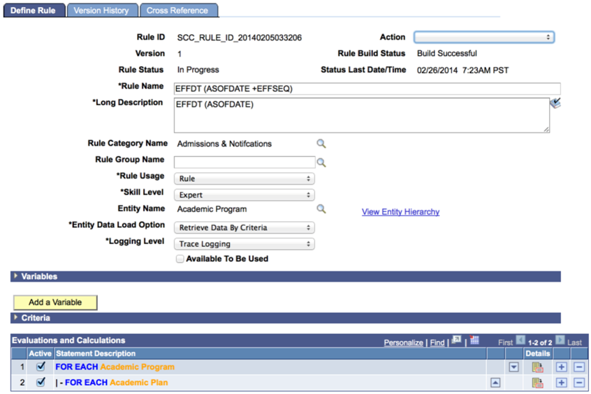

Image: Example of Define Rule Page Using a LOV from Field Record Prompts
This example illustrates the Define Rule page using a LOV from Field Record Prompts.
In this example in the Criteria grid, the Type of the Property with theLabel of EmplID is set to Text. Click the Search prompt button to the right of the Object (value) for Property EMPLID to open a Lookup table. This is the PEOPLE_SRCH Prompt for table. This functionality also works whenever a Property with a Lookup table is used in combination with the Assign or IF Evaluative statements. The same Search values are available and, if relevant, permission level security is enforced:

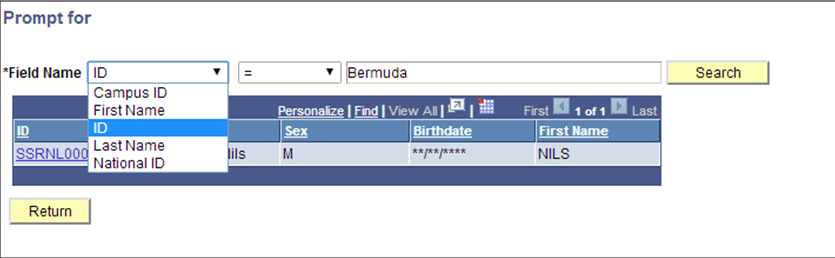

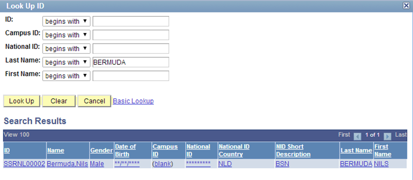

Image: Prompt Window for Example Of Define Rule Page Using A LOV From Field Record Prompts
This example illustrates the Prompt Window for Example Of Define Rule Page Using A LOV From Field Record Prompts.
The Search function behaves the same as if prompted from a normal search record or component:

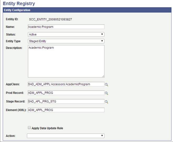

The Lookup functionality for EmplID Property is enabled by the Entity Registry. To view the Entity Prompts, access the Entity Registry page (select Set Up SACR, then select System Administration, then select Entity, then select Entity Registry).
Image: Entity Registry Window for Example of Define Rule Page Using a LOV from Field Record Prompts
This example illustrates the Entity Registry Window for Example of Define Rule Page Using a LOV from Field Record Prompts

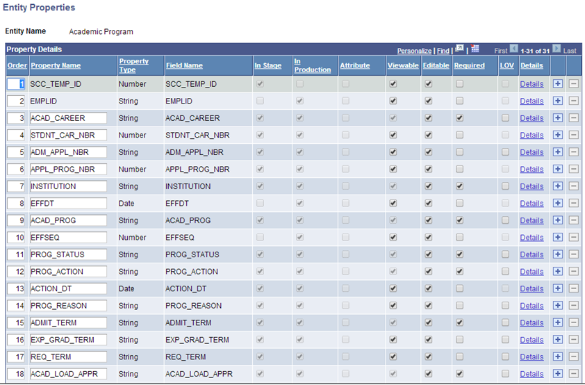

Select Edit Properties from the Action drop-down to view the Entity properties:
Image: Entity Properties Window for Example Of Define Rule Page Using a LOV from Field Record Prompts
This example illustrates Entity Properties Window for Example Of Define Rule Page Using a LOV from Field Record Prompts.
Entity Properties Window for Example of Define Rule Page Using a LOV from Field Record Prompts

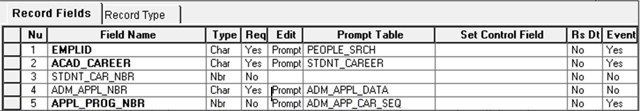

Prompt values present in a production record or staging record of an Entity are added to the Entity Registry automatically. Any Property which has inherited a Prompt from a production or staging record is displayed as view-only in the LOV column of the Entity Properties page. In this example the field EMPLID has inherited a prompt to the PEOPLE_SRCH table from the ADM_APPL_PROG production record:
Image: Property and Prompt Table for Example of Define Rule Page Using a LOV from Field Record Prompts
This illustrates the Property and Prompt Table for Example of Define Rule Page Using a LOV from Field Record Prompts
When the Academic Program Entity is used to build Rules in the Rules Engine Manager, the prompt to PEOPLE_SRCH becomes active. These prompts cannot be removed; however, they can be overridden by adding a new LOV Lookup Table value to the Property.

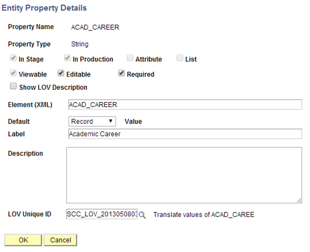

For an example of a LOV Look Up Table that is NOT present on the production or staging record and has been added to an Entity Property, select the Details link for property ACAD_CAREER in the Entity Properties page example. This opens the Entity Properties Detail page where an LOV Lookup Table can be added using the LOV Unique ID field for a relevant LOV:
Image: Entity Property Details Window for Example of Define Rule Page Using a LOV from Field Record Prompts
This illustrates the Entity Property Details Window for Example of Define Rule Page Using a LOV from Field Record Prompts.
Entity Property Details Window for Example of Define Rule Page Using a LOV From Field Record Prompts
