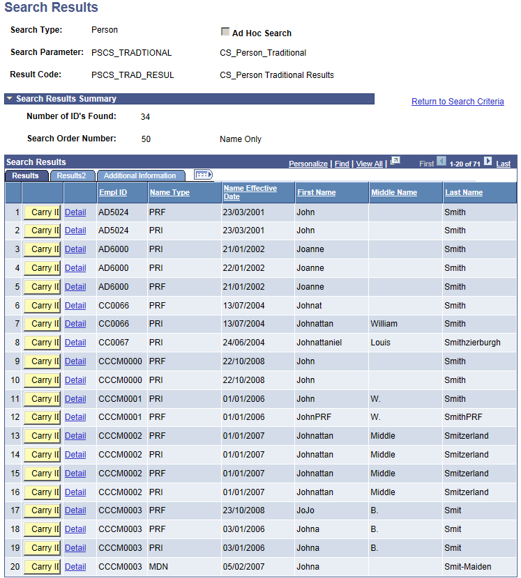

Many fields on this page are the same as those on the Search Results page. However, there are some important distinctions:
  • Records with no EmplIDs appear first in the Search Results group box.
  • Records with no EmplIDs are assigned an External Sys ID.
  • Records with no EmplIDs, that are importing EmplIDs from an external system, are assigned an External Sys ID and display the External Employee ID.
  • Where an EmplID exists, the Detail link leads to a page where you can view details of the ID record from the CS system.
  • Where no EmplID exists, the Detail link leads to a page where you can view details of the data from the external system.
  • The Import button appears when a person meets the criteria in the external system.
  • The Score % and Universal ID columns appear based on settings defined on the External System Search Match Options page.
  • Masking configuration is in effect for all matching constituents, even those with no EmplID.
  • For matching constituent records found by External Search/Match, this page displays information that is not necessarily stored inside the external system (for example, Aid Year).

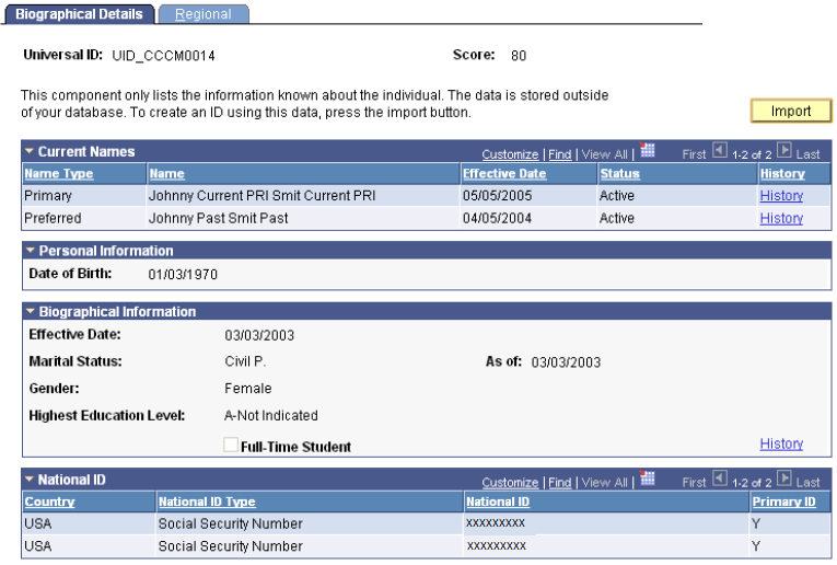

Access the Biographic Details page (click the Detail link on the Integrated Search Results page).
Image: Biographical Details page (1 of 2)
This example illustrates the fields and controls on the Biographical Details page (1 of 2). You can find definitions for the fields and controls later on this page.
Image: Biographical Details page (2 of 2)
This example illustrates the fields and controls on the Biographical Details page (2 of 2). You can find definitions for the fields and controls later on this page.
This page displays sections of data that are not actually stored in the CS database until you click the Import button.
The system displays messages on this page based on the following conditions:
Note: Where no data exists, the system hides the fields and displays a message in the Missing Information group box.

Field or Control
Definition
Import
Click this button to import the Universal ID and all the information displayed into the CS system and create an EmplID.
Current Names
Field or Control
Definition
History
This link appears only if the Universal ID contains a past or future date in addition to the current row. Click the link to access the Name Type History page.

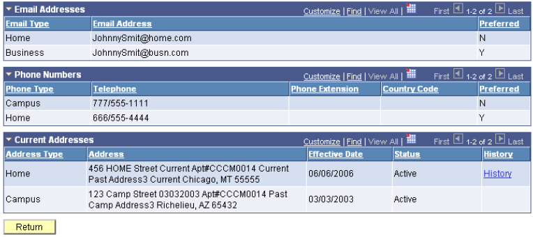

Current Addresses
Field or Control
Definition
History
This link appears only if the Universal ID contains a past or future date in addition to the current row. Click the link to access Address Type History page.

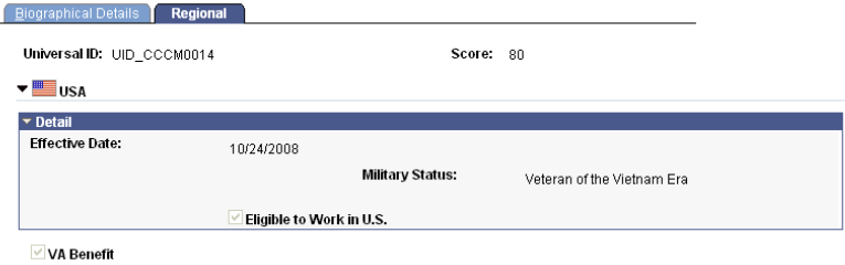

Access the Regional page (click the Detail link on the Integrated Search Results page, then Regional tab).
Image: Regional page
This example illustrates the fields and controls on the Regional page. You can find definitions for the fields and controls later on this page.
Regional page
This page is available only if it contains data. If the Fetch Response contains no Regional information, this message appears on the Missing Information group box on the Biographical Details page.
