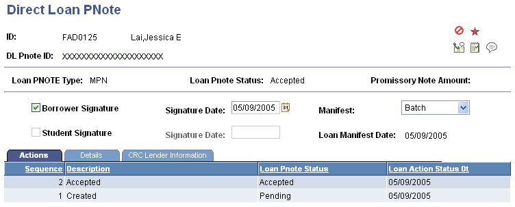

Actions Tab
Field or Control
Definition
Sequence
Displays the promissory note action sequence generated from the loan record activity. When multiple sequences exist for a promissory note, they display in reverse chronological order.
Description
Displays a description for the displayed action code.
Loan Pnote Status (loan promissory note status)
Displays the current status of the promissory note. Values are Accepted, Pending, and Rejected.
Loan Action Status Dt (loan action status date)
Indicates the date when the loan action status activity occurred.

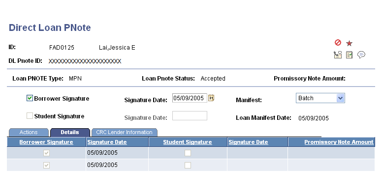

Details Tab
Select the Details tab.
Image: Direct Loan PNote page: Details tab
This example illustrates the fields and controls on the Direct Loan PNote page: Details tab. You can find definitions for the fields and controls later on this page.
Direct Loan PNote (Promissory Note) page: Details tab
Field or Control
Definition
Borrower Signature
Indicates whether the borrower has signed the promissory note.
Signature Date
Displays the date that the Borrower Signature check box was selected, or the actual date the borrower signed the promissory note if you edited the signature date.
Student Signature
This field is unavailable with PLUS loans when the borrower is not the student.
Signature Date
Displays the date that the Student Signature check box is selected, or the actual date the student signed the promissory note if you edited the signature date.
Promissory Note Amount
Displays the amount printed on the promissory note.

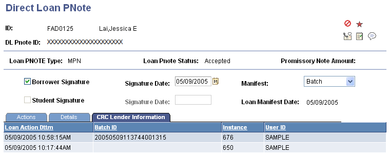

CRC Lender Information Tab
Select the CRC Lender Information tab.
Image: Direct Loan PNote page: CRC Lender Information tab
This example illustrates the fields and controls on the Direct Loan PNote page: CRC Lender Information tab. You can find definitions for the fields and controls later on this page.
Direct Loan PNote (Promissory Note) page: CRC (Common Record CommonLine) Lender Information tab
Field or Control
Definition
Loan Action Dttm (loan action date and time)
Displays the date and time the loan promissory note status was posted.
Batch ID
Displays the direct lending batch ID.
Instance
Displays the number that the system assigns incrementally to count the occurrences of the processes you run. You can use this number to select the particular instance of the process for which you want to view the process results.
User ID
Displays the ID of the person who ran the process.
