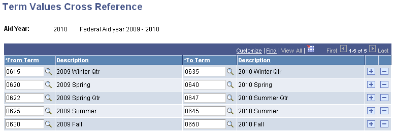

Term Values Cross Reference
TERM_VALUES_XREF
select Set Up SACR, then select Product Related, then select Financial Aid, then select Aid Year, then select Term Values Cross Reference
Set up term value cross-reference to process all rollover options except for General Aid Year and Aggregate Aid Limits.
Aid Year Setup
RUNCTL_AID_YEAR
select Set Up SACR, then select Product Related, then select Financial Aid, then select Aid Year, then select Aid Year Setup
Create aid-year—specific setup tables from year to year.
Access the Term Values Cross Reference page select (Set Up SACR, then select Product Related, then select Financial Aid, then select Aid Year, then select Term Values Cross Reference).
Image: Term Values Cross Reference page
This example illustrates the fields and controls on the Term Values Cross Reference page. You can find definitions for the fields and controls later on this page.
Set up the Term Values Cross Reference page to process all options except General Aid Year and Aggregate Aid Limits. Confirm that your records department has set up term values for the target aid year being created and has also associated each term with the appropriate career in the Term/Session table. Term values that are set up in Cross Reference that do not exist in Student Records are not created for the tables being processed. Verify term setup in Student Records before you set up your Term Values Cross Reference.
Field or Control
Definition
From Term
Enter the terms from your source year.
To Term
Enter the terms to be created by associating them with the appropriate From Term value.
