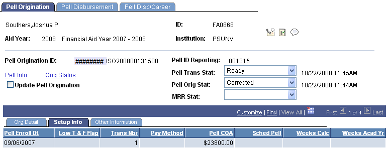

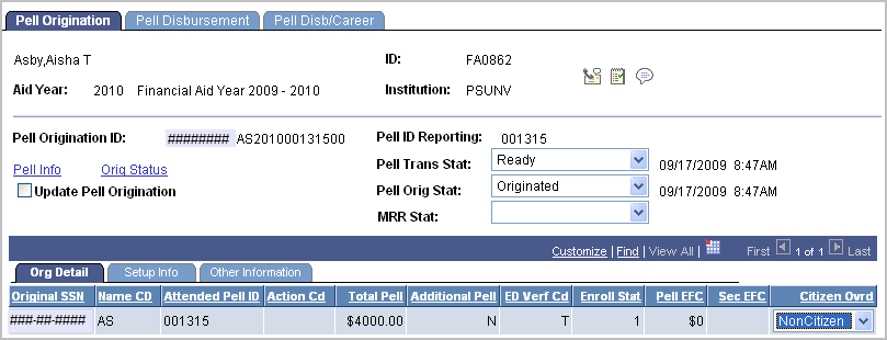

Access the Pell Origination page ().
Image: Pell Origination page, Org Detail tab
This example illustrates the fields and controls on the Pell Origination page, Org Detail tab. You can find definitions for the fields and controls later on this page.

Org Detail
Field or Control |
Definition |
| Original SSN (original social security number) |
Displays the student's social security number from the original Free Application for Federal Student Aid (FAFSA). |
| Name CD (name code) |
Displays the student's name code from the original FAFSA. If the social security number and name code do not match the origination ID, the system rejects the record. |
| Attended Pell ID |
Displays the Pell ID of the campus that the student is attending. |
| Action Cd (Action Code) |
Displays a code to indicate the status of an acknowledgment record. Values are: A: Accepted—all fields accepted. C: Corrected—one or more fields corrected. D: Duplicate. E: Rejected—record was rejected. |
| Total Pell |
Displays the student's total award amount for the school year. |
| Additional Pell |
Displays the additional eligibility indicator. The Common Origination and Disbursement process reports additional eligibility as a result of a second Pell (Pell2) item type. Values are: N: No additional Pell eligibility Y: Additional Pell eligibility |
| ED Verf Cd (education verification code) |
Displays the verification status of the applicant's data. Values are: A: Accurate C: Calculated T: Tolerance R: Reprocessed V: Verified W: Without documentation S: Selected but not verified Blank. Note: When the system builds origination, it builds the value defined on the student aid attribute record or Packaging Status Summary. When you outbound the data, the system sets the value to that required by the technical reference record layout. The system sets the values V, W, S, or Blank. |
| Enroll Stat (enrollment status) |
Not required to be reported. Displays the code that applies to the student's expected enrollment status for the award year. Values are: 1: Full-time 2: Three-quarter-time 3: Half-time 4: Less than half-time 5: Other |
| Pell EFC (Pell expected family contribution) |
Not required to be reported. Displays the student's EFC from the Institutional Student Information Record (ISIR) or Student Aid Report (SAR). |
| Sec EFC (secondary expected family contribution) |
Displays a code to indicate which expected family contribution value is used to determine the award amount. Values are: 0: Pell award was reported previously based on the secondary EFC. Award is now based on the original EFC. S: The Pell Grant award is based on the secondary EFC. |
| Citizen Ovrd (citizenship override) |
Select to report a local override of the student's citizenship status. This field is display only when the record is transmitted, corrected, or acknowledged or when a Multiple Reporting Record file is loaded. Valid values are Ineligible, NonCitizen and, US Citizen. |
Setup Info
Select the Setup Info tab.
Image: Pell Origination page: Setup Info tab
This example illustrates the fields and controls on the Pell Origination page: Setup Info tab. You can find definitions for the fields and controls later on this page.
Field or Control |
Definition |
| Pell Enroll Dt (Pell enrollment date) |
Displays the first date on which the student was enrolled in an eligible program for the designated school year. |
| Low T&F Flag (low tuition and fees flag) |
The system uses this field to identify tuition ranges when the annual tuition falls into the low tuition category as mandated by the Department of Education for each award year. Values are: (none), O, Range 1, Range 2, Range 3, and Range 4. |
| Trans Nbr (transaction number) |
Displays the transaction number from an eligible ISIR or SAR used to calculate the award. |
| Pay Method |
Not required to be reported. Displays the payment method formula. |
| Pell COA (Pell cost of attendance) |
Displays the cost of attendance used to calculate the Pell award amount. It must equal the COA calculated by the institution following the Pell Grant payment regulations. |
| Sched Pell (schedule Pell) |
Displays the maximum amount of the Pell award for which a student is eligible based on full-time enrollment. The student cannot exceed the scheduled Pell award amount. |
| Weeks Calc (weeks calculated) |
Not required to be reported. Displays the number of weeks of instructional time in which the student is enrolled and paid, as part of the academic year or program as defined for each payment methodology. |
| Weeks Acad Yr (weeks academic year) |
Not required to be reported. Displays the number of weeks of instructional time in the program's academic year. |

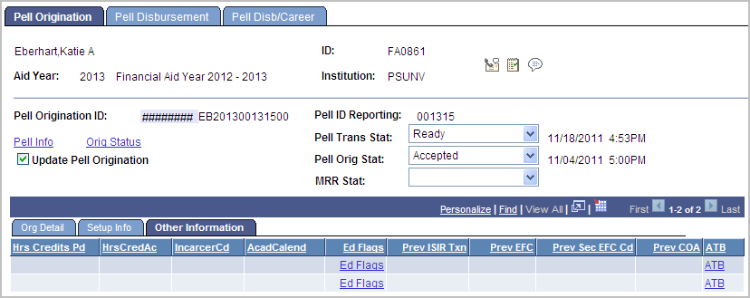

Other Information
Select the Other Information tab.
Image: Pell Origination page: Other Information tab
This example illustrates the fields and controls on the Pell Origination page: Other Information tab. You can find definitions for the fields and controls later on this page.
Field or Control |
Definition |
| Hrs Credits Pd (hours credits paid) |
Not required to be reported. Displays the number of credit or clock hours that the student is expected to complete and receive payment. |
| HrsCredAc (hours credit accepted) |
Not required to be reported. Displays the number of accepted credit hours. |
| IncarcerCD (incarcerated code) |
Displays one of these values: N: No longer incarcerated Y: Incarcerated (blank): Not incarcerated. |
| AcadCalend (academic calendar) |
Not required to be reported. Indicates the calendar that applies to the student's educational program and determines which payment methodology is accepted. Credit hours with standard terms of quarters or credit hours with standard terms of semesters or trimesters are examples of academic calendars. |
| Ed Flags (education flags) |
The system activates this link when a record is inbound. Click to view the education use flags from the inbound record. These are set to inform you of modifications that were made to your database. Education use flags are also activated when the record is rejected, and they require immediate action. |
| Prev ISIR Txn (previous institutional student information record transaction) |
Displays the previous ISIR transaction, if a change has been made. |
| Prev EFC (previous expected family contribution) |
Displays the previous expected family contribution, if a change has been made. |
| Prev Sec EFC Cd (previous secondary expected family contribution code) |
Displays the previous secondary expected family contribution. |
| Prev COA (previous cost of attendance) |
Displays the previous cost of attendance based on a change to the student's cost of attendance. |
| ATB (ability to benefit) |
Displays a link to Ability to Benefit information if present. Click the link to view Ability to Benefit data. |
