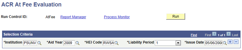

Access the ACR At Fee Evaluation page (select Financial Aid, then select Student Loans Company, then select ACR At Fee Evaluation, then select ACR At Fee Evaluation).
Image: ACR At Fee Evaluation page
This example illustrates the fields and controls on the ACR At Fee Evaluation page. You can find definitions for the fields and controls later on this page.
Field or Control
Definition
Liability Period
Select a Liability Period. You can run this process for multiple Liability Periods with the same Issue Date.
Issue Date
Enter the issue date of the ACR file that you want to evaluate.
