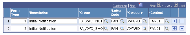

Access the FE Award Notification Form Types page (select Set Up SACR, then select Product Related, then select Financial Aid, then select Forms Engine Notification, then select Define Notification Form Types, then select FE Award Notification Form Types).
Image: FE Award Notification Form Types page
This example illustrates the fields and controls on the FE Award Notification Form Types page. You can find definitions for the fields and controls later on this page.
FE (forms engine) Award Notification Form Types page
Field or Control
Definition
Form Type
Identifies the form type for this award notification.
Description
Describes the delivered form type. Form Type 1 is the initial notification of financial aid. Form Type 2 is shorter version of the initial notification.
Group
Identifies in which group of letters this letter code exists.
Letter Code
The code from the Campus Community Standard Letters page for this communication. You can define the letter code for the FE FAN process.
Category
The communications category associated with this letter code. You can define the category for the FE FAN process.
Context
The context from the Campus Community Communications Context page that is included in this category. You can define the context for the FE FAN process

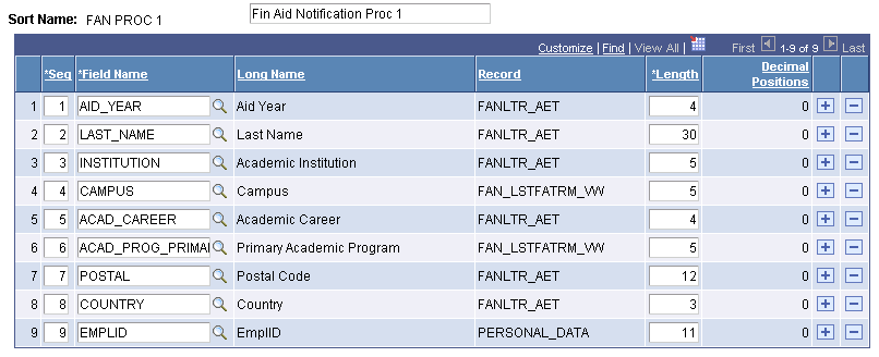

You can sort the data by field to control the order in which the output documents generated by a batch print process appears. Two sort sequences are delivered with the system. FAN PROC 1 displays information by Record, Field Name, Length and Long Name. FAN PROC 2 displays information by Field Name, Long Name, Record, and Length. You must set up any other sort sequences for your institution.
Access the Sort Order Names page (select Set Up SACR, then select Product Related, then select Financial Aid, then select Forms Engine Notification, then select Define Sort Order Names, then select Sort Order Names).
Image: Sort Order Names page
This example illustrates the fields and controls on the Sort Order Names page. You can find definitions for the fields and controls later on this page.
Field or Control
Definition
Sort Name
The name of the sort sequence.
Seq (sequence)
The hierarchy of how you want data to sort. Use a Zip Code sort to obtain information in the order to use for a bulk mailing.
Field Name
The name of the field.
Length
The character length of the previous field.
Field Long Name
The full name of the field displayed.
Decimal Positions
Displays how many positions appear after the decimal point if this is a numeric field.

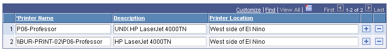

Access the Printer Name page (select Set Up SACR, then select Product Related, then select Financial Aid, then select Forms Engine Notification, then select Define Printer Names).
Image: Printer Name page
This example illustrates the fields and controls on the Printer Name page. You can find definitions for the fields and controls later on this page.
Printer Name page
Field or Control
Definition
Printer Name
Enter the printer name and location of the path.
Description
Enter the description of the printer.
Printer Location
Enter the printer location.

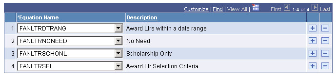

Access the FE Award Notif Select. Eqtns page (select Set Up SACR, then select Product Related, then select Financial Aid, then select Forms Engine Notification, then select Define Selection Equations).
Note: You must create equations using the Equation Engine prior to setting up the FE Award Notif Select. Eqtns page. See Equation Engine documentation for more information on setting up and using the Equation Engine.
Image: FE Award Notif Select. Eqtns page
This example illustrates the fields and controls on the FE Award Notif Select. Eqtns page. You can find definitions for the fields and controls later on this page.
forms engine Award notification selection equations page
Field or Control
Definition
Equation Name
Select the name of the equation.
Description
The description of the equation.

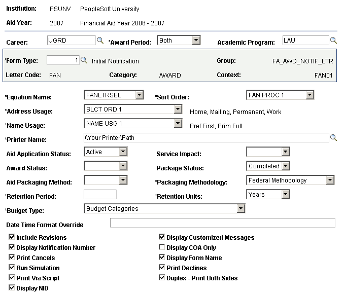

Access the FE Award Notification Defaults page (select Financial Aid, then select Awards, then select Notification Letter, then select Award Notification Defaults).
Note: This page is designed to define the initial setup for the One-Up Print Process and Batch Print Run Controls.
Image: FE Award Notification Defaults page
This example illustrates the fields and controls on the FE Award Notification Defaults page. You can find definitions for the fields and controls later on this page.
FE (forms engine) Award Notification Defaults page
Field or Control
Definition
Career
Define the options for financial aid processing. Examples of standard career options are undergraduate or graduate.
Award Period
The award period that is used in packaging. Values include: Academic, Non-Standard, and Both.
Academic Program
Academic program values that are used for financial aid processing.
Form Type
Define and create the values using the Forms Engine. Initial Notification 1 and Initial Notification 2 (Short FAN) are delivered with the system.
Group
Define this in the Setting Up the Forms Engine. It identifies the Form Type to a specific processing group.
Letter code
The code for the letter associated with this communication. You define this on the FE Award Notification Form Type page.
Category
The communications category associated with this letter code. You define this on the FE Award Notification Form Type page.
Context
The context from the Campus Community Communications Context page that is included in this category. You define this on the FE Award Notification Form Type page.
Equation Name
Define this using the Equation Engine. FANLTRSEL (Award Letter Selection Criteria), FANLTRDTRANG (Award Letters within a Date Range), FANLTRNONEED (Students with No Need) are delivered with the system.
Note: There is a change to the logic behind the FAN letter selection criteria. If you indicate in any of the run controls that cancelled and declined awards should print, the new version of the FANLTRSEL equation excludes letters for students who only have cancelled and declined awards.
Sort Order
Defined using the Sort Order Set Up. Sorts FE FAN output by sorting preferences.
Address Usage
Defined using the Process Demo Set Up. Allows you to override Address Usage options.
Name Usage
Defined using the Process Demo Set Up. Allows you to override Name Usage options.
Printer Name
Defined using the Printer Names Set Up. Allows you to select defined printer.
Aid Application Status
The values are based on Packaging Status Summary. Initially set to Active.
Service Impact
Determines whether or not to print a notification based on service impacts.
Award Status
Values are based on the Packaging Award Status field. Initially select Accepted or Offered.
Package Status
Values are based on the Aid Packaging Status field on the Packaging Status Summary page. You should set this option to Completed and never to Repackage.
Aid Packaging Method
Values are based on how aid packages were created. Values are Blank, Auto, Counselor, and Not Packaged. Initially select Blank to ensure that the program evaluates all options.
Packaging Methodology
Values are Federal Methodology and Institutional Methodology.
Retention Period
Indicates the length of time that Forms Engine keeps historical data.
Retention Units
Indicates the unit used in Retention Period. Use Years as the unit to facilitate audit requirements.
Budget Type
Values are Budget Categories (Institutional) and Pell Categories.
Date Time Format Override
(Optional) As a default, the FE FAN prints the date and time format defined for message catalog entry (138,1), which displays throughout the system. For example, if the message catalog entry is set as dd:MMMM:yyyy, which defines a system date-only format, and you need to display a date and 24-hour format for FE FAN only, enter dd:MMMM:yyyy:HH:mm:ss. For more information on defining date and time formats, see the explanation field for the Message Catalog Entry (138,1) in PeopleTools: System and Server Administration, "Using PeopleTools Utilities."
Include Revisions
Select to include revisions made to aid packages in the print job.
Display Notification Number
Select to print the number on the aid notification.
Print Cancels
Select to print the information if an award is cancelled.
Run Simulation
Select to run this print job in simulation mode.
Print Via Script
Select to allow for multi-platform printing.
Display NID
Select to display the student's National ID.
Display Customized Messages
Select to display customized, on demand user-defined messages from the FE Award Notification Student Defaults page Comment Box.
Display COA Only
Select to display the Cost Of Attendance/Budget information on the Aid Notification. The system does not display the resource information on the printed aid notification if you select this option.
Display Form Name
Select to display the name of the form on the printed aid notification.
Print Declines
Select to print the information if a student declines an award.
Duplex - Print Both Sides
Select to allow printing of both sides of a page.
