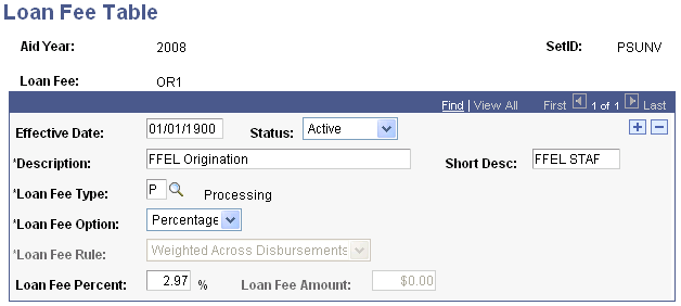

Access the Loan Fee Table page (select Set up SACR, then select Product Related, then select Financial Aid, then select Awards, then select Loan Fee Setup, then select Loan Fee Table).
Image: Loan Fee Table page
This example illustrates the fields and controls on the Loan Fee Table page. You can find definitions for the fields and controls later on this page.
Loan Fee Table page
Field or Control
Definition
Loan Fee Type
Select the value that indicates the purpose of the loan fee. Be sure to select R—Rebate if the loan fee is an interest rebate, used for the Direct Loan interest rebate.
Note: Any Direct Loan with a zero rebate, must still have a Loan Fee Type attribute defined on the Financial Aid Item Type setup. Once a Direct Loan record is created and based on the Financial Aid Item Type, the appropriate XML Interest Rebate tag is reported to COD.
Loan Fee Option
Select the value that indicates how the amount of the loan fee is determined.
Flat: The loan fee is a flat amount. If you select this value, you must select a Loan Fee Rule and enter the loan fee amount.
Percentage: The amount of the loan fee is a percentage of the student's award amount. If you select this value, you must indicate the percentage in the Loan Fee Percent field.
Loan Fee Rule
This field is available only if you select Flat in the Loan Fee Option field. The loan fee rule determines how the Packaging process distributes the loan fee amount among disbursements.
All in 1st Disbursement: The entire loan fee amount is subtracted from the first disbursement.
Weighted Across Disbursements: The loan fee amount is split among the disbursements according to the disbursement split code percentages.
Loan fee options and loan fee rules are delivered with the system as translate values that cannot be modified in any way. The Packaging process bases certain calculations on these values and changing them would have unforeseen consequences.
Loan Fee Percent
This field is available only if you select Percentage in the Loan Fee Option field. The loan fee amount is this percentage of the total award amount.
Loan Fee Amount
This field is available only if you select Flat in the Loan Fee Option field. Enter the total loan fee amount.
