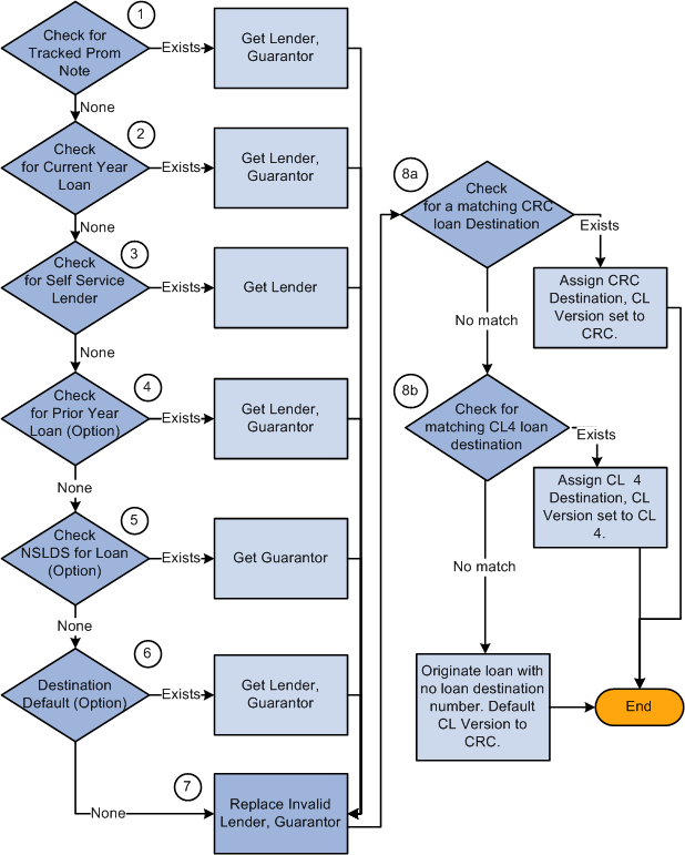

Because CommonLine 4 process levels only require a guarantor to originate a loan, the loan destination that you use to originate the loan might not be the same loan destination that you use to guarantee the loan.
Loan origination follows a seven-step process to determine the lender and guarantor and then determine the loan destination. You determine which steps to follow when you set destination defaults.
Step
What Happens
Possible Information Selected
1
If an active, unused promissory note is tracked, the process selects the designated lender and guarantor from the form used for origination. The process skips steps 2 through 6.
Lender only
Guarantor only
Lender and guarantor
No information
2
If a matching loan is originated and guaranteed in the current aid year for the borrower, the system uses lender and guarantor from the earlier origination record, and the process skips steps 4 through 6.
No information
3
If the student has entered a lender from the self-service lender selection pages, the process uses the selected lender and skips steps 4 through 6.
Lender
No information
4
The origination process searches back one year for a prior year originated loan of the same loan type; if a prior loan is found, the process skips steps 5 and 6.
No information
5
The origination process searches the current NSLDS history to find a previously originated loan of the same loan type. A new NSLDS loan type cross reference section is available in the Loan Type Table component to facilitate this step. If a prior loan is found, the process skips step 6.
Note: Only the guarantor is used from the NSLDS loan history.
Guarantor only
No information
7
The process assigns a default destination
Lender only
Guarantor only
No information
6
The process checks the validity of the selected lender and guarantor values and reassigns lender and guarantor IDs as defined in the Agency Default page.
Lender only
Guarantor only
No information
8
Based on the lender and guarantor information selected in the prior steps, the loan origination process searches for a matching loan destination profile record. If one is not found, the loan is still originated, but it cannot be transmitted until a loan destination is assigned.
Loan destination
No destination
The following chart illustrates the process:
Image: Process flow to determine loan destination

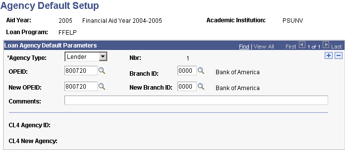

Access the Agency Default Setup page (select Set Up SACR, then select Product Related, then select Financial Aid, then select Loans, then select Reassign Loan Agencies, then select Agency Default Setup).
Image: Agency Default Setup page
This example illustrates the fields and controls on the Agency Default Setup page. You can find definitions for the fields and controls later on this page.
Field or Control
Definition
Agency Type
Select from: Guar/Ins (guarantor/insurer), Lender, and Servicer.
OPEID (office of postsecondary education identifier)
Select the office of postsecondary education identifier.
To assign a default loan agency, leave this field blank.
New OPEID
Enter the agency to replace the previous agency, or the default agency if you left the OPEID field blank.
Note: The source of values for the OPEID and New OPEID field are defined in the Create CRC Loan Participant component.
CL4 Agency ID
Displays the ID and agency name.
CL4 New Agency
Displays the ID and name for the new agency.

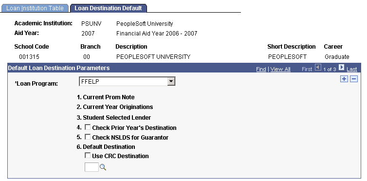

Access the Loan Destination Default page (select Set Up SACR, then select Product Related, then select Financial Aid, then select Loans, then select Define Loan Institutions, then select Loan Destination Default).
Image: Loan Destination Default page
This example illustrates the fields and controls on the Loan Destination Default page. You can find definitions for the fields and controls later on this page.
The order in which the system chooses the loan destination for the student is as follows: Current Promissory Note, Current Year Originations, Check Prior Year Originations, Check NSLDS for Guarantor, Default Destination.
Field or Control
Definition
Loan Program
Select from Alternative, Direct, FFELP, Health, Perkins, State, or University.
Current Prom Note (current promissory note), Current Year Originations, and Student Selected Lender
The loan origination process always performs these steps.
Check Prior Year's Origination and Check NSLDS for Guarantor
Select to have the system perform these steps.
Default Destination
If nothing results from the first four search methods, the system uses this default destination. The field allows you to select from the CommonLine 4 loan destination profile numbers. Select the Use CRC Destination (common record commonline destination) check box to allow the selection of CRC loan destination profile numbers.
Use CRC Destination
Select to use CRC destination. This controls the dynamic prompting of either CL4 or CRC loan destinations in the edit box on the page.
  • If you select the check box and the loan destination (CL4 or CRC) cannot be determined when a loan is originated, a CL version of CRC is used.
  • If you clear the check box and the loan destination (CL4 or CRC) cannot be determined when a loan is originated, a CL version of CL4 is used.
Note that a default loan destination number is not required to activate this behavior. The current rule used by the origination process to determine the CL version and loan destination number has not been changed.
