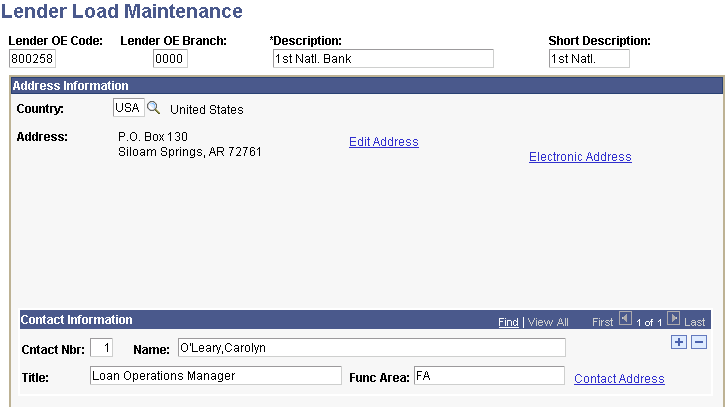

Access the Lender Load Maintenance page (select Set Up SACR, then select Product Related, then select Financial Aid, then select Loans, then select CommonLine 4, then select Maintain Lender Codes, then select Lender Load Maintenance).
Image: Lender Load Maintenance page
This example illustrates the fields and controls on the Lender Load Maintenance page. You can find definitions for the fields and controls later on this page.
Field or Control
Definition
Edit Address
Click to edit or update an address.
Electronic Address
Click to edit or update an electronic address.
Contact Address
Click to edit or update a contact address.

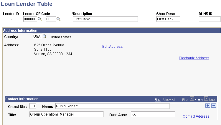

Access the Loan Lender Table page (select Set Up SACR, then select Product Related, then select Financial Aid, then select Loans, then select CommonLine 4, then select Define School Lenders, then select Loan Lender Table).
Image: Loan Lender Table page
This example illustrates the fields and controls on the Loan Lender Table page. You can find definitions for the fields and controls later on this page.
Field or Control
Definition
Lender ID
Displays the ID assigned by the system to the lender associated with the loan.
Lender OE Code (lender office of education code)
Select a lender office of education code. When you select a lender office of education code, the system uses data from the lender load maintenance database and automatically populates the rest of the information.
To add a lender to the Lender Load Maintenance table, complete the fields manually.

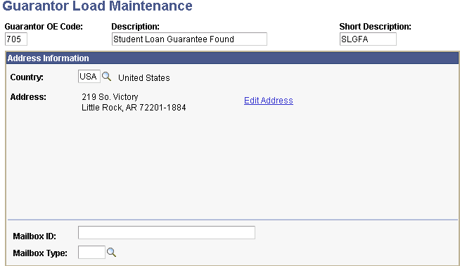

Access the Guarantor Load Maintenance page (select Set Up SACR, then select Product Related, then select Financial Aid, then select Loans, then select CommonLine 4, then select Maintain Guarantor Codes, then select Guarantor Load Maintenance).
Image: Guarantor Load Maintenance page
This example illustrates the fields and controls on the Guarantor Load Maintenance page. You can find definitions for the fields and controls later on this page.
Field or Control
Definition
Mailbox ID
Enter mailbox identification. The mailbox ID is the address where data files are sent when the files are transmitted using the internet or a private communication network.
Mailbox Type
Select an internet provider or communication network.

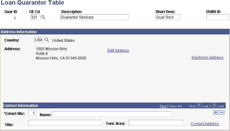

Access the Loan Guarantor Table page (select Set Up SACR, then select Product Related, then select Financial Aid, then select Loans, then select CommonLine 4, then select Define School Guarantors, then select Loan Guarantor Table).
Image: Loan Guarantor Table page
This example illustrates the fields and controls on the Loan Guarantor Table page. You can find definitions for the fields and controls later on this page.
To add new guarantors, you must first define them on the Guarantor Load Maintenance page.
Field or Control
Definition
Guar ID (guarantor identification)
Displays the number assigned by the system to identify the guarantor for loan processing. The system delivers the majority of guarantor codes.
OE Cd (office of education code)
Select an office of education code. When you select an office of education code, the system automatically populates the rest of the fields with information from the Guarantor Load Maintenance table.
Edit Address
Click to update or review address information.
Electronic Address
Click to update or review electronic address information.
Contact Address
Click to update or review contact address information.

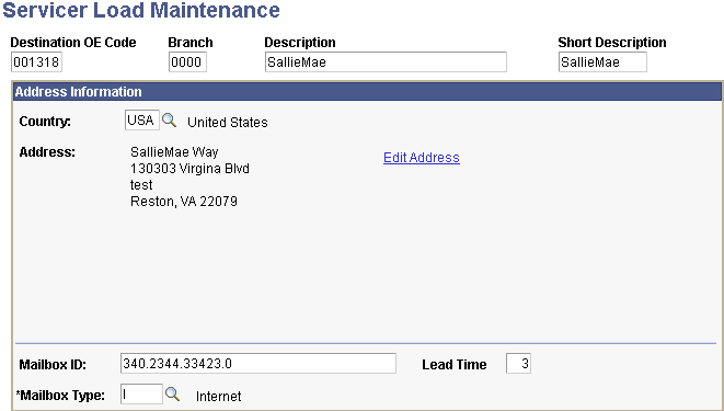

Access the Servicer Load Maintenance page (select Set Up SACR, then select Product Related, then select Financial Aid, then select Loans, then select CommonLine 4, then select Maintain Loan Servicer Codes, then select Servicer Loan Maintenance).
Image: Servicer Load Maintenance page
This example illustrates the fields and controls on the Servicer Load Maintenance page. You can find definitions for the fields and controls later on this page.
Field or Control
Definition
Destination OE Code (destination office of education code)
Lead Time
Enter the number of days prior to the first disbursement date that changes can still be made to the student's loan before the data is sent to the school. This is for information purposes only.
Edit Address

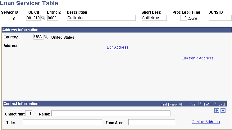

Access the Loan Servicer Table page (select Set Up SACR, then select Product Related, then select Financial Aid, then select Loans, then select CommonLine 4, then select Define School Servicers, then select Loan Servicer Table).
Image: Loan Servicer Table page
This example illustrates the fields and controls on the Loan Servicer Table page. You can find definitions for the fields and controls later on this page.
Field or Control
Definition
Servicer ID (servicer identification)
Displays the number used to identify the servicer associated with the requested loan.
Select an office of education code. When you select an office of education code, the system automatically populates the rest of the fields with information from the Servicer Load Maintenance table.
Proc Lead Time (process lead time)
Enter the number of days that a loan destination needs to freeze its data to prepare for a transfer to the school. For example, if the lead time is five days, changes can be made to the student's loan only five days prior to the first disbursement.
Edit Address
Electronic Address
Contact Address
To add a servicer that is not included on the Servicer Load Maintenance table, complete the fields manually.
