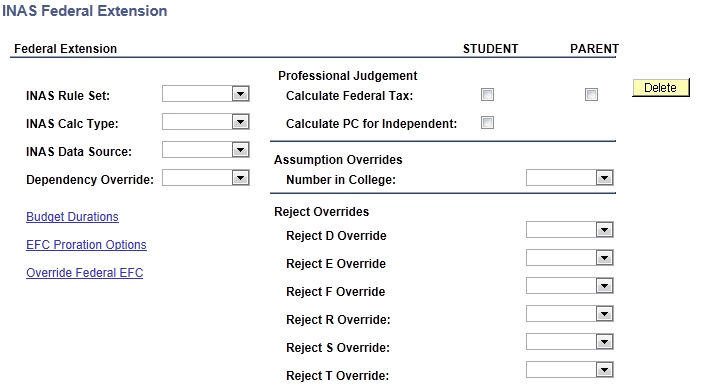

Access the INAS Federal Extension page (click the FM link on any tab of the Correct 20nn-20nn ISIR records component).
Image: INAS Federal Extension page
This example illustrates the fields and controls on the INAS Federal Extension page. You can find definitions for the fields and controls later on this page.
INAS (Institutional Need Analysis System) Federal Extension page
Federal
Field or Control
Definition
INAS Rule Set
Select a rule set.
INAS Calc Type (INAS calculation type)
Select a calculation type from FM, IM, or FM & IM.
INAS Data Source
Select FM, IM, or Both F/I.
Dependency Override
Select either Ind Prof J (individual professional judgement) or No (no override).
Budget Durations
Click this link to access the INAS Federal Extension Budget Durations page. You can enter any value for FM academic and/or non-standard budget duration. Federal rules allow whole numbers only for budget duration. If the total allocation for the budget duration is greater than 12 months, a 9–month EFC is calculated and used in the academic award period, and no EFC is calculated for the non-standard award period.
This field can be populated using Population Update as long as the records being updated are aid year activated for the intended aid year.
Override Federal EFC
See Overriding Expected Family Contribution (EFC).
Professional Judgement
Field or Control
Definition
Calculate Federal Tax
Select to calculate federal tax as defined by INAS.
Calc a PC for Independent (calculate a parent contribution for independent)
Select to calculate a parental contribution for independent students if parental data is available. The parental contribution is calculated but not added to the EFC.
Assumption Overrides
Field or Control
Definition
Number in College
Select one of the following:
Ovrd Asmpt (override assumption) to override the number in college assumption when calculating the parent contribution.
Don't Ovr (don't override) to accept the number in college assumption when calculating the parent contribution.
Reject Overrides
Field or Control
Definition
Reject D Override
Select Don't Supp (Do not suppress) to enforce Reject D.
Select Supp Rej D (suppress reject D) to override Reject D.
Reject E Override
Select Don't Supp (Do not suppress) to enforce Reject E.
Select Supp Rej E (suppress reject E) to override Reject E.
Reject F Override
Select Don't Supp (Do not suppress) to enforce Reject F.
Select Supp Rej F (suppress reject F) to override Reject F.
Reject R Override
Select Don't Supp (Do not suppress) to enforce Reject R.
Select Supp Rej R (suppress reject R) to override Reject R.
Reject S Override
Select Don't Supp (Do not suppress) to enforce Reject S.
Select: Supp Rej S (suppress reject S) to override Reject S.
Reject T Override
Select Don't Supp (Do not suppress) to enforce Reject T.
Select Supp Rej T (suppress reject T) to override Reject T.
See The College Board's INAS User Manual.

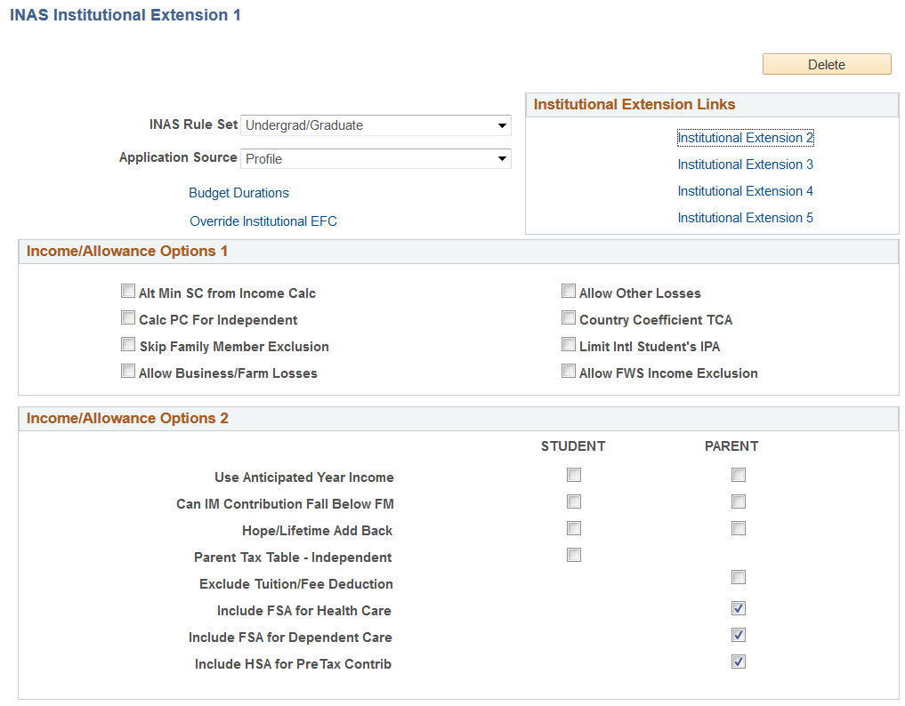

Access the INAS Institutional Extension 1 page (click the IM link on any tab of the Correct 20nn-20nn ISIR records component).
Image: INAS Institutional Extension 1 page
This example illustrates the fields and controls on the INAS Institutional Extension 1 page. You can find definitions for the fields and controls later on this page.
INAS (Institutional Need Analysis System) Institutional Extension 1 page
Use the INAS Institutional Extension 1 page to set your basic overrides. From this page, access other extension pages, budget duration or EFC overrides.
Field or Control
Definition
INAS Rule Set
Select an INAS rule set value to determine which global policy option rule to use as a base.
Application Source
Select an application source from:
FT CSL (full-time Canada Student Loan): Used in Canadian Need Analysis.
Inst App (institutional application).
PT CSL (part-time Canada Student Loan): Used in Canadian Need Analysis.
Profile.
Budget Durations
Click this link to access the Institutional Budget Durations page. You can enter any value for IM academic and/or non-standard budget duration. Institutional rules allow whole numbers with one decimal place.
Override Institutional EFC
Click this link to access the Override Institutional EFC page, where you can override the institutional EFC amount.
Alt Min SC from Income Calc (alternate minimum student contribution from income calculation)
Select this check box to override the Alt Min SCI option set for the student on the IM Yes/No Options page.
Calc PC For Independent (calculate parental contribution for independent)
Select this check box to override the Calc PC For Independent option set for the student on the IM Yes/No Options page.
Skip Family Member Exclusion
Select to override the Rstrct # Household - Max Age and Rstrct # in College - Max Age options set on the IM Tax/Assess & Parms options page.
Allow Business/Farm Losses
Select to override the Allow Parent Bus/Farm Loss option set on the IM Yes/No Options page.
Allow Other Losses
Select to override the Allow Parent Other Loss option set on the IM Yes/No Options page.
Country Coefficient TCA (country coefficient total contribution from assets)
Select to calculate an optional contribution from assets by applying the country coefficient to the percentage used to calculate the step increment
  • Selected
    Calculate contribution from assets applying the country coefficient to the step increment percentage.
  • Unselected
    Calculate contribution from assets for international student using default step increase percentage.
Note: This is a local-only option applicable to international (non-domestic) students only.
Limit Intl Student's IPA (limit international student's income protection allowance)
Select to limit an international student's Income Protection Allowance (IPA) to an amount greater than or equal to 25% of the parental income.
  • Selected
    Limit student's IPA to an amount not less than 25% of parents' income.
  • Unselected
    Do not limit student's IPA amount, normal processing.
Allow FWS Income Exclusion (allow federal workstudy income exclusion)
Select to exclude the student's work-study earnings from the income exclusion calculation. This option allows (includes) federal workstudy income back into regular income by excluding it from the income exclusion calculation.
  • Selected
    Include work-study earnings in regular income.
  • Unselected
    Do not include work-study earnings in regular income.
Use Anticipated Year Income
Select to override the Use Anticipated Year Income option set on the IM Yes/No Options page.
Can IM Contribution Fall Below FM
Select to override the IM < FM option set on the IM Yes/No Options page.
Hope/Lifetime Add Back
Select to override the Add Hope/LTL option set on the IM Yes/No Options page.
Parent Tax Table — Independent
Select to override the Ind Use Par St Tax Alwnc (independent use parent state tax allowance) option set on the IM Yes/No Options page.
Exclude Tuition/Fee Deduction
Select to override the Exclude Tuition/Fee Deduction option set on the IM Yes/No Options page.
Include FSA for Health Care(Include Flexible Spending Account for Health Care)
Select to add Flexible Spending Account for Health Care funds to total untaxed income.
If not selected, Flexible Spending Account for Health Care funds is excluded from total untaxed income.
Include FSA for Dependent Care
Select to add Flexible Spending Account for Dependent Care funds to total untaxed income.
If not selected, Flexible Spending Account for Dependent Care funds is excluded from total untaxed income.
Include HSA for PreTax Contrib
Select to add Health Saving Account funds to total untaxed income.
If not selected, Health Saving Account funds are excluded from total untaxed income.
See Maintaining Institutional Financial Aid Applications.
See the College Board's INAS User Manual.

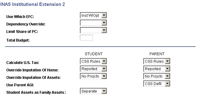

Access the INAS Institutional Extension 2 page (click the IM Extension 2 link on the INAS Institutional Extension 1 page).
Image: INAS Institutional Extension 2 page
This example illustrates the fields and controls on the INAS Institutional Extension 2 page. You can find definitions for the fields and controls later on this page.
INAS (Institutional Need Analysis System) Institutional Extension 2 page
Use the INAS Institutional Extension 2 page to override options used to determine the student's total budget.
Field or Control
Definition
Use Which EFC
Select a value to determine the institutional EFC displayed on the Need Summary page and used in the Award Entry component. Your selection overrides the value selected on the Global and Federal Options page.
Dependency Override
Select either Ind Prof J ( individual professional judgement) or No (no override). INAS calculates a dependent student as independent when Ind Prof J is selected.
Limit Share of PC
Select from Lowest, No, Ratio Bdg (ratio budget), or Sum of Bdg (sum of budget).
Your selection overrides the value selected on the Minimum PC Range page and the Budget Options page.
Calculate U.S. Tax
Select to override the value selected for the Fed Tax Allwnc Against Income field on the IM Tax/Assess & Parms page.
Override Imputation of Home
Select from Alt Calc, Highest, Proj/Diff, Projected, or Reported to override the value on the Home/Asset Projections page.
Override Imputation of Assets
Select Combined or No Projctn to override the value on the Asset Options page.
Use Parent AGI (use parent adjusted gross income)
Select a value to override the value selected for the Use Parent AGI field on the IM Tax/Assess & Parms page.
Select how the parent AGI is represented from:
CSS Deflt (CSS default)
Use Cmptd (use computed)
Use Rptd (use reported)
Use TaxRtrn (use tax return)
Student Assets as Family Assets (student assets as family assets)
Select a value to override the value selected for the Studnt Assets as Family Assets field on the IM Tax/Assess & Parms page.

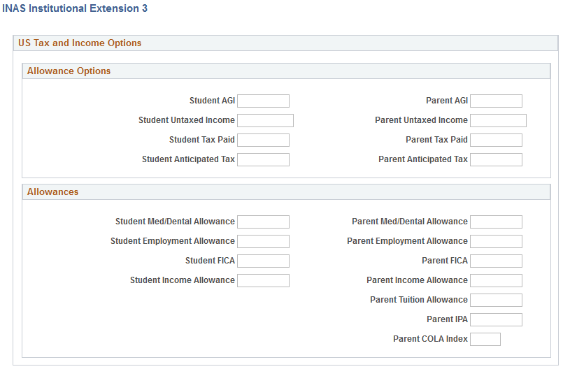

Access the INAS Institutional Extension 3 page (click the Extension 3 link on the INAS Institutional Extension 1 page).
Image: INAS Institutional Extension 3 page
This example illustrates the fields and controls on the INAS Institutional Extension 3 page. You can find definitions for the fields and controls later on this page.
INAS (Institutional Need Analysis System) Institutional Extension 3 page
Use the INAS Institutional Extension 3 page to override INAS global policy options for the given income, tax, and allowances.
Field or Control
Definition
Student/Parent AGI (student/parent adjusted gross income)
Enter an amount to override the student or parent adjusted gross income.
Student/Parent Untaxed Income
Enter an amount to override the student or parent untaxed income.
Student/Parent Tax Paid
Enter an amount to override the value used in the Fed Tax Allwnc Against Income (federal tax allowance against income) on the IM Tax/Assess & Parms page.
Student/Parent Anticipated Tax
Enter an amount to override the anticipated tax calculated by the IM method.
Allowances
Field or Control
Definition
Student/Parent Med//Dental Allowance (student/parent medical/dental allowance)
Enter an amount to override the % Unreimbursed Med/Dent Expense (percent unreimbursed medical/dental expense) on the IM Value Parms 1 page.
Student/Parent Employment Allowance
Enter an amount to override % Employment Allowance (percent employment allowance) and Max Employment Allowance (maximum employment allowance) on the IM Value Parms 1 page.
Student/Parent FICA (student/parent Federal Insurance Contributions Act)
Enter an amount to override the allowance calculated by IM.
Student/Parent Income Allowance
Enter an amount to override allowance against income calculated by IM.
Parent Tuition Allowance
Enter an amount to override the Max Tuition Allowance (maximum tuition allowance) per child on the IM Value Parms 1 page.
Parent IPA (parent income protection allowance)
Enter an amount to override the Adjust IPA/MMA Regional COL calculated based on options set on the IM Tax/Assess & Parms page.
Parent COLA Index (parent cost of living allowance index )
Enter an amount to override the Adjust IPA/MMA Regional COL (Income Protection Allowance/Monthly Maintenance Allowance Regional Cost of Living) value based on options set on the IM Tax/Assess & Parms page.

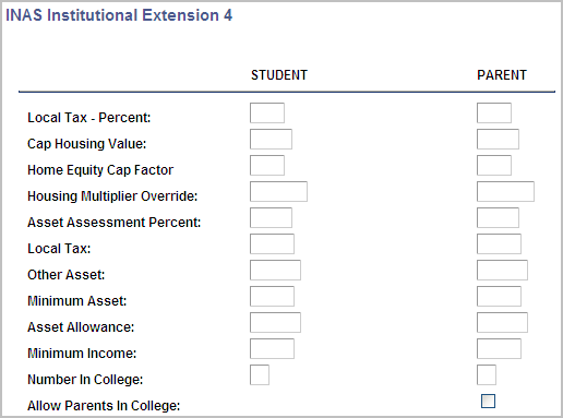

Access the INAS Institutional Extension 4 page (click the Extension 4 link on the INAS Institutional Extension 1 page).
Image: INAS Institutional Extension 4 page
This example illustrates the fields and controls on the INAS Institutional Extension 4 page. You can find definitions for the fields and controls later on this page.
INAS (Institutional Need Analysis System) Institutional Extension 4 page
Use the INAS Institutional Extension 4 page to override global policy options.
Field or Control
Definition
Local Tax — Percent
Enter an amount to override the amount calculated by IM.
Cap Housing Value
Enter an amount to override the value selected for the Home Cap field on the Home/Asset Projections page.
Home Equity Cap Factor
Enter an amount to override the value selected for the Home Equity Cap Factor field on the Home/Asset Projections page.
Housing Multiplier Override
Enter an amount to override the delivered housing multiplier table value that projects home equity.
Asset Assessment Percent
Enter an amount to override the value selected for the Asset Assessment Rate field on the Home/Asset Projections page
Local Tax
Enter an amount to override amount calculated by IM.
Other Asset
Enter an amount to add to calculated assets.
Minimum Asset
Enter an amount to override Minimum Contribution from Asset on the IM Value Parms 1 page.
Asset Allowance
Enter an amount to offset discretionary net worth calculated by IM.
Minimum Income
Enter an amount to override the Minimum SC or PC values from the Minimum SC Income and Minimum PC Range pages.
Number in College
Enter a number to override the number of students in college.
Allow Parents in College
Enter an amount to allow parents in college.

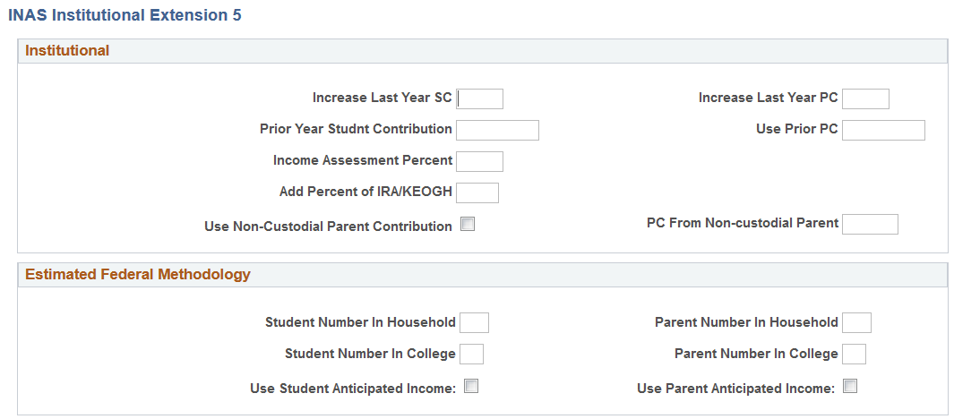

Access the INAS Institutional Extension 5 page (click the Extension 5 link on the INAS Institutional Extension 1 page).
Image: INAS Institutional Extension 5 page
This example illustrates the fields and controls on the INAS Institutional Extension 5 page. You can find definitions for the fields and controls later on this page.
INAS (Institutional Need Analysis System) Institutional Extension 5 page
Use the INAS Institutional Extension 5 page to override INAS global policy options for family factors such as past contributions.
Institutional
Field or Control
Definition
Increase Last Year SC/PC (increase last year student contribution/parent contribution)
Enter an amount to override increase last year SC or PC on the IM Value Parms 1 page.
Prior Year Studnt Contribution (prior year student contribution) and Use Prior PC (use prior parent contribution)
Enter the prior year's contribution for use with the Increase Last Year SC/PC option.
Income Assessment Percent
Enter an amount to override Use 70% Income Assmnt for Ind or Income Assmnt Rate for Dep from the IM Tax/Assess & Parms page.
Add Percent of IRA/KEOGH
Enter an amount to override the value in the % Of Stdnt IRA Include In NW field from the IM Value Parms 1 page.
Use Non-Custodial Parent Contribution
Select to override the value entered on Add Non Custodial PC to PC on the IM Yes/No Options page. Enter a value in the accompanying field PC from Non-custodial Parent if you want to override and use an amount other than the self reported value.
Estimated Federal Methodology
Field or Control
Definition
Student/Parent Number In Household
Enter an amount to override amount calculated by EFM.
Student/Parent Number In College
Use Student/Parent Anticipated Income
Select to override the value entered in the Use Anticipated Year Income field on the EFM Yes/No Options page.
