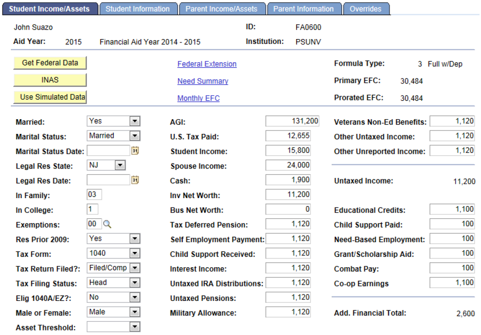

Access the Student Income/Assets page (select Financial Aid, then select Federal Application Data, then select Simulate 20nn-20nn FM INAS, then select Student Income/Assets).
Image: Student Income/Assets page
This example illustrates the fields and controls on the Student Income/Assets page.
ISIR edits are not used in the simulation pages. Changes used should not conflict with data in ISIR corrections.

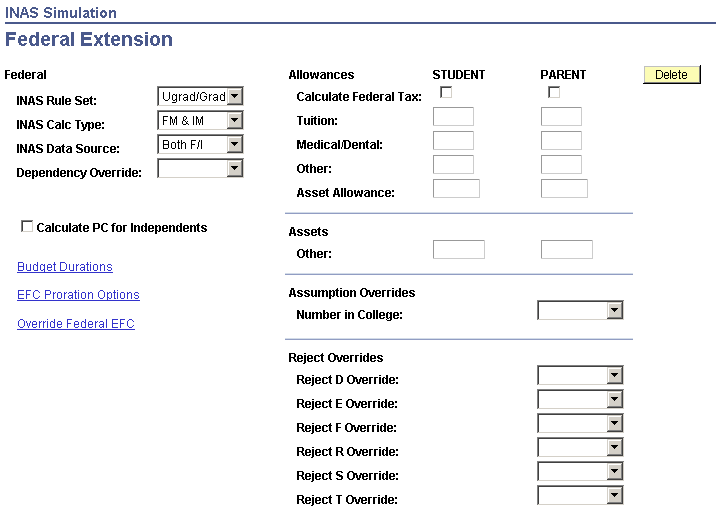

Access the INAS Simulation Federal Extension page (click the Federal Extension link on the Student Income/Assets page).
Image: INAS Simulation Federal Extension page
This example illustrates the fields and controls on the INAS Simulation Federal Extension page. You can find definitions for the fields and controls later on this page.
INAS (Institutional Need Analysis System) Simulation Federal Extension page
Field or Control
Definition
Budget Durations
Click this link to access the INAS Simulation Budget Durations page. You can enter any value for FM budget duration. Federal rules allow whole numbers only for budget duration. If the total allocation for the budget duration is greater than 12 months, a 9–month EFC is calculated and used in the academic award period, and no EFC is calculated for the non-standard award period.
EFC Proration Options
Click this link to access the INAS Simulation EFC Proration Options page to determine how to prorate EFC.
Override Federal EFC
Click this link to access the INAS Simulation EFC Override page to override the academic or non-standard parent contribution or student contribution.

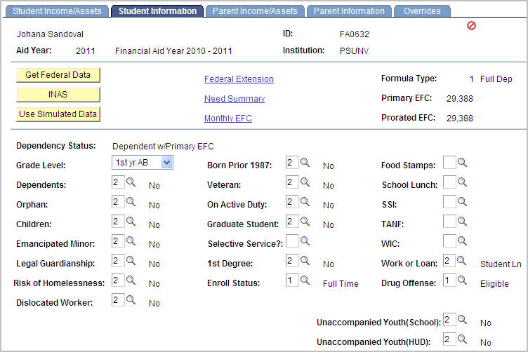

Access the Student Information page (select Financial Aid, then select Federal Application Data, then select Simulate 20nn-20nn FM INAS, then select Student Information).
Image: Student Information page
This example illustrates the fields and controls on the Student Information page. You can find definitions for the fields and controls later on this page.
Field or Control
Definition
Grade Level
Select from:
1st yr AB (attended before)
1st yr GP (graduate professional)
1st yr NA (never attended)
2nd yr Sph (sophomore)
3rd yr Jnr (junior)
4th yr Snr (senior)
5th yr UG (undergraduate)
Grad/Prof + (graduate/professional beyond 1st year)
Field Name Abbreviations and Explanations
On Active Duty (active duty status for US Armed Forces)
School Lunch (free or reduced price lunch)
SSI (Supplemental Security Income)
TANF (Temporary Assistance for Needy Families)
WIC (Women, Infants and Children)
Unaccompanied Youth (HUD) (Unaccompanied Youth – Housing and Urban Development)

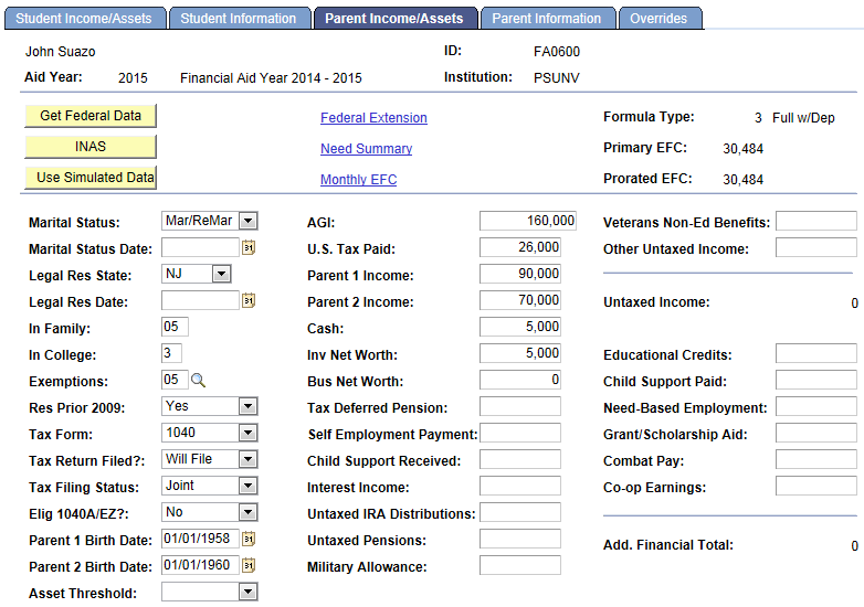

Access the Parent Income/Assets page (select Financial Aid, then select Federal Application Data, then select Simulate 20nn-20nn FM INAS, then select Parent Income/Assets).
Image: Parent Income/Assets page
This example illustrates the fields and controls on the Parent Income/Assets page.

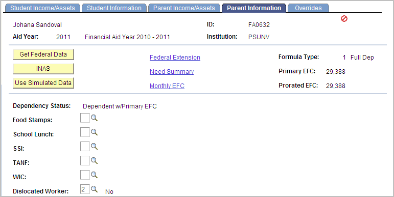

Access the Parent Information page (select Financial Aid, then select Federal Application Data, then select Simulate 20nn-20nn FM INAS, then select Parent Information).
Image: Parent Information page
This example illustrates the fields and controls on the Parent Information page. You can find definitions for the fields and controls later on this page.

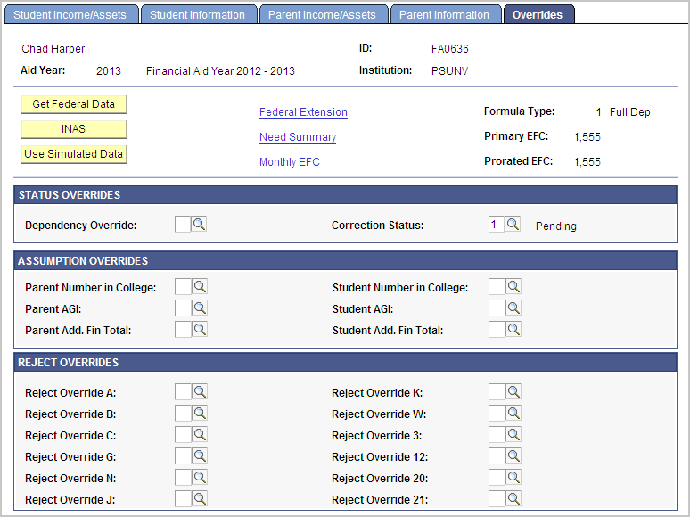

Access the Overrides page (select Financial Aid, then select Federal Application Data, then select Simulate 20nn-20nn FM INAS, then select Overrides).
Image: Overrides page
This example illustrates the fields and controls on the Overrides page. You can find definitions for the fields and controls later on this page.
Overrides page
STATUS OVERRIDES
Field or Control
Definition
Dependency Override:
Values include:
1: Dependent to Independent. You can select this value.
2: Cancel Dep Override – Corr Only. You can select this value.
3: Override Failed. The correction process sets this value.
Correction Status:
Values include:
1: Correction(s) Pending. You can select this value.
2: Send Correction(s). You can select this value.
3: Correction(s) Sent. The correction process sets this value.
4: Correction(s) Accepted. The correction process sets this value.
5: Corrections Rejected. The correction process sets this value.
6: Do Not Send Correction(s). You can select this value.
ASSUMPTION OVERRIDES
Field or Control
Definition
Parent Number In College
Select 1:Yes.
Parent AGI (parent adjusted gross income)
Select 1:Yes.
Parent WKC Assumed Zero (parent income from worksheet C assumed 0)
Select 1:Yes.
Student Number In college
Select 1:Yes.
Student AGI (student adjusted gross income)
Select 1:Yes.
Student WKC Assumed Zero (student income from worksheet C assumed 0)
Select 1:Yes.
REJECT OVERRIDES
Select 1: Yes to override a listed reject.
