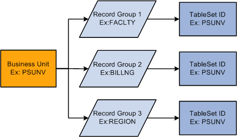

Control tables enable you to use tableset IDs, which make tableset sharing possible. The tableset ID indicates which of the rows in the control table a particular business unit can access. Each row in the control table has a tableset ID associated with it and business units are associated with tableset IDs through record groups:
Image: Business units and tableset IDs associated through record groups
Business units pass data through record groups to tableset IDs.
Note: The tableset ID is also referred to as the setID. These terms are interchangeable.

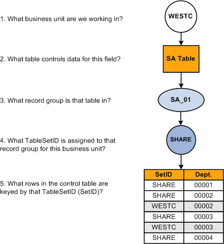

If much of the control table data is the same from business unit to business unit, tableset sharing enables you to share that information among business units instead of having to enter the same data multiple times. For example, suppose that an institution has 10 business units and they all use the same accounts. Instead of having to enter all of the accounts 10 times, you could enter them once and set up tableset sharing to enable all of the business units to access them.
Tableset sharing also enables you to manage exceptions within the organization. For example, suppose that 9 of the 10 business units use the same accounts, but the tenth business unit uses entirely different accounts. This is easily accommodated through tableset sharing.

A record group is a set of functionally or logically related records or views based on how the records are used in the system. A record group can contain a single record or view, or it can contain many records and views. Record groups are delivered as part of the PeopleSoft system and should not be altered.
When you create a business unit, that business unit is automatically linked to each record group in the system that you are using.
Record groups exist for two purposes:
  • To save time in data entry.
    With record groups, tableset sharing can be accomplished quickly and easily instead of requiring redundant data entry.
  • To provide consistency in the data.
    Record groups ensure that tableset sharing is applied consistently across all related tables and views in the system.
When you create and then save a business unit, a new tableset ID with the same name as the business unit is created. The system automatically assigns that tableset ID to each record group for the new business unit.
Note: PeopleSoft suggests that you create tableset IDs and business unit names that are five characters long. A performance degradation occurs if the tableset IDs or business units have fewer than five characters.
This diagram illustrates the relationship between business unit, record group, and tableset ID:
Image: Relationship between business unit, record group, and tableset ID
This example shows how data can pass from a business unit through three record groups and into tableset IDs.

Tablesets are identified by a set control value. The set control value is also a tableset ID. The set control value used to identify a tableset is not the same as the tableset ID that PeopleTools uses to retrieve the data from the tables in the database. Sometimes the set control value is the same as the tableset ID, but other times it is not.
Here is an example of how this works. Suppose that a community college district has three campuses and a main office:
Community College Office and Campuses
Tableset ID
Community College Main District Office
CCMDO
North Campus
NORTH
West Campus
WESTC
Far South Campus
SOUTH
Two of the campuses share location and facility information, and all three share the grading scheme and level or load rules. Here are the shared record groups:
Record Group
Campuses Sharing Record Groups
FACILITY (Facility table)
North Campus and West Campus
HR_03 (Location table)
CAREER (Grading Scheme and Level/Load tables)
North Campus, West Campus, and Far South Campus

With tableset sharing, you can specify the control table data that the system uses for each business unit. If much of the control table data is the same from business unit to business unit, tableset sharing enables you to share that information, instead of having to enter the same data multiple times.
To understand how this works in the PeopleSoft system, consider what happens when a user makes a selection from the available options. The list that appears contains all of the valid entries that can be entered in the field based on the relevant business unit.
This series of questions outlines the online process that occurs:
Image: Tableset sharing process
These five questions step users through the tableset sharing process.
