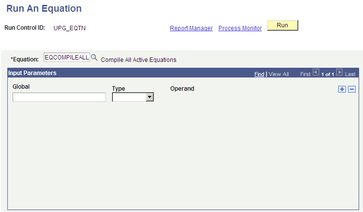

Access the Run An Equation page (select Set Up SACR, then select Common Definitions, then select Equation Engine, then select Run Equation, then select Run an Equation).
Image: Run An Equation page
This example illustrates the fields and controls on the Run An Equation page. You can find definitions for the fields and controls later on this page.
Note: Anyone using Equation Engine in your organization must complete the steps in this section to recompile equations.
To recompile equations:
  1. Enter the equation EQCOMPILEALL.
  2. Leave the Global and Type fields blank.
  3. Click the Run button.
  4. Click the OK button on the Process Scheduler Request page.
  5. Verify that the job ran successfully by checking the Process Monitor.

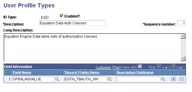

Access the User Profile Types page for EQD (select PeopleTools, then select Security, then select Security Objects, then select User Profile Types, then select User Profile Types).
Note: Financial Aid and Student Financials administrators must complete the steps in this section to verify equation security objects.
Image: User Profile Types page (EQD)
This example illustrates the fields and controls on the User Profile Types page (EQD). You can find definitions for the fields and controls later on this page.
Verify that the information that appears matches the information provided in the preceding page.

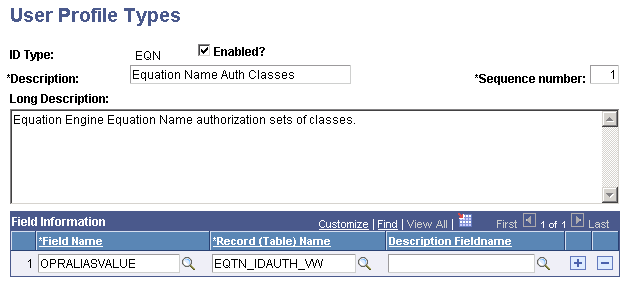

Access the User Profile Types page for EQN (select PeopleTools, then select Security, then select Security Objects, then select User Profile Types, then select User Profile Types).
Image: User Profile Types page (EQN)
This example illustrates the fields and controls on the User Profile Types page (EQN). You can find definitions for the fields and controls later on this page.

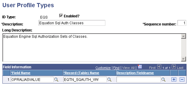

Access the User Profile Types page for EQS (select PeopleTools, then select Security, then select Security Objects, then select User Profile Types, then select User Profile Types).
Image: User Profile Types page (EQS)
This example illustrates the fields and controls on the User Profile Types page (EQS). You can find definitions for the fields and controls later on this page.

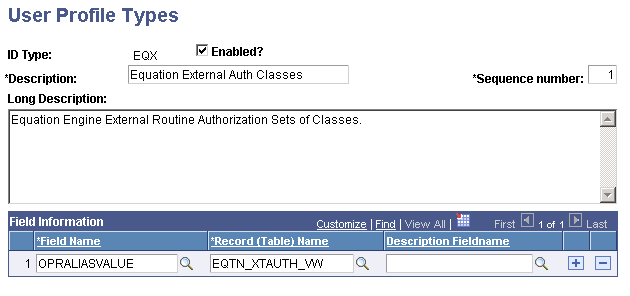

Access the User Profile Types page for EQX (select PeopleTools, then select Security, then select Security Objects, then select User Profile Types, then select User Profile Types).
Image: User Profile Types page (EQX)
This example illustrates the fields and controls on the User Profile Types page (EQX). You can find definitions for the fields and controls later on this page.

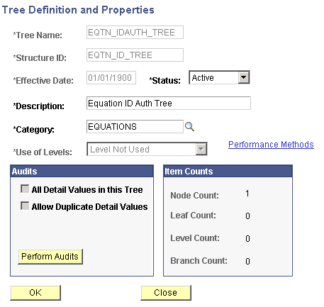

Access the Tree Definitions and Properties page for EQTN_IDAUTH_TREE (select Tree Manager, then select Tree Manager and click theTree Definition link on the Tree Manager page).
Note: Financial Aid and Student Financials administrators must complete the steps in this section to adjust equation security.
Image: Tree Definitions and Properties page (EQTN_IDAUTH_TREE)
This example illustrates the fields and controls on the Tree Definitions and Properties page (EQTN_IDAUTH_TREE). You can find definitions for the fields and controls later on this page.

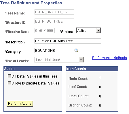

Access the Tree Definitions and Properties page for EQTN_SQAUTH_TREE (select Tree Manager, then select Tree Manager and click the Tree Definition link on the Tree Manager page).
Image: Tree Definitions and Properties page (EQTN_SQAUTH_TREE)
This example illustrates the fields and controls on the Tree Definitions and Properties page (EQTN_SQAUTH_TREE). You can find definitions for the fields and controls later on this page.

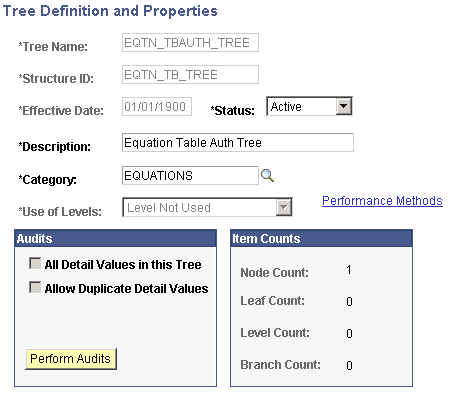

Access the Tree Definitions and Properties page for EQTN_TBAUTH_TREE (select Tree Manager, then select Tree Manager and click the Tree Definition link on the Tree Manager page).
Image: Tree Definitions and Properties page (EQTN_TBAUTH_TREE)
This example illustrates the fields and controls on the Tree Definitions and Properties page (EQTN_TBAUTH_TREE). You can find definitions for the fields and controls later on this page.

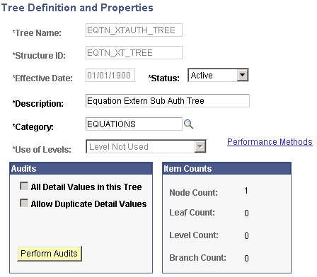

Access the Tree Definitions and Properties page for EQTN_XTAUTH_TREE (select Tree Manager, then select Tree Manager and click the Tree Definition link on the Tree Manager page).
Image: Tree Definitions and Properties page (EQTN_XTAUTH_TREE)
This example illustrates the fields and controls on the Tree Definitions and Properties page (EQTN_XTAUTH_TREE). You can find definitions for the fields and controls later on this page.

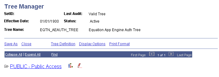

Access the Tree Manager page (select Tree Manager, then select Tree Manager).
Image: Tree Manager page
This example illustrates the fields and controls on the Tree Manager page. You can find definitions for the fields and controls later on this page.
Tree Manager page
Create a tree hierarchy from the PUBLIC node if one does not already exist for each of the trees. The tree hierarchy should contain a separate node for Financial Aid administrators and a separate node for Student Financials administrators. You can break this down further if you want to limit who can run equations versus who can edit an equation within the groups.

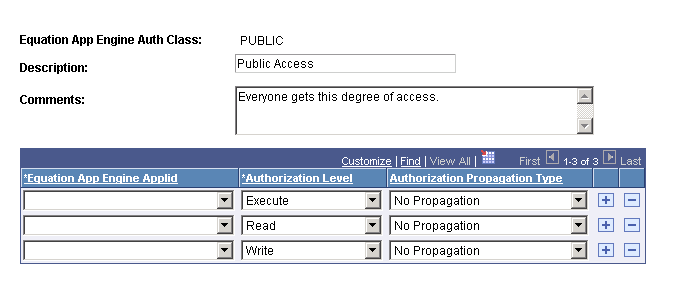

Access the Edit Data page (click the Edit Data icon on the Tree Manager page).
Image: Edit Data page
This example illustrates the fields and controls on the Edit Data page. You can find definitions for the fields and controls later on this page.
Edit Data page
Under each node, add or edit the list of objects and indicate what level of security should be applied to the node.
To do this, click the Edit Data icon (pencil icon) and then insert rows of equation object names and grant appropriate authorization levels.

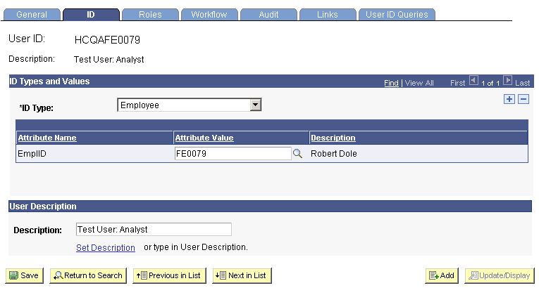

Access the User Profiles page (select PeopleTools, then select Security, then select User Profiles, then select User Profiles).
Image: User Profiles page: ID tab
This example illustrates the fields and controls on the User Profiles page: ID tab. You can find definitions for the fields and controls later on this page.
For each person in a department who needs security authorization other than PUBLIC, you must follow these steps:
  1. Enter the person's ID number and access the ID tab.
  2. Enter each of the four EQ ID types in the ID Type and Values fields.
  3. Enter the appropriate Equation Security Tree node name for each of these ID types.
  4. Save the user profile.
