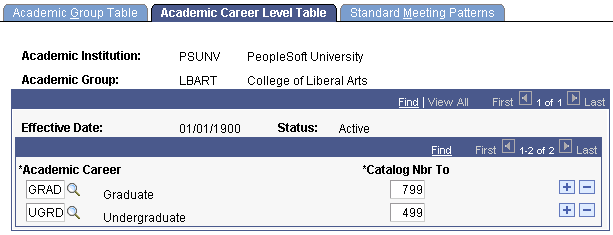

Access the Academic Career Level Table page (select Set Up SACR, then select Foundation Tables, then select Academic Structure, then select Academic Group Table, then select Academic Career Level Table).
Image: Academic Career Level Table page
This example illustrates the fields and controls on the Academic Career Level Table page. You can find definitions for the fields and controls later on this page.
Field or Control
Definition
Academic Career
Enter the academic career that you want to link to this academic group. Insert additional rows to enter all academic careers that you want to link to this academic group.
Catalog Nbr To (catalog number to)
For each academic career that you link to this academic group, enter the course number immediately after the highest possible course catalog number for that academic career. For example, if the highest possible course catalog number within the College of Liberal Arts for the undergraduate academic career is 299, enter 300 in the field. Likewise, if the highest catalog number for the graduate academic career is 599, enter 600 into the field. The number that you enter defines the lowest possible catalog number for the subsequent academic career within this academic group. In this example, 300 would be the first catalog number of the graduate academic career within the College of Liberal Arts.
When you create a new course offering on the Offerings page of the Course Catalog component, the system displays the academic career value based on the academic career and catalog number combinations from this page. In the preceding example, if you create a course within the College of Liberal Arts with a catalog number of 300, the system displays the academic career Graduate. If the catalog number is 299, the system displays the academic career Undergraduate.

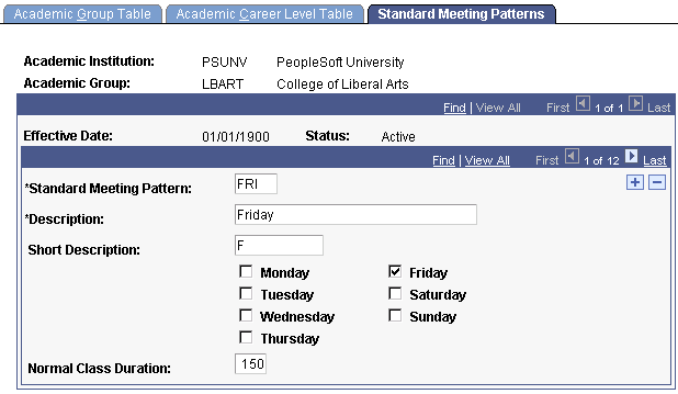

Access the Standard Meeting Patterns page (select Set Up SACR, then select Foundation Tables, then select Academic Structure, then select Academic Group Table, then select Standard Meeting Patterns).
Image: Standard Meeting Patterns page
This example illustrates the fields and controls on the Standard Meeting Patterns page. You can find definitions for the fields and controls later on this page.
Field or Control
Definition
Enter a code to represent the standard class meeting pattern for this academic group. Insert additional rows to add more standard meeting patterns for this academic group.
Monday, Tuesday, Wednesday, ThursdayFriday, Saturday, and Sunday
Select the appropriate days of the week for this standard meeting pattern.
Normal Class Duration
Enter the number of minutes for each class in this standard meeting pattern.
