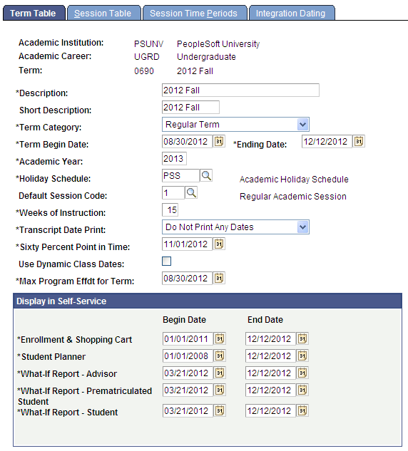

Access the Term Table page (select Set Up SACR, then select Foundation Tables, then select Term Setup, then select Term/Session Table, then select Term Table).
Image: Term Table page
This example illustrates the fields and controls on the Term Table page. You can find definitions for the fields and controls later on this page.
Term Table page
A term is an administrative time period within which sessions are defined, students are billed, and statistics are accumulated for individual students and the entire academic institution.
Field or Control
Definition
Term Category
Select the category that best describes the term. You can modify these translate values.
Term Begin Date and Ending Date
Enter the first and last official dates of the term. The system uses the term begin date as the effective date of the term. The term begin and end dates are important because they determine, for example, the courses that are available for the term and the status of a student's academic program and academic plan. These dates are referenced throughout the system.
Academic Year
Enter the academic year to which the term belongs. For example, 2004 indicates that the term belongs to the 2004−2005 academic year. You must associate each term with an academic year for reporting and financial aid accumulation purposes. However, you can modify the financial aid academic year for individual students.
Holiday Schedule
Enter the holiday schedule for the term. Define holiday schedule values on the Holiday Schedule page.
See Setting Up Holiday Schedules
Default Session Code
Enter the default session code. This value is used throughout the system to supply the session code associated with the term, although the value can be overridden. The default serves as a data entry aid.
Weeks of Instruction
Enter the standard number of weeks of instruction for classes offered in the term. The Instructor Workload feature in Student Records uses this value when calculating faculty workload. Financial Aid uses this value when building terms and projections.
Transcript Date Print
Select the dates to print on student transcripts for this academic career and term combination. The value of this field appears by default, based on the corresponding field value from the SA Options (student administration options) page of the Installation Table component. Any modification to these translate values requires substantial programming. Values are:
Do Not Print Any Dates: No dates are printed on student transcripts.
Print Class Dates: To print class dates on student transcripts for the specified transcript type, select this value and the Print Class Dates check box on the Enrollment/Statistics page of the Define Transcript Type component.
Print Session Dates: Select to print session dates on student transcripts.
Print Term Dates: Select to print term dates on student transcripts.
Sixty Percent Point in Time
Enter the date on which the term is 60 percent complete. The system uses this date when computing refunds for students. In the U.S., most academic institutions stop issuing refunds at this point.
Use Dynamic Class Dates
Select to enable the Dynamic Class Dates feature for all sessions scheduled in this term. The system migrates the value of this check box to the corresponding field on the Session Table page, where you can override the selection for a specific session.
Max Program Effdt for Term (maximum program effective date for term)
Enter the date to be used as the deadline for term activation in a given term. The date appears by default from the Academic Career Table page. The deadline can be modified on the Term Table, but must be equal to or after the term start and before the Term end date.
Display in Self-Service
Define dates in this group box to control the availability of self-service enrollment and My Planner features by term.
Field or Control
Definition
Enrollment & Shopping Cart
Enter a range of dates to control the availability of this term in the Select Term field on student self-service enrollment and shopping cart pages.
The student self-service Class Search & Browse Course Catalog also uses the date range to determine if the Select button should appear, which allows the student to add the class to their shopping cart.
Note: The SSR_ENROLLMENT web service is one of a number of delivered Enrollment Web Services. The service operation SSR_GET_ENROLLMENT supports the retrieval of the StudyList details for an enrolled student. The service validates the term value that is entered by a user (for example a student using a self service enrollment user interface) against the date range for the term in the Enrollment & Shopping Cart field. An error message is sent if the term is not within the specified date range.
For detailed information about Enrollment Web Services:
See Enrollment Web Services Developers Guide and Enrollment Web Services Users Guide in My Oracle Support (ID 1371391.1).
Student Planner
Enter a range of dates to control the availability of this term for use on the student self-service My Planner.
What-If Report – Advisor
If you want to enable advisors to generate what-if advisement reports for students or prospective students using the What-If Report – Create What-if Scenario self-service (SAA_SS_WHATIF) page, enter the begin and end dates.
The range of dates that you enter controls the availability of the term value in the Catalog Year field on the What-If Report – Create What-if Scenario page. This is the page that advisors use to define a what-if scenario for students.
The What-If Report – Advisor field is mandatory. If you do not want to use the feature of advisors generating what-if reports in self-service, Oracle recommends that you enter dates in the past.
What-If Report – Prematriculated Student
If you want to enable prospective students to generate what-if advisement reports using the What-If Report – Create What-if Scenario self-service page, enter the begin and end dates.
The range of dates that you enter controls the availability of the term value in the Catalog Year field on the What-If Report – Create What-if Scenario page for those users.
The What-If Report – Prematriculated Student field is mandatory. If you do not want to use the feature of prematriculated students generating what-if reports in self-service, Oracle recommends that you enter dates in the past.
What-If Report – Student
If you want to enable active students to generate what-if advisement reports using the What-If Report – Create What-if Scenario self-service page, you have two options:
One option is to use only the student’s career requirement term so that the student cannot change the Catalog Year field value on the What-If Report – Create What-if Scenario page. You can observe this default setting by accessing the Academic Advising Setup page and verifying that the value in the Student What-If Career Requirement Term field is Use Career Reqmnt Term Only.
If you prefer to give students the option of selecting a term value in the Catalog Year field, your other option is to select the Use Term Table Setup value in the Student What-If Career Requirement Term field on the Academic Advising Setup page. Then, use the What-If Report – Student field on the Term Table page to enter the valid begin and end dates. The range of dates that you enter controls the availability of the term in the Catalog Year field on the What-If Report – Create What-if Scenario page.
The What-If Report – Student field is mandatory. If you do not want the Catalog Year field to obey the term begin and end dates, enter begin and end dates that are in the past.
