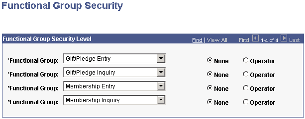

Access the Functional Group Security page (select (Set Up SACR, then select Security, then select Secure Contributor Relations, then select Functional Group Security, then select Functional Group Security).
Image: Functional Group Security page
This example illustrates the fields and controls on the Functional Group Security page. You can find definitions for the fields and controls later on this page.
Functional Group Security Level
Field or Control
Definition
Functional Group
Select a functional group to define security for the group. Functional groups are delivered with the system and represent the major business processes in the system that are affected by business unit. The functional groups delivered with the system cannot be removed or amended.
Functional Security
Select None to allow the components that make up this functional group to be accessed without user-level business unit security. Select Operator to allow access only with business unit security. If you select operator, the access you grant users on the Secure Business Unit page determine what information a user can access within the functional group.
Refresh Security
If you make changes to the Functional Security selection for any functional group, this button appears. Run the Refresh Security Process to activate any changes made to security settings. The Refresh Security process is an Application Engine program that synchronizes the component search records and prompt edit table values with the setup of the PSSTATUS table. Updating this value ensures that all Application Servers use the latest version. This is not limited to Contributor Relations; it impacts all PeopleSoft applications sharing the database. When you run this process, check the Process Monitor to verify that it runs successfully and the Message Log for a detailed list of the changes implemented. See the warning in this section prior to running this process.
Warning! After running the Refresh Security process, you must delete all cache files. You must also re-run the PeopleTools process that creates a shared cache file for multiple application servers. This process impacts all applications sharing this database! Contact your IT Support Staff before running this process.

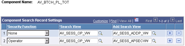

Access the Component Search Record Settings page (click the Srch Recs link on the Component Function page).
Image: Component Search Record Settings page
This example illustrates the fields and controls on the Component Search Record Settings page. You can find definitions for the fields and controls later on this page.
Warning! The system is delivered with all search views assigned to the appropriate components. Do not make any changes to these settings unless the institution is adding business unit functionality not provided by Contributor Relations.
Field or Control
Definition
Security Function
Select None or Operator to determine the type of security for which you are selecting search views.
Search View
Enter the search view to associate with the component for the security function you selected. The prompt lists all valid search views.
Add Search View
If a component is configured to allow you to add a new record, and the search view to create a new record is different than the Update/Display search record, specify an add search view. For example, you want NEW in the session number field instead of blank by default.

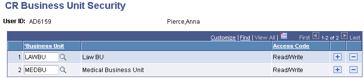

Access the CR Business Unit Security page (select (Set Up SACR, then select Security, then select Secure Contributor Relations, then select Secure Business Unit, then select CR Business Unit Security).
Image: CR Business Unit Security page
This example illustrates the fields and controls on the CR Business Unit Security page. You can find definitions for the fields and controls later on this page.
Field or Control
Definition
Business Unit
Enter the business unit for which you want to grant the user access.
Access Code
Indicates the type of access a user has to a particular business unit. Since security is granted when you add a row to this table, this field displays a value of Read/Write.
