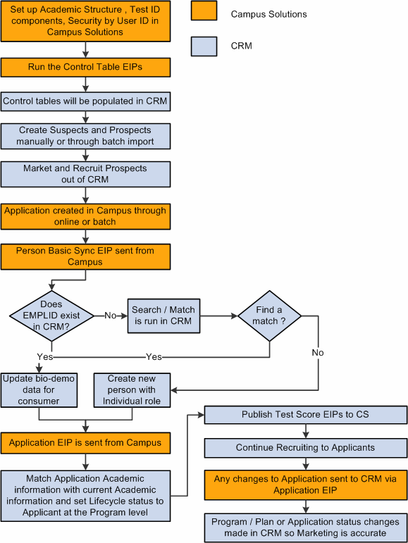

Image: Example of message flow for Suspect to Applicant
Workflow illustrating the system steps to pass messages between Campus Solutions and CRM when suspects become applicants.

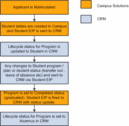

Image: Example of message flow from Applicant to Alumnus
Workflow illustrating the system steps to pass messages between Campus Solutions and CRM when applicants become alumni.
