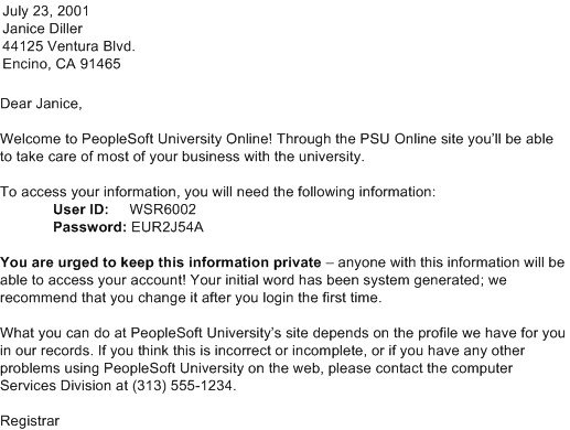

Here is an example of a password notification letter created with the sample template CCLTROPR.doc:
Image: Example of password notification letter
Example of an online access letter to a student from an institution.
