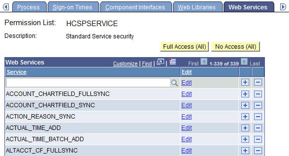

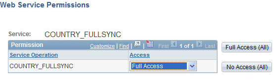

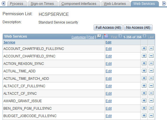

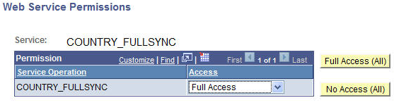

  1. Update security by adding the Service Operation(s) to your primary permission list:
    1. Navigate to select PeopleTools , then select Security , then select Permissions & Roles , then select Permission Lists.
    2. Select the relevant permission list from the search dialog box.
    3. Select the Web Services tab.
    4. Enter the corresponding Service(s) for the Service Operation(s) you wish to use.
    5. Click the Edit link. On the Web Service Permissions secondary page, add access to the relevant Service Operation(s) listed by selecting the Full Access option for the Access column.
      Image: Web Services page-Permission List
      This example illustrates the fields and controls on the Web Services page-Permission List.
      Web Services page permission list
      Image: Web Services Permissions page
      This example illustrates the fields and controls on the Web Services Permissions page for HCM.
      Web Service Permissions page COUNTRY_FULLSYNC (HCM)

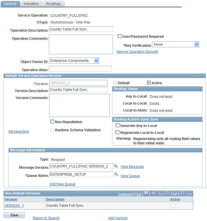

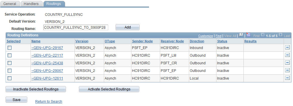

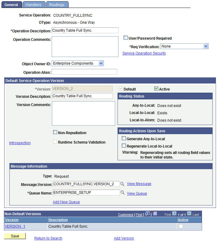

  2. Activate Service Operations and create Routings.
    1. Navigate to select PeopleTools, then select Integration Broker, then select Integration Setup, then select Service Operations.
    2. Select the relevant Service Operation(s) from the search dialog box.
    3. Check the Active check box on the General tab.
    4. Make note of the Queue Name field, as you need to verify later that the Queue status is Running.
    5. Select the Routings tab and add a new routing for the Service Operation by entering a value in the Routing Name field and clicking the Add button.
      Image: General page
      This example illustrates the fields and controls on the General page for the COUNTRY_FULLSYNC service operation.
      Service Operations Definition page
      Image: Routings page
      This example illustrates the fields and controls on the Routings page for the COUNTRY_FULLSYNC service operation.
      Service Operations page routings

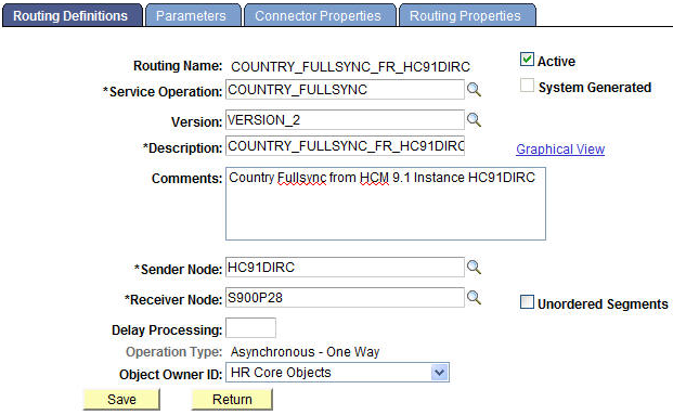

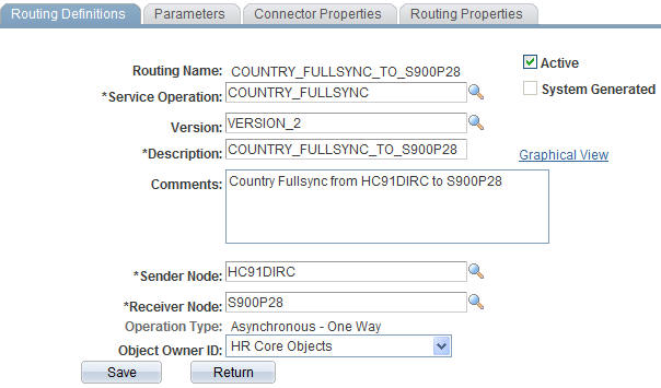

    6. Enter a Sender Node and a Receiver Node on the Routings Definition page of the Routings component.
    7. Verify that the Active check box is checked.
    8. Save the routing.
    9. Click the Return button at the bottom of the Routings Definition page to return to the Service Operation setup component.
    10. Click Save at the bottom of any page in the Service Operations component to save the Service Operation.
      Image: Routing Definitions page
      This example illustrates the fields and controls on the Routing Definitions page for the COUNTRY_FULLSYNC service operation.
      Service Operation Routing Definitions page

  1. Update security by adding the service operation to the required user’s permission list.
    1. Navigate to select PeopleTools, then select Security, then select Permissions & Roles, then select Permission Lists.
    2. Select the relevant permission list from the search dialog box (primary permission list for the user).
    4. Enter the corresponding Service(s) for the Service Operation(s) you wish to leverage.
    5. Click the Edit link and add access to the relevant Service Operation(s) listed on the Web Service Permissions secondary page.
    6. Click OK to return to the Web Services page.
    7. Click Save to save the updated Permission List.
      This example illustrates the fields and security controls on the Web Services page.
      Web Services Security permission list
      Image: Web Service Permissions page
      This example illustrates the fields and security controls on the Web Service Permissions page in Campus Solutions.
      Web Service Permissions page COUNTRY_FULLSYNC (CS)

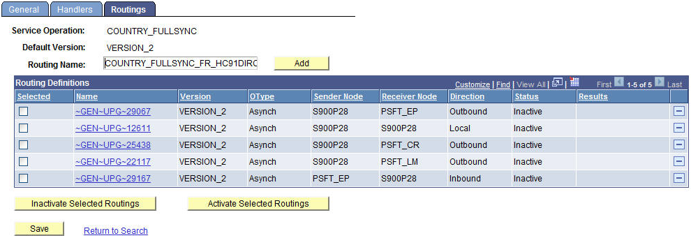

  2. Activate Service Operation and Create Routing.
    3. Select the Active check box on the General tab.
      Image: General page
      Service Operation Definition page
    5. Select the Routings tab and add a new routing for the Service Operation.
    8. Click Save at the bottom of the Routings Definition page to save the routing.
    9. Click the Return at the bottom of the Routings Definition page to return to the Service Operation setup component.
      Service Operation Routings page

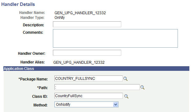

  3. Activate or create the required Service Operations OnNotify handler.
    1. Click the Handlers tab of the Service Operations component and set up the following:
      Image: Handlers page
      This example illustrates the fields and controls on the Handlers page for the COUNTRY_FULLSYNC service operation.
      Service Handlers page
      Field or Control
      Definition
      Name
      Enter a Handler Name if one does not exist. For example, BusUnitHRFullSync.
      See the Full Sync Service Operations table (Application Package Name/ Class/ Method column) for the required value for this field.
      Type
      OnNotify
      Implementation
      Application Class
      Status
      Active
    2. Click the Details link and set up the following:
      Image: Handler Details page
      This example illustrates the fields and controls on the Handler Details page.
      Field or Control
      Definition
      Package Name
      For example, GEN_UPG_HANDLER_12332. See the FullSync Service Operations table (Application Package Name/ Class/ Method column) for the required value for this field.
      Path
      Class ID
      For example, CountryFullSync. See the FullSync Service Operations table (Application Package Name/ Class/ Method column) for the required value for this field.
      Method
      OnNotify
    3. Click OK to return to the Handlers setup page.
    4. Click Save at the bottom of the Handlers page to save your changes.

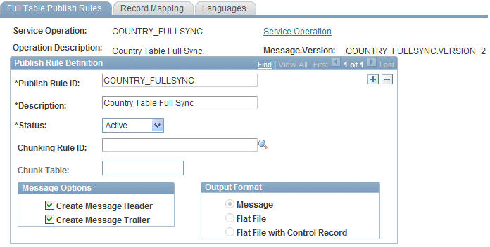

  1. Define Full Data Publish Rules.
    1. Navigate toselect Enterprise Components , then select Integration Definitions , then select Full Data Publish Rules,and set up the following:
      Image: Full Table Publish Rules page
      This example illustrates the fields and controls on the Full Table Publish Rules page for the COUNTRY_FULLSYNC service operation.
      Field or Control
      Definition
      Message Name
      Name of the Service Operation.
      Publish Rule ID
      Enter a publish rule ID.
      Description
      Enter a description of the Publish Rule.
      Status
      Set to Active.
    2. Check the Create Message Header and Create Message Trailer check boxes.
    3. Save the page.

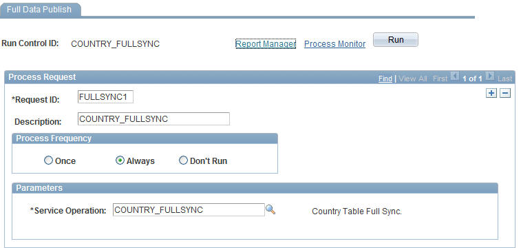

  2. Execute the Full Data Publish Process.
    1. Navigate to select Enterprise Components, then select Integration Definitions, then select Initiate Processes, and set up the following:
      Image: Full Data Publish page
      This example illustrates the fields and controls on the Full Data Publish page.
      Field or Control
      Definition
      Run Control ID
      Create a new Run Control ID.
      Request ID
      Enter a Request ID.
      Process Frequency
      Select Always.
      Parameters
      Select the existing Service Operation, for example, COUNTRY_FULLSYNC.
    2. Save the page and click Run.
    3. Select the Full Table Data Publish process from the Process Scheduler Request page and verify that the process runs successfully.
      Image: Process Scheduler Request
      This example illustrates the fields and controls on the Process Scheduler Request page where the Full Table Data Publish process is selected.
      Example of Process Scheduler Request page for Full Table Data Publish process

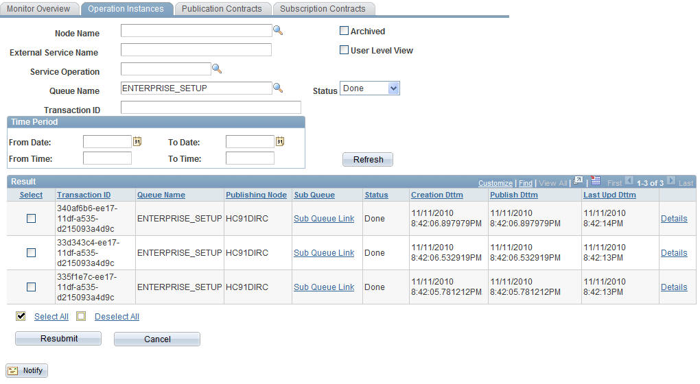

  3. Navigate to select PeopleTools, then select Integration Broker, then select Service Operations Monitor, then select Monitoring , then select Asynchronous Services to review the status of the Full Sync messages created by the Full Data Publish process.
    Image: Operation Instances page
    This example illustrates the fields and controls on the Operation Instances page to monitor asynchronous service operations.
    Asynchronous Service Operations Monitor page

COUNTRY_FULLSYNC
Countries
ENTERPRISE_SETUP
GEN_UPG_HANDLER_12332 (COUNTRY_FULLSYNC/CountryFullSync/OnNotify)
