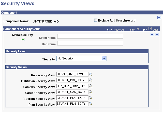

You complete these steps to secure access to student data:
  1. Identify and define levels of security for a component on the Security Views page.
  2. Update security definitions by running the Security Views Update process on the Security Views page.
  3. (Optional) Perform an audit of changes to security in the Security View Change Audit component.

The following table lists the default settings for the Financial Aid components that have security views. These are the default component settings delivered on the Security Views page. All components in the table display the following security settings:
  • Security Level = No Security
  • Global Security = Yes (selected)
Component names with an asterisk (*) also display the following security setting: Exclude Add Searchrecord = Yes (selected).

Access the Security Views page (select Set Up SACR, then select Security, then select Secure Student Administration, then select User ID, then select Security Views, then select Security Views).
When you search for existing values before accessing this page, you can search by Institution Security View.
Note: Adding components to the Security Views page does not automatically secure them. After you have specified all necessary components and views on the Security Views page, run the Security Views Update process to implement the settings.
Image: Security Views page
This example illustrates the fields and controls on the Security Views page. You can find definitions for the fields and controls later on this page.
Security Views page
When a user attempts to access one of the components that you specify, the system checks the user's security for the institution, campus, career, program, or plan to verify that the user has permission to access the student data using the component. In some cases, the navigation is also verified.

Security Tab
Select the Security tab.
Field or Control
Definition
Gbl Scrty (global security)
Displays the status of the Global Security check box on the Security Views page. The values Y for selected and N for cleared indicate the status of the check box.
Security
Displays the option entered in the Security field on the Security Views page. Options are:
  • NON (no access): No Access was entered on the Security Views page.
  • INS (institution): Institution Level was entered on the Security Views page.
  • CMP (campus): Campus Level was entered on the Security Views page.
  • CAR (career): Career Level was entered on the Security Views page.
  • PRG (program): Program Level was entered on the Security Views page.
  • PLN (plan): Plan Level was entered on the Security Views page.
No Security
Displays the view entered for the component in the No Security View field on the Security Views page.
Inst Security (institutional security)
Displays the view entered for the component in the Institution Security View field on the Security Views page.
Campus Security
Displays the view entered for the component in the Campus Security View field on the Security Views page.
Career Security
Displays the view entered for the component in the Career Security View field on the Security Views page.
Program Security View
Displays the view entered for the component in the Program Security View field on the Security Views page.
Plan Security
Displays the view entered for the component in the Plan Security View field on the Security Views page.
