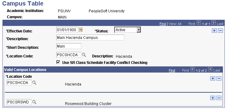

Access the Campus Table page (select Set Up SACR, then select Foundation Tables, then select Academic Structure, then select Campus Table).
Image: Campus Table page
This example illustrates the fields and controls on the Campus Table page. You can find definitions for the fields and controls later on this page.
Campus Table page
Field or Control
Definition
Use SR Class Schedule Facility Conflict Checking
Select to enable the system to use internal facility conflict checking functionality for this campus. The system checks for facility conflicts whenever a facility is booked for a class on the Meetings page or the Exam page of the schedule of classes.
The check box value migrates from the Installation page to the Academic Institution 2 page to the Campus Table page. The system uses the value on the Campus Table page during processing. Clear this check box on the Campus Table page to use an external facility conflict checking process.
Note: This check box has no relation to the Check for Facility Conflict check box on the Facility Table page, which controls whether you can schedule multiple events at the same facility.
Valid Campus Locations
Field or Control
Definition
Location Code (upper)
Enter a location code for the primary location of the campus. Define locations on the Location Table.
See: Setting Up Locations
Location Code (lower)
Enter all valid location codes for this campus. When creating courses or scheduling classes at a particular campus, the system displays only the values that you list here.
