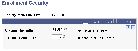

Access the Permission List - Enrollment Security page (select Set Up SACR, then select Security, then select Secure Student Administration, then select Permission List, then select Enrollment Security, then select Enrollment Security).
Image: Permission List - Enrollment Security page
This example illustrates the fields and controls on the Permission List - Enrollment Security page. You can find definitions for the fields and controls later on this page.
Field or Control
Definition
Academic Institution
Enter an academic institution that a student can access for self-service enrollment using this permission list.
Enrollment Access ID
Enter an enrollment access ID to allow students using this permission list to access the enrollment functions during the time periods specified in the enrollment access ID.
