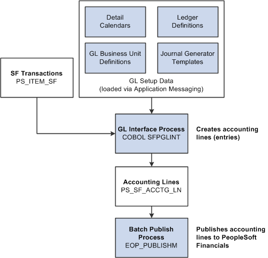

The GL Interface process creates accounting lines for all types of transaction activity in the Student Financials application.

This diagram illustrates how the PeopleSoft Financials GL Interface process creates accounting lines for Student Financials transactions:
Image: GL Interface process with PeopleSoft Financials integration
GL (General Ledger) Interface process with PeopleSoft Financials integration

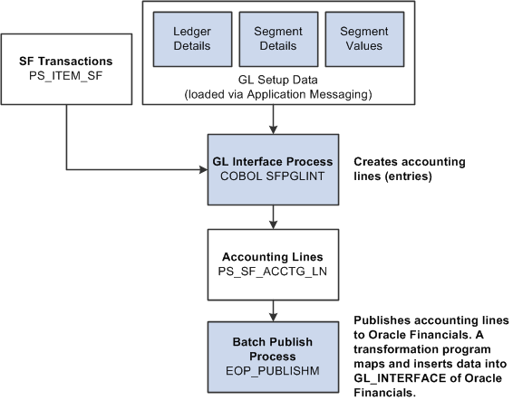

This diagram illustrates how the Oracle Financials GL Interface process creates accounting lines for Student Financials transactions:
Image: GL Interface process with Oracle Financials integration
GL (General Ledger) Interface process with Oracle Financials integration
If you interact with PeopleSoft or Oracle Financials, the system uses application messaging to share accounting line information with PeopleSoft or Oracle General Ledger.
