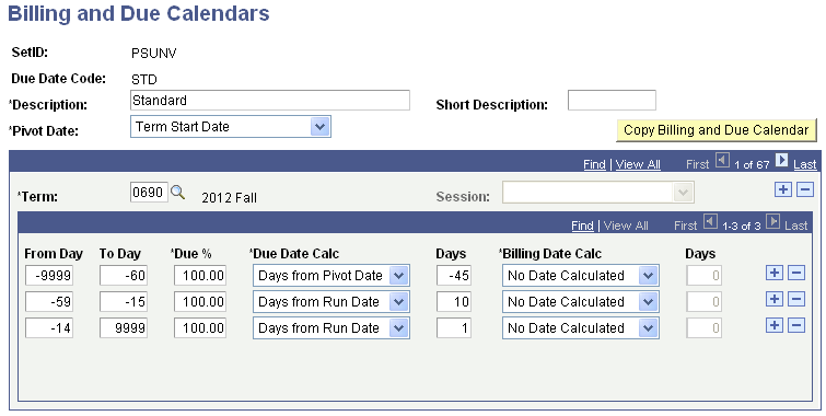

Access the Billing and Due Calendars page (select Set Up SACR, then select Product Related, then select Student Financials, then select Tuition and Fees, then select Billing and Due Calendars).
Image: Billing and Due Calendars page
This example illustrates the fields and controls on the Billing and Due Calendars page. You can find definitions for the fields and controls later on this page.
Field or Control
Definition
Pivot Date
Select a pivot date for this calendar. Student Financials uses the pivot date as the starting place to calculate due dates or billing dates. The system counts the billing dates and due dates—either back in time or forward in time—from the pivot date that you select.

Term
Enter the term for this billing and due calendar.
Session
If you are defining a billing and due calendar for a session within a term, or you want to use the session start date as the pivot date, specify the session.
From Day and To Day
Enter the first and last day that you assess fees. Express the number of days before the pivot date as a negative number, and the number of days after the pivot date as a positive number.
Due % (due percent)
Define the percentage of the fee that's due for the respective assessment period.
Due Date Calc (due date calculation)
Use this field to determine how the system calculates the due date for a given fee assessment period. Select from:
Days from Pivot Date: Select to calculate the due date based on the pivot date.

Days
Enter the number of days from the pivot date or run date that the fees are due. Enter a negative number to indicate days before the respective date; enter a positive number to indicate days after the respective date. If you select No Date Calculated in the Due Date Calc field, the Days field becomes unavailable.
Billing Date Calc (billing date calculation)
Use this field to determine how the system calculates the billing date for a given fee assessment period. Select from:
Days from Due Date: Select to calculate the billing date based on the calculated due date.
Days from Pivot Date: Select to calculate the billing date based on the pivot date.
Days from Run Date: Select to calculate the billing date based on the day that you assessed fees.
No Date Calculated: Select to disable the calculation of a billing date.
Note: Do not select Days from Run Date when using the Third Party Contract Track Charges by Due Dates functionality.
See Setting Up Third-Party Contracts.
Days
Enter the number of days from the due date, pivot date, or run date that the system produces a bill. Enter a negative number to indicate days before the respective date; enter a positive number to indicate days after the respective date. If you select No Date Calculated in the Billing Date Calc field, the Days field becomes unavailable.
