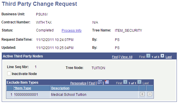

Access the Third Party Change Request page (select Student Financials, then select Payment Plans, then select Third Party Contract, then select Contract Node Change Request, then select Third Party Change Request).
Image: Third Party Change Request page
This example illustrates the fields and controls on the Third Party Change Request page. You can find definitions for the fields and controls later on this page.
Field or Control
Definition
Contract Number
This field is populated when a request is created. Only active third party contracts are available for processing.
Status
Select a status:
  • Open: Indicates that a request has been created and is waiting to be processed. Only one request per contract can have a change status of Open at the same time. An open request can be modified and submitted for processing. A status of Open is selected by default.
  • Canceled: The administrator has canceled the request. An administrator can change an Open request to Canceled.
  • Completed: This status is set after the Process Node Change Request has completed successfully.
  • Submitted: This status is set once the Process Node Change Request has been submitted for processing.
  • Error: This status is set if errors occur during the Process Node Change Request processing.
Process Info
Click this link to view additional details for requests with a status of Completed or Error.
Tree Node
All active tree nodes in the associated tree are displayed.
Inactivate Node
Select this check box to inactivate the entire node. All associated item types are excluded. For example, if housing charges are not to be paid by the third party, inactive the HOUSING node.
You can inactivate a node at any time, unless it is the only active node.
If the Inactivate Node check box is selected, the Exclude Item Types scroll is hidden.
Item Type
Enter the item type that you want to exclude. For example, if a third party does not want to pay the Internship Tuition, exclude the item type 100000000016 from the TUITION node. In this case, charges for the specific item type are not paid by a third party.
Note: The change request is stored in a staging table. After you make a request, you must run the Process Node Change Request (SFPTPREQ.CBL) process.
See Processing Third-Party Contract Change Requests.

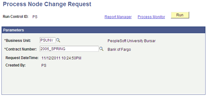

Access the Process Node Change Request page (select Student Financials, then select Payment Plans, then select Third Party Contract, then select Process Node Change Request, then select Process Node Change Request).
Image: Process Node Change Request page
This example illustrates the fields and controls on the Process Node Change Request page. You can find definitions for the fields and controls later on this page.
Field or Control
Definition
Contract Number
Select a contract number for which you want to process a change request. Only contracts with an Open change request status are available.
Process Logic
The Process Node Change Request process is used to finalize node changes to a third party contract. This process must be used in combination with the Third Party Change Request page, which you use to request the node changes to a third party contract. You can inactivate an entire node or exclude specific item types from a node. These exclusions are used to identify which charges should not be paid by the third party.
See Creating and Processing Third-Party Contract Change Requests.
The is how the Process Node Change Request process works:
  • The process selects a request from the staging table in which the Third Party Change Requests are stored.
  • The Status field on the Request page is set to Submitted.
  • If the Inactivate Node check box is selected on the Request page, the Node status is set to Inactive.
  • For Active nodes, Excluded item types are inserted in to the Exclusion table (SSF_TPC_CHGEXCL).
  • The Audit trail for each exclusion is created in the exclusion table.
  • The Recalc Third Party Contracts process (SFPTPPRC.CBL) is invoked to recalculate based on the node changes.
    See Recalculating Third-Party Contracts.
  • If the process completes successfully, the Request page Status is set to Completed. If errors occurred, the Request page Status is set to Error.
  • You can review the details on the Third Party Change Request page.
