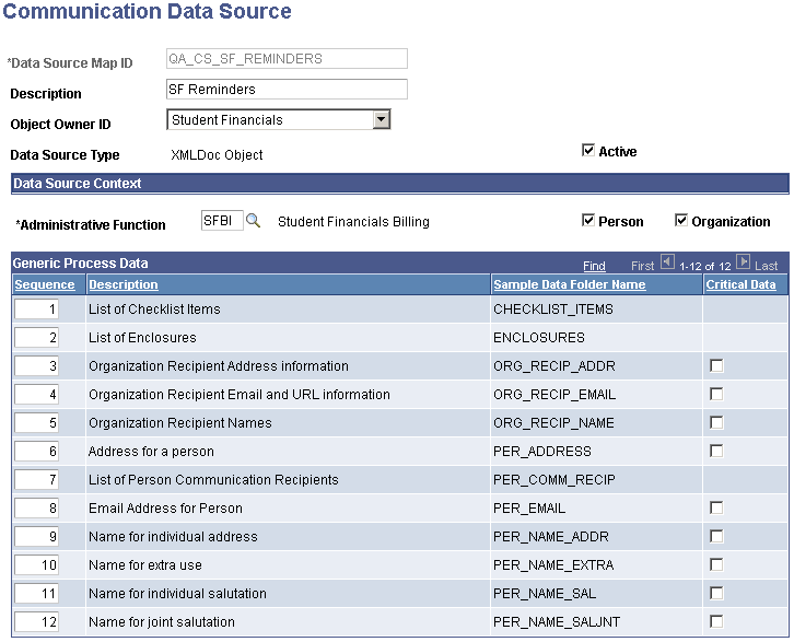

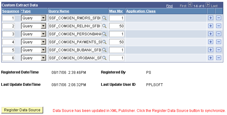

Access the Communication Data Source page (select Campus Community, then select Communications, then select Set up Communications, then select Communication Data Source).
Image: Communication Data Source page (1 of 2)
This example illustrates the fields and controls on the Communication Data Source page (1 of 2). You can find definitions for the fields and controls later on this page.
Image: Communication Data Source page (2 of 2)
This example illustrates the fields and controls on the Communication Data Source page (2 of 2). You can find definitions for the fields and controls later on this page.
Click Register Data Source if this is a new Data Source or if the Communications Data Source definition has been modified.

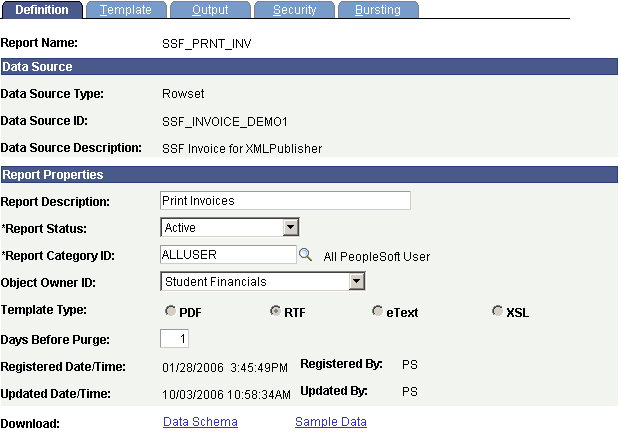

Access the Report Definition page (select Reporting Tools, then select XML Publisher, then select Setup, then select Report Definition).
Select the QA_CS_SF_RMD report (Invoice Reminder Letters).
Image: Report Definition page
This example illustrates the fields and controls on the Report Definition page. You can find definitions for the fields and controls later on this page.

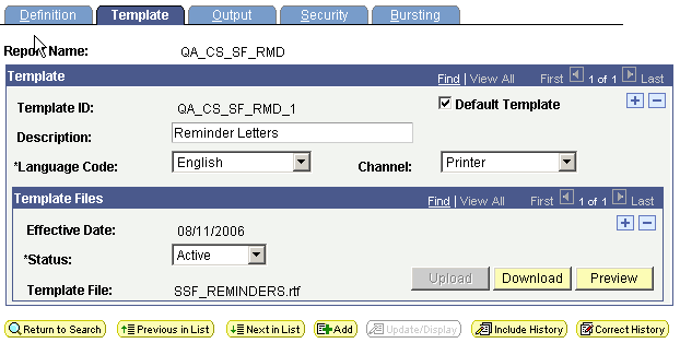

Access the Report Definition — Template page (select Reporting Tools, then select XML Publisher, then select Setup, then select Report Definition, then select Template).
Image: Report Definition — Template page
This example illustrates the fields and controls on the Report Definition — Template page. You can find definitions for the fields and controls later on this page.

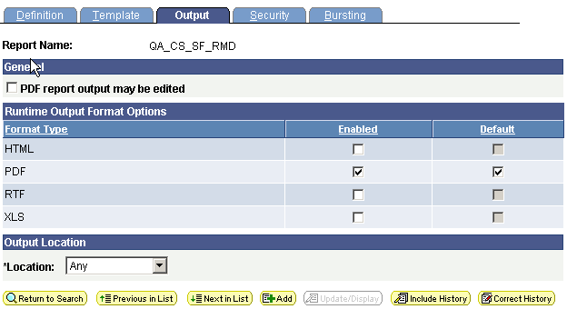

Access the Report Definition — Output page (select Reporting Tools, then select XML Publisher, then select Setup, then select Report Definition, then select Output).
Image: Report Definition — Output page
This example illustrates the fields and controls on the Report Definition — Output page. You can find definitions for the fields and controls later on this page.
For Format Type, select Enabled and Default for PDF.

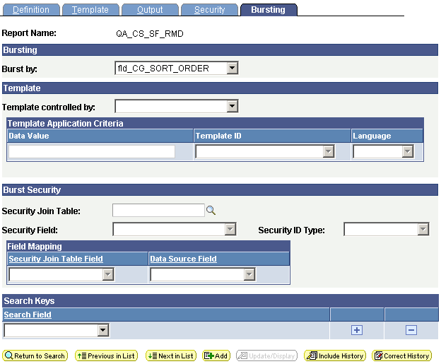

Access the Report Definition — Bursting page (select Reporting Tools, then select XML Publisher, then select Setup, then select Report Definition, then select Bursting).
Image: Report Definition — Bursting page
This example illustrates the fields and controls on the Report Definition — Bursting page. You can find definitions for the fields and controls later on this page.
For Burst by, select fld_CG_SORT_ORDER so the reminder letter is used by the Comm Gen process.

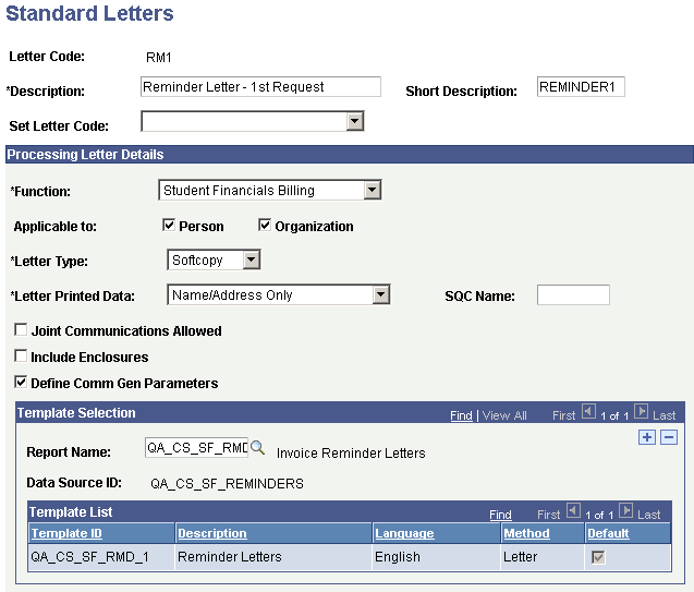

Access the Standard Letters page (select Campus Community, then select Communications, then select Set up Communications, then select Standard Letter Table CS).
Image: Standard Letters page
This example illustrates the fields and controls on the Standard Letters page. You can find definitions for the fields and controls later on this page.
Select the appropriate RM1 Letter Code and the Define Com Gen Parameters check box.
Template Selection
Select the QA_CS_SF_RMD report name (Invoice Reminder Letters).

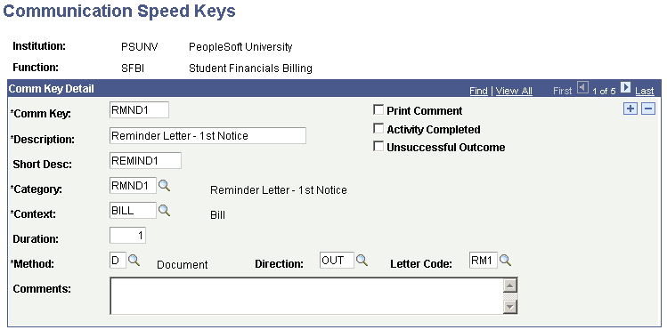

Access the Communication Speed Keys page (select Set Up SACR, then select Common Definitions, then select Communications, then select Communication Speed Key Table).
Image: Communication Speed Keys page
This example illustrates the fields and controls on the Communication Speed Keys page. You can find definitions for the fields and controls later on this page.
Select the appropriate RM1 Comm Key.
Field or Control
Definition
Comm Key:
Enter the name of the communication speed key to represent this set of communication elements
Category
Enter the communication category to associate with this communication speed key
Context
Enter the communication context to associate with this communication speed key.
Field or Control
Definition
Duration
Enter Document as method of the communication that you are associating with this communication speed key.
Direction
Enter Outgoing as the direction of the communication you are associating with this communication speed key.
Letter Code
Enter RM1 as the code you are associating with this communication speed key

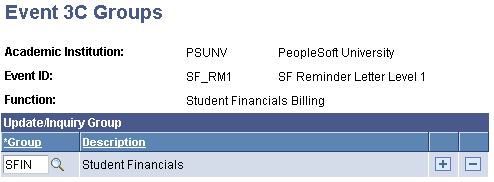

Access the Event 3C Groups page (select Campus Community, then select 3C Engine, then select Set Up 3C Engine, then select Event 3C Group).
Image: Event 3C Groups page
This example illustrates the fields and controls on the Event 3C Groups page. You can find definitions for the fields and controls later on this page.
Event 3C (Communications, Comments, and Checklists) Groups page

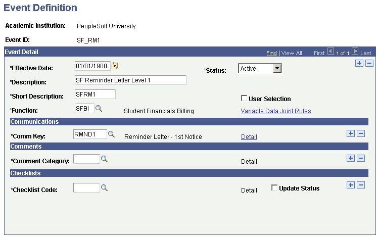

Access the Event Definition page (select Campus Community, then select 3C Engine, then select Set Up 3C Engine, then select Event Definition).
Image: Event Definition page
This example illustrates the fields and controls on the Event Definition page. You can find definitions for the fields and controls later on this page.
Select the appropriate SF RM1 Event ID.

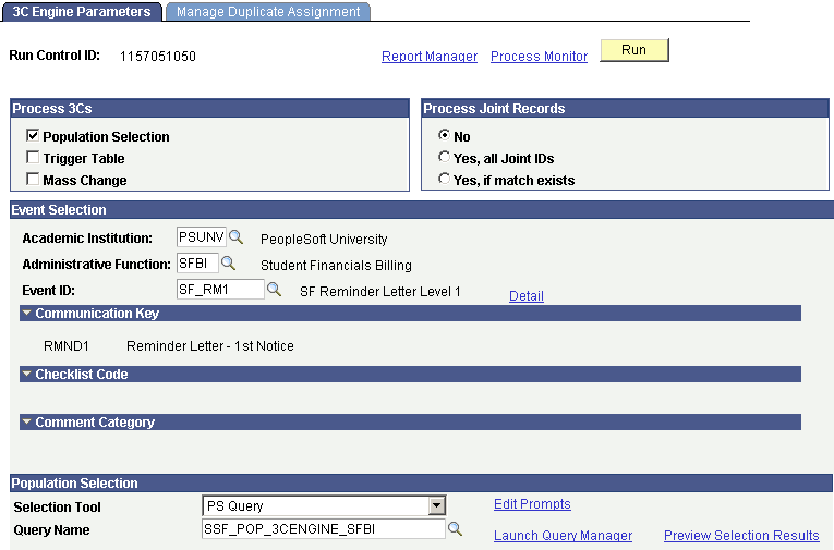

Access the 3C Engine Parameters page (select Campus Community, then select 3C Engine, then select Run 3C Engine).
Image: 3C Engine Parameters page
This example illustrates the fields and controls on the 3C Engine Parameters page. You can find definitions for the fields and controls later on this page.
3C (Communications, Comments, and Checklists) Engine Parameters page

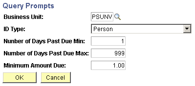

Select the SSF_POP_3CENGINE_SFBI query
In the Population Selection group box, select Edit Prompts to access the Query Prompts page.
Image: Query Prompts page.
This example illustrates the fields and controls on the Query Prompts page. You can find definitions for the fields and controls later on this page.
Query Prompts page.

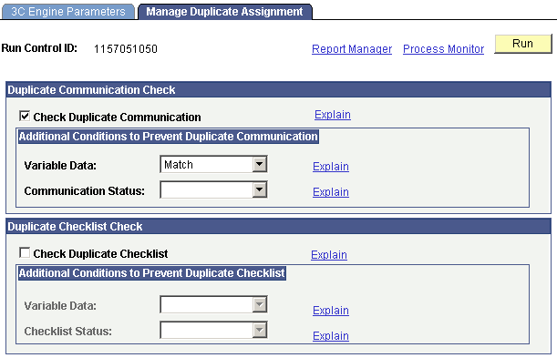

Access the Manage Duplicate Assignment page (select Campus Community, then select 3C Engine, then select Run 3C Engine, then select Manage Duplicate Assignment).
Image: Manage Duplicate Assignment page
This example illustrates the fields and controls on the Manage Duplicate Assignment page. You can find definitions for the fields and controls later on this page.
Check Duplicate Communication
Select the Check Duplicate Communication check box.
In the Variable Data field within the Additional Conditions to Prevent Duplicate Communication group box, select Match.
Click Run to run the process.

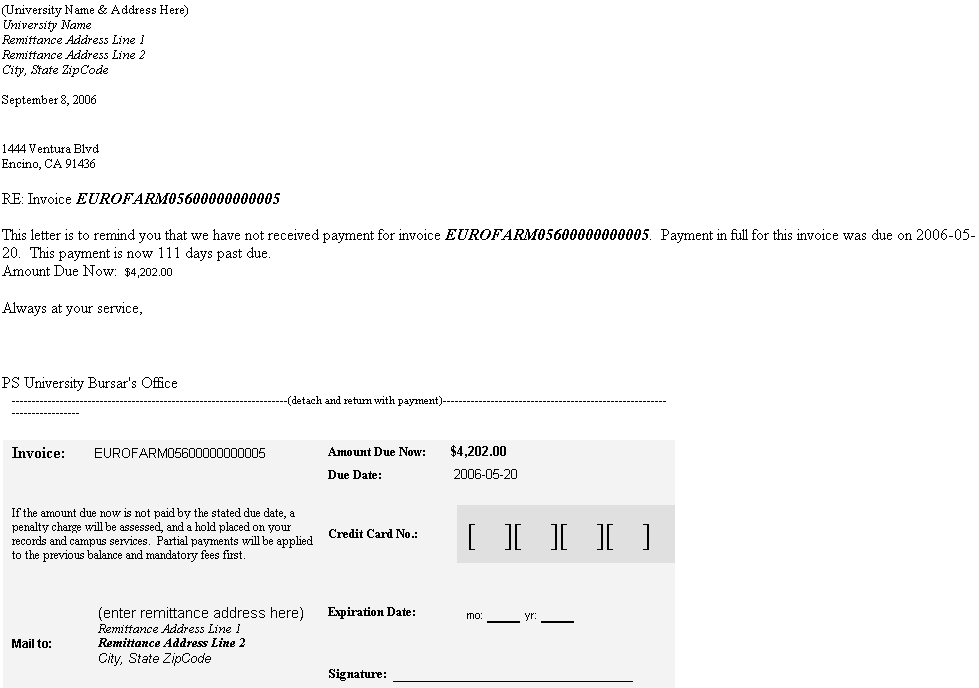

Click View Generated Communication to view the reminder letter.
Access the Reminder Letter for Global Invoicing.
Image: Reminder Letter for Global Invoicing
This example illustrates the fields and controls on the Reminder Letter for Global Invoicing. You can find definitions for the fields and controls later on this page.
