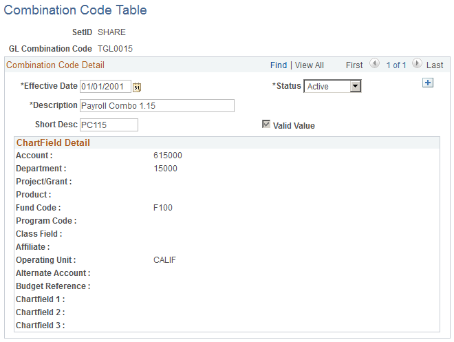

Access the Combination Code Table page (select Set Up Common Objects, then select Common Definitions, then select ChartField Configuration, then select Combination Code Table).
Image: Combination Code Table page
This example illustrates the fields and controls on the Combination Code Table page. You can find definitions for the fields and controls later on this page.
You cannot change the ChartField values for combination codes imported from Financials, but you can change the description and make it active or inactive.

GL Combination Code (general ledger combination code)
Enter this code on the CS pages to use this combination of ChartFields in a transaction.
The system generates the combination code sequentially based on the Last Combination Code Assigned field on the Installation table under these conditions:
  • ChartField combination is received from Financials by Integration Broker
  • GL combination code value is not supplied on the inbound flat file
  • You manually add the ChartField combination and do not pre-assign the GL combination code value
Valid Value
You can select this check box when you enter the ChartField combination for the first time for the setID. Select this check box if the ChartField combination is valid. If the combination already exists with the same setID, this check box is selected based on the value of the preexisting combination and cannot be edited.
ChartField Detail
If you are manually setting up combination codes, enter the ChartField value for each ChartField that applies to this ChartField combination.
Only the ChartFields that are active on the Standard ChartField Configuration page appear on this page
