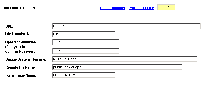

Access the Upload EPS Image File page (select Set Up SACR, then select Common Definitions, then select Forms Engine, then select Process, then select Upload EPS Image File).
Image: Upload EPS Image File page
This example illustrates the fields and controls on the Upload EPS Image File page. You can find definitions for the fields and controls later on this page.
Upload EPS (Encapsulated PostScript) Image File page
Enter the required information and run the process to upload the image to an FTP server.

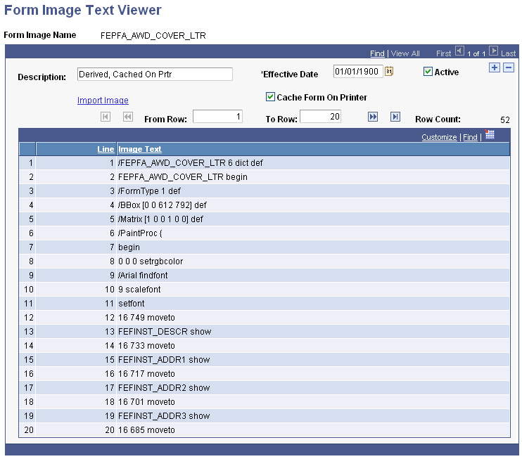

Access the Form Image Text Viewer page (select Set Up SACR, then select Common Definitions, then select Forms Engine, then select Setup, then select Form Image Text).
Image: Form Image Text Viewer page
This example illustrates the fields and controls on the Form Image Text Viewer page. You can find definitions for the fields and controls later on this page.
Field or Control
Definition
Description
Enter a description for the image.
Field or Control
Definition
Cache Form On Printer
Select if the image is cached. Clear if the image is noncached.
