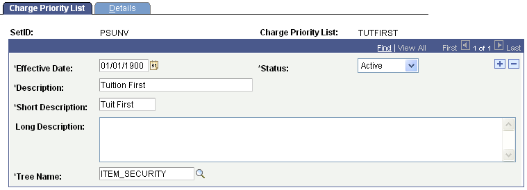

Access the Charge Priority List page (select Set Up SACR, then select Product Related, then select Student Financials, then select Charges and Payments, then select Charge Priority List).
Image: Charge Priority List page
This example illustrates the fields and controls on the Charge Priority List page. You can find definitions for the fields and controls later on this page.
Field or Control
Definition
Tree Name
Select the name of the item type tree that includes all item types to be paid under this charge priority list.

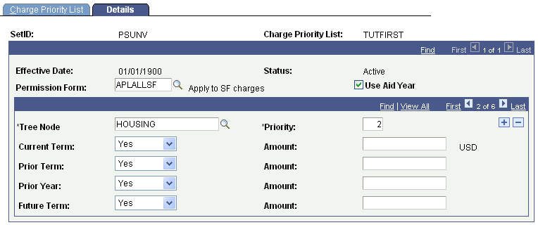

Access the Charge Priority List - Details page (select Set Up SACR, then select Product Related, then select Student Financials, then select Charges and Payments, then select Charge Priority List, then select Details).
Image: Charge Priority List - Details page
This example illustrates the fields and controls on the Charge Priority List - Details page. You can find definitions for the fields and controls later on this page.
Self service student permissions can be used for a student to grant permission.
Field or Control
Definition
Permission Form
Select a permission form if you want one to apply. A permission form is a type of advance permission that the system uses with item types that have payment application restrictions. When you select a permission form, the system applies the charge priority definition only if the permission form has been attached to the student.
Permission forms are commonly used with financial aid payment. For example, if a particular type of financial aid award restricts payments to the current term charges unless permission is given by the student to pay prior term charges, then a permission form can grant that permission. The permission form must be attached to the charge priority list definition that is set to Permission for the prior term.
Use Aid Year
Select to use the financial aid year for the charge priority list. When the flag is off (cleared), current functionality applies and the academic year is used.
Tree Node
Select allowable charges by entering the appropriate tree nodes. The system applies payments only to charge item types that fall in the range of the tree node.
Warning! You must not specify a parent and child node on a charge priority list. Doing this may cause unusual payment application issues because a charge will be selected twice: one from the parent and another from the child.
When you try to specify a parent and child node on a charge priority list, a message appears and tells you the charge priority list cannot be saved because of overlapping nodes. The message only appears for current and future-dated rows.
Warning! If you want to use the pay proportionate % tax functionality that is available in Payment Overall Priority setup (see the following field description), the tax item type must not be included within the range of allowable charges. If it is included within the range, the system treats it as any other eligible charge and it does not distinguish it as unique.
Priority
Assign a priority level for each tree node that is used to define allowable charges. The system uses this priority value only when you select Charge Tree Node as one of the Sort Payment Field values in your Payment Overall Priority setup. A priority of 1 is higher than a priority of 2.
Current Term
Select a value to control whether payments can be applied to charges for the current term. Four values are available for this field:
  • Yes: Select this value if you want the system to apply payments with no restrictions to charges in this time period.
  • No: Select this value if you do not want the system to apply payments to any charges in this time period.
  • Negative Permission: Select this value if you want the system to apply payments as necessary to charges in this time period, unless the student expressly prevents it. Student permissions can be used in conjunction with negative permission.
  • Positive Permission: Select this value if you want the system to require specific permission before applying payments to charges in this time period. Student permissions can be used in conjunction with permission needed.
Note: The definition of the Current Term value is determined by the value of the payment term. If no term is specified, the value of the payment term is determined by the Default Term Control value in the SF Business Unit component. Three options are available for default term control: Use SF Default Term, Use Last Enrollment Term, and Use Current Enrollment Term. When you use SF Default Term, the value of the payment term is the same as that of the SF default term. If you use either Last Enrollment Term or Current Enrollment Term as the default term control, the value of the payment term varies by the enrollment history of the student against whose account the payment is being applied.

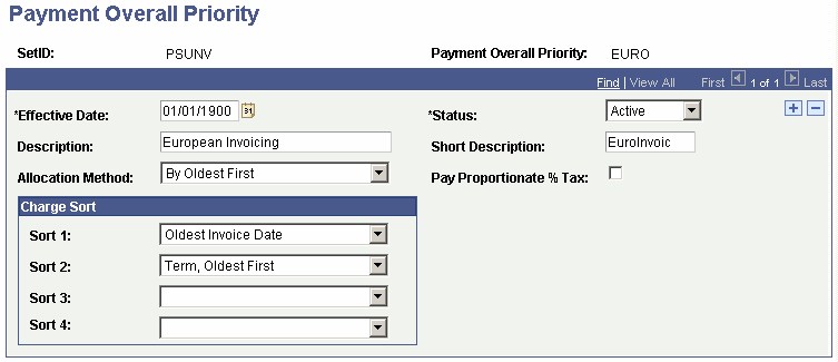

Access the Payment Overall Priority page (select Set Up SACR, then select Product Related, then select Student Financials, then select Charges and Payments, then select Payment Overall Priority).
Image: Payment Overall Priority page
This example illustrates the fields and controls on the Payment Overall Priority page. You can find definitions for the fields and controls later on this page.
Field or Control
Definition
Allocation Method
Select an allocation method:
By Oldest First: Select if you want to use sort payment fields to sort the eligible charges. If you select this option, the last sort is to order the eligible charges by the oldest item number first.
Equal Percentages: Select if you want to pay an equal portion of each eligible charge. If you elect to pay by equal percentages, the sort payment fields are not used.
Pay Proportionate % Tax
Select if you want all taxes associated with a particular charge to be paid proportionate to the payment against the charge. Payment of taxes follows the same payment priority as the associated charge.
Note: For pay proportionate % tax functionality to work, the tax item type cannot be included as an allowable charge in the charge priority setup. Make sure that the tax item type is not included within the range of any of the tree nodes that are selected as allowable charges.
Charge Sort
You can define up to four charge sort criteria. Remember that all sort rules defined for Payment Overall Priority apply only to charges already selected by the Charge Priority rules. For example, if your Charge Priority rules are set up to select charges for current and future terms only, and your Payment Overall Priority rules are set up to sort by Term, Oldest First, the term that is defined as current is the oldest term available.
Field or Control
Definition
Sort 1 Sort 2 Sort 3 and Sort 4
A number of possible values exist for each sort field:
Academic Year: Select to sort active charges by academic year, beginning with active charges from the earliest year.
Academic Year, Current First: Select to sort active charges by the academic year, using the current academic year first. After the system selects eligible charges for the current academic year, it sorts the remaining charges by academic year from the oldest to the most recent.
Charge Tree Node: Select to sort active charges by the priority value of the charge tree nodes that are established in the charge priority list definition being used.
Item Charge Due Date: Select to sort active charges by charge due date, beginning with the active charge with the earliest due date.
If restricting corporate payments for third-party contract functionality, do not use the Payment Overall Priority of sorting by Item Charge Due Date. For non-contract corporate payments, you can use the Payment Overall Priority of sorting by Item Charge Due Date.
Term, Current First: Select to sort active charges by term, using the current term first. You determine the definition of the current term using the Default Term Control field on the Posting Setup page of the SF Business Unit component. Therefore, it is not necessarily the chronological current term. After the system selects eligible charges for the current term, it sorts the remaining charges by term from the oldest to the most recent.
Term, Oldest First: Select to sort active charges by terms, using the oldest term first.
Term, Payment Term First: Select to sort active charges by terms, using the term for which the payment applies first. If no term is specified with the payment, the system uses the SF default term. After the system selects eligible charges for the payment term, it sorts the remaining charges by term from the oldest to the most recent.
Oldest Invoice Date: Select if you want the posting to gather the charges by invoice. This value is available only if the Apply Payments by Invoice flag is selected on the SF Installation setup.
