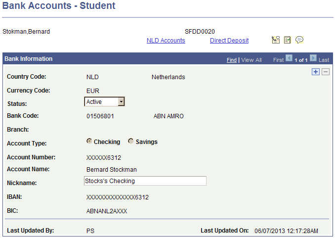

Image: Bank Accounts - Student page
This example illustrates the fields and controls on the Bank Accounts - Student page. You can find definitions for the fields and controls later on this page.

    For example, if you enter an IBAN value of NL51ABNA0401396312, the BIC Code becomes required. The BIC Code values that are available are all those for the country NLD, which are based on the IBAN value (the first 2 digits are always the country and the next 2 digits are always the IBAN check digit). You select a BIC Code of ABNANL2A (this is an available value because it is set up on the Branch Table in Common Objects). The Routing Number and Branch fields are populated and are view only—with the values 0150681 (BankID already set up for ABN Amro) and ABNANL2 (Branch ID) respectively. The Bank Name and Branch Name also appear.
