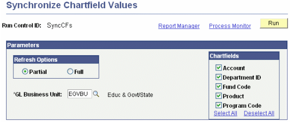

Access the Synchronize Chartfield Values page (select Setup SACR, then select Product Related, then select Student Financials, then select General Ledger Interface, then select Synchronize Chartfield Values, then select Synchronize Chartfield Values).
Image: Synchronize Chartfield Values page
This example illustrates the fields and controls on the Synchronize Chartfield Values page. You can find definitions for the fields and controls later on this page.
Note: To use this batch process, ensure that you have selected the Oracle Financials check box in the Financial System group box on the SF Installation page.
