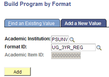

To build a program by format in Add mode:
  1. Add the program by selecting an Institution and Program Format.
    Image: Build Program by Format step 1 example page
    This example illustrates step 1 in the Build Program by Format (Add mode) process.
    Build Program by Format (Add mode) step 1

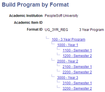

  2. The Program Format appears in a Tree view when the component opens:
    Image: Build Program by Format step 2 example page
    This example illustrates step 2 in the Build Program by Format (Add mode) process.
    Build Program by Format (Add mode) step 2
    Each node of the tree is a link/prompt for you to:
    Build a new academic item for the node or
    Associate an existing item with the node or
    Clone an existing item to create a new item for the node.
    You must assemble the program in accordance with the tree structure. Begin at the root (program) node. If you click any other link you receive a message instructing you to assign the item for the Parent node. The message returns the node ID that should be used (in this example it would be 100). This same message is returned if you skip a level in the tree. In this example if you assign the item for node 100, but then click the link for 1100, the error message instructs you to first assign the item for the parent (1000).

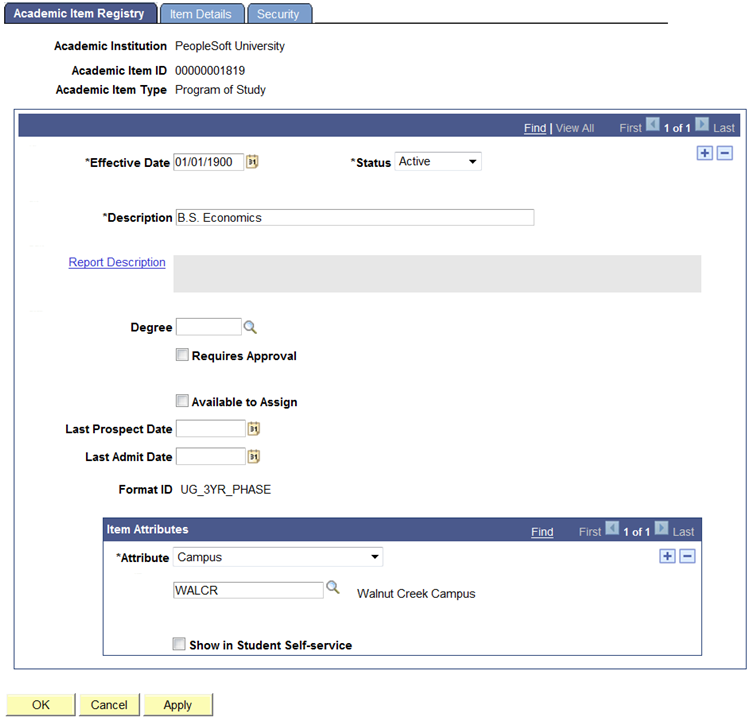

  3. Program (Node Academic Item Type = PRG):
    Click the link for the root node that represents the Program of Study: you are transferred to the AIR component where you create a new academic item for the Program node.
    Image: Academic Item Registry Program Node example page
    This example illustrates step 3 in the Build Program by Format (Add mode) process.
    Build Program by Format (Add mode) step 3
    The Institution and Academic Item Type (Program of Study) appear by default and cannot be changed. All of the features of the AIR component are available. You can:
    Save and return to the Build Program by Format page by clicking OK.
    Discard any changes and return by clicking Cancel.
    Save any changes and remain on the AIR component by clicking Apply.

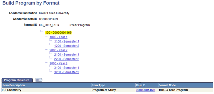

    When you click OK, the item is saved, an academic item ID is assigned, and you are returned to the Build Program by Format main page:
    Image: Build Program by Format (Add Mode) After AIR Save
    This example illustrates the Build Program by Format main page after you save the AIR component.
    Build Program by Format (Add mode) after AIR save
    The tree node where the item was assigned is highlighted and inactivated. The Program Structure tab opens and the academic item (and any child items) that was assigned to the node is listed.
    If updates are required, use the Item ID link to access the item.

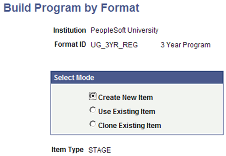

When you click the link for any other item type in the tree, you are transferred to the Build Program by Format - Select Mode (SSR_PRG_BLDR_SEL) page where you specify how you want to assign the item for this node. By default, the Item Type value is the item type of the node and cannot be changed.
Image: Build Program by Format (select mode) page
This example illustrates the fields and controls on the Build Program by Format (select mode) page. You can find definitions for the fields and controls later on this page.
Field or Control
Definition
Create New Item
When you select this option, you are transferred to the AIR component. Institution and Academic Item Type values appear by default and cannot be changed. After you create the item in AIR and click OK, you are returned to the Build Program by Format main page and the node is inserted in the program structure.

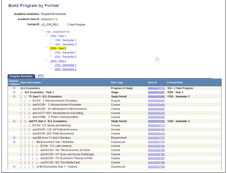

Using the Program Structure Tab
When academic items are assigned to the tree nodes, the program structure is tracked in the Program Structure tab on the Build Program by Format page. The display is updated as academic items are created/assigned to tree nodes. Rows are inserted for each assigned item as well as any child items entered for the item (or child items that were attached to an existing item).
Image: Build Program by Format page (Program Structure tab)
This example illustrates the fields and controls on the Build Program by Format page (Program Structure tab). You can find definitions for the fields and controls later on this page.

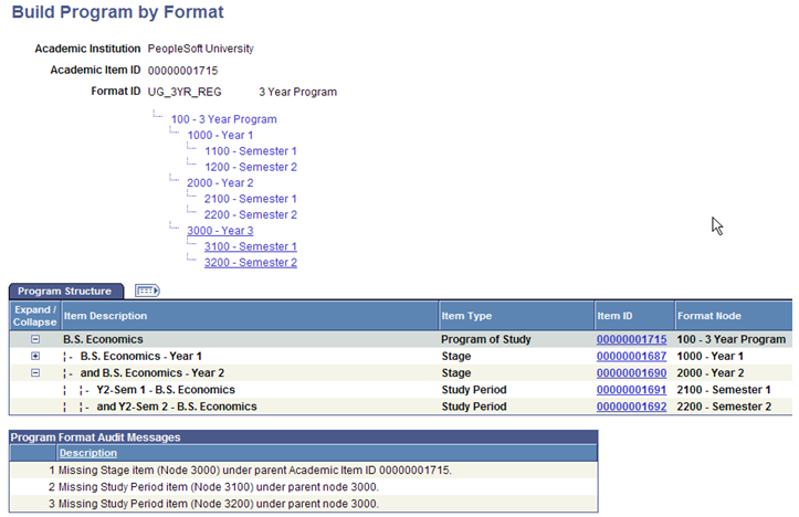

Viewing Program Format Audit Messages
Image: Build Program by Format page (Audit Messages)
When you retrieve a program, the Program Format audit is run and missing tree nodes (and missing child nodes) are identified and listed on the page in the Program Format Audit Messages grid:
The audit occurs each time that you retrieve a program using the Build Program by Format component—if a program is left unfinished, the audit messages appear the next time that a program is retrieved.
When an item has not been assigned to a node in a particular branch of a tree, a message is returned in the following format: Missing <Item Type Description> item (Node <Tree node ID of child>) under parent Academic Item ID <Academic Item ID assigned to the PRG node>.
In the example above an academic item has not been assigned for the tree node 3000 – Year 3:
Error message sequence 1 identifies the item type and the ID for the missing node, with a reference to the item ID of the parent program node.
Error messages 2 and 3 (for the missing study periods) refer to the parent only by the node ID, because an academic item has not been assigned.

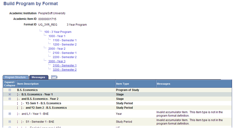

In addition to the program format audit messages, the Build Program by Format component also displays messages when an invalid Program Format Tree Node item has been inserted in a program tree. This could occur if you retrieved an item associated with a tree node in the Academic Item Registry component, because this action is prevented on the Build Program by Format component. The error is detected by the audit process and an error message is displayed on the Errors tab on the Build Program by Format page. When messages are present, the Errors tab appears as the Messages tab.
Field or Control
Definition
Messages
The message identifies the invalid node. This item type is not attached to a node in the tree branch.
